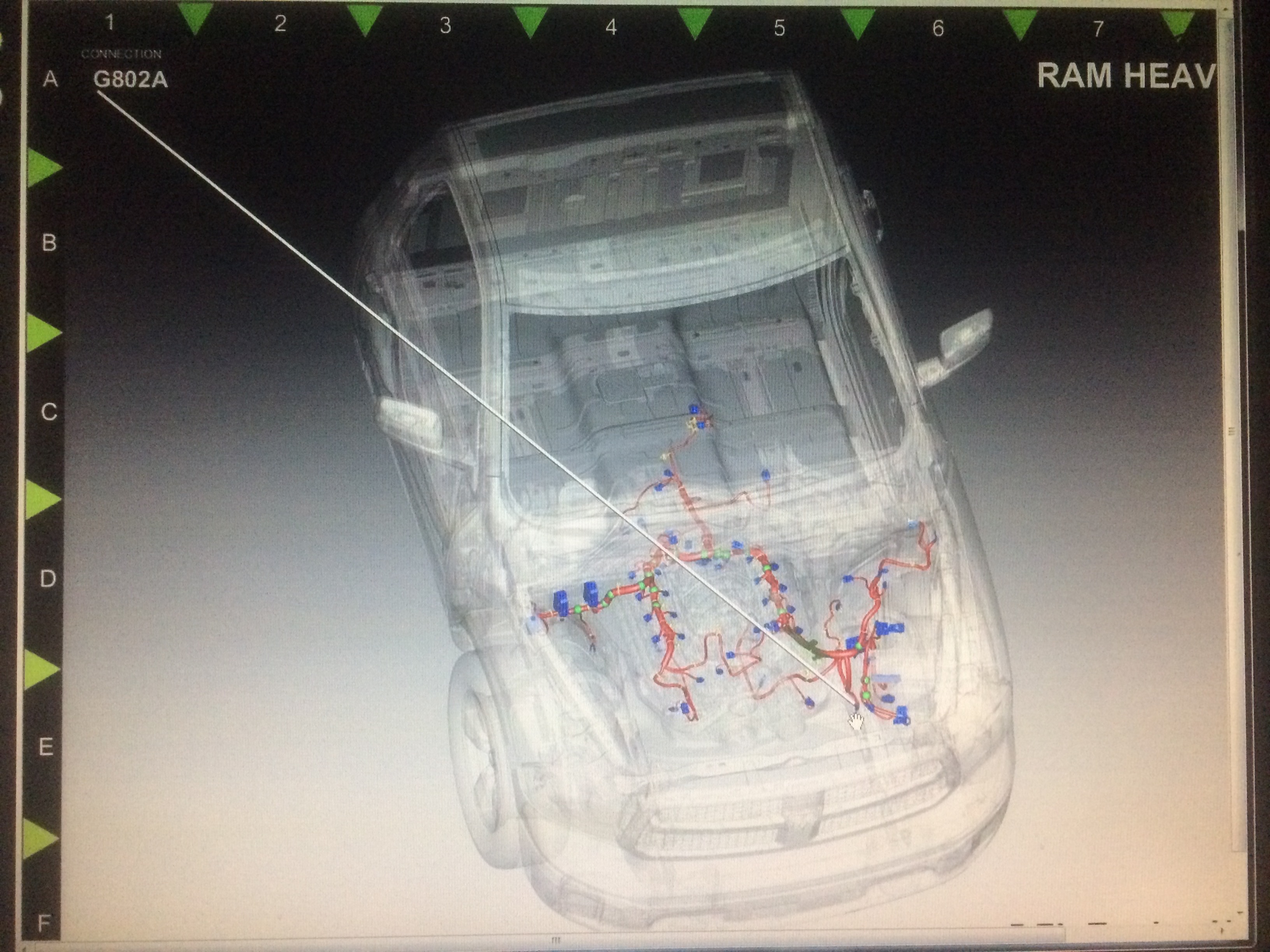

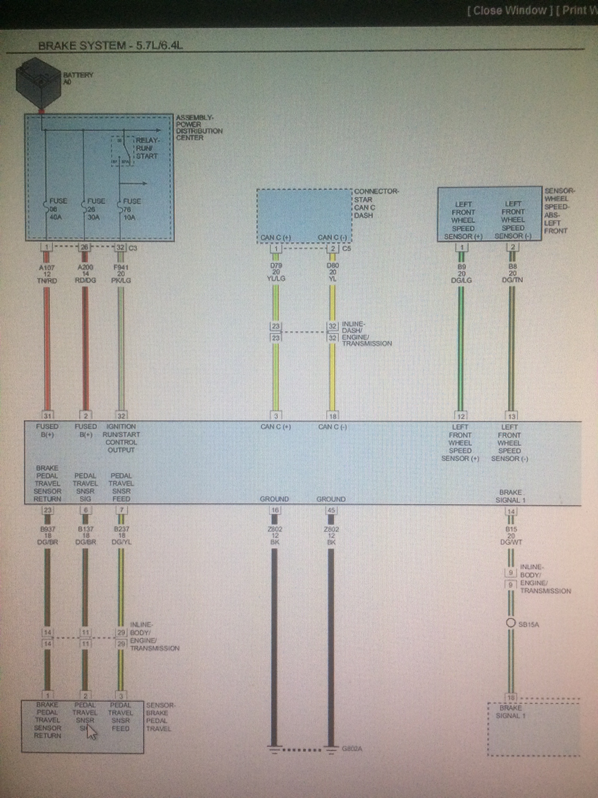

I snapped these pictures before I left work today. The newest schematic diagram I could find was for a 2015. It looks like the ABS ground wires are connection #G802A and it looks like it is located somewhere on the drivers side frame rail below the ABS unit or battery or fuse box.
Gee, I wonder what would happen if a guy interupted those ground wires? I wonder if a guy would have to push the start button twice to start the truck? I wonder if anything else shares that ground connection? I wonder if the ABS light would turn off by itself after it was reconnected?
Golly, if I only had a 15 or newer truck with a warranty, maybe I could figure it out. :popcorn:
Middle bottom of picture, two 12 Ga. black wires.

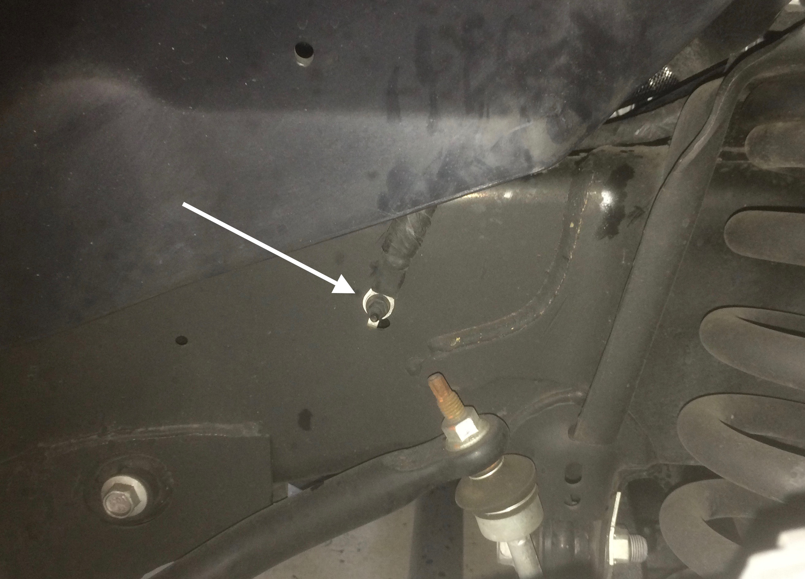

A 2016 CTD came in the shop yesterday and I had a brief moment to look at it. Not sure if it's the same location on the Hemi, left front outer frame rail, right above the sway bar end link.
I think this is the ABS ground.
Re: Kill-switch for electronic nannies
Post by olyelr » Fri May 26, 2017 6:41 am
My wagon has one there too. Actually two on that same spot. The taped up wires go right up into the main wiring by the fuse box.
