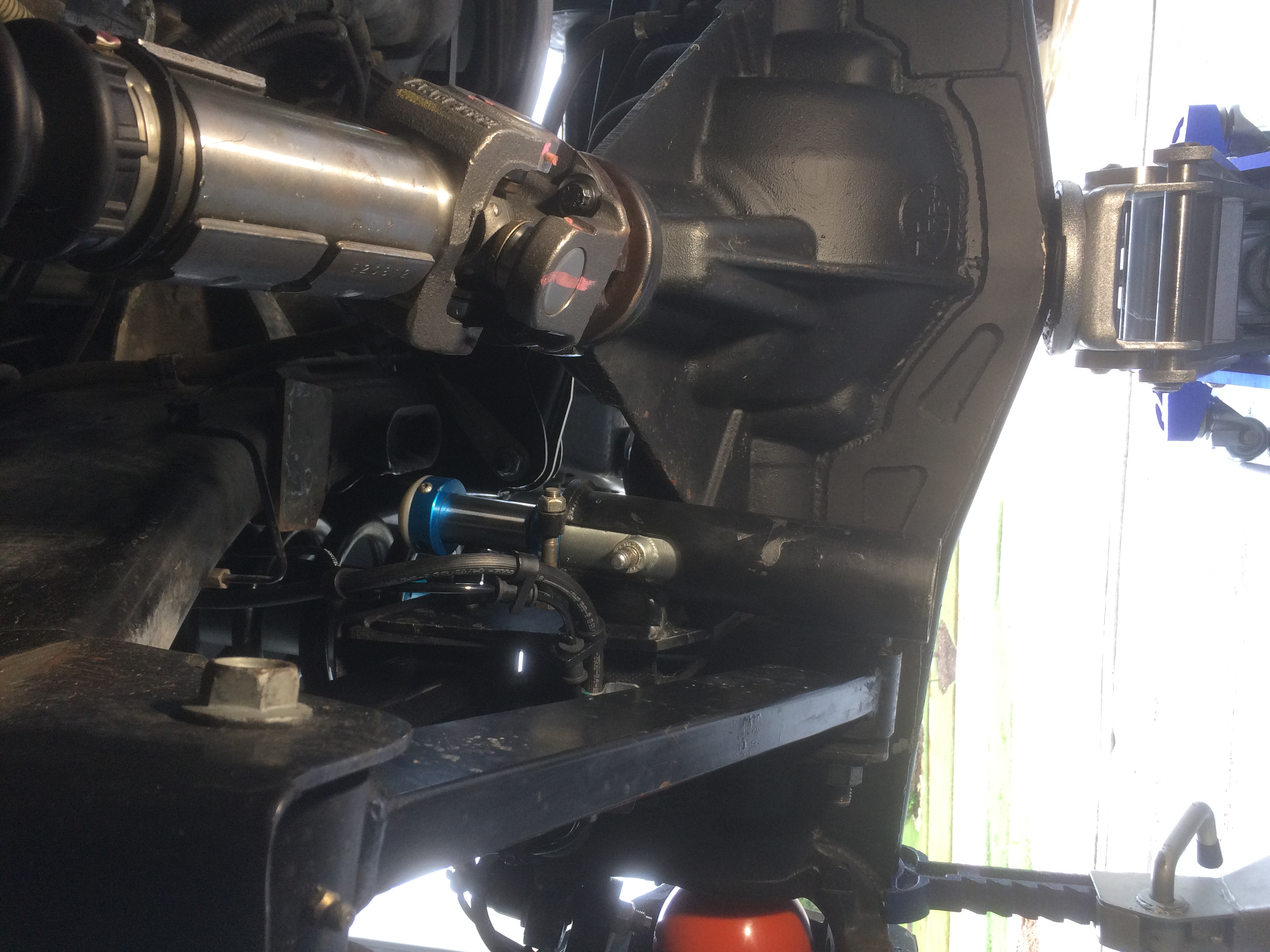

Got the front and rear driveshafts installed
Front oem but with arp 12pt hardware at the diff flange, I hate the recessed Allen head stripomatics the factory put on. Blue loctite and torque to 21 ft lbs. t case flange stock hardware torqued to 65 ft lbs.
Rear shaft from driveshaft specialists out of San Antonio. Super nice and knowledgeable people that do a metric shit ton of dodge truck shafts. 5" seamless Alcoa .125 wall and 1410 spicer cold forged joints. The weld yokes on the new tube dwarf the factory stuff. This shaft is rated for over 7000 ft lbs of torque lol. A few thousand more than any factory shaft apparently. Use NEW factory hardware and torque to 85 ft lbs. going to have to modify and clearance the last skid crossmember to allow for full droop with the bigger shaft.

That's beefy. How much is the beefed up rear shaft run you? Require anything special or alterations to fit ?
Re: Boogie wagon take 2
Any clearance issues with the additional diameter rear shaft?
The rear shaft ran around 700 shipped, they have different tubing options that cost less though as well as the option for 1480 and 1550 series u joints if you're putting big power down.
At full droop the larger shaft just touches the skid plate crossmember so I'll have to clearance for that, otherwise it's plug and play. I've been considering doing an aluminum center skid anyway so I might use this as an excuse lol. If you don't have a lift it would probably work just fine without doing anything I suspect.

I think they missed a spot on that front shaft. Why so many damn balancing weights on it? I didn't notice it the first time but it caught my eye this time under the truck.
I saw that too. I'm guessing concentric issues in the tube if it's a welded seam tube. Not a big deal. Weights won't hurt a thing. Balance is most important. You should see how bad some of the stock shafts are for balance.Will wrote:I think they missed a spot on that front shaft. Why so many damn balancing weights on it? I didn't notice it the first time but it caught my eye this time under the truck.

Had to look at his shaft twice...just admiring it...right?Will wrote:I think they missed a spot on that front shaft. Why so many damn balancing weights on it? I didn't notice it the first time but it caught my eye this time under the truck.
Thanks guys!
the front shaft does have a shit ton of weights but I'm not worried unless it has a vibe. And it is seamed steel tubing.
It's a creative fab truss nova, they're a shop in California that has done enough dodge front trusses that they have a Blanchard ground fixturing jig and chromoly inner tube brace. It's backbone is a 3/8" wall 1.75" preloaded tube with multiple layers of plating in different areas. Knuckle gussets are 3/8" steel plate.
