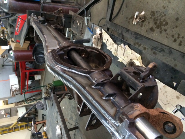

It's a creative fab truss nova, they're a shop in California that has done enough dodge front trusses that they have a Blanchard ground fixturing jig and chromoly inner tube brace. It's backbone is a 3/8" wall 1.75" preloaded tube with multiple layers of plating in different areas. Knuckle gussets are 3/8" steel plate.
