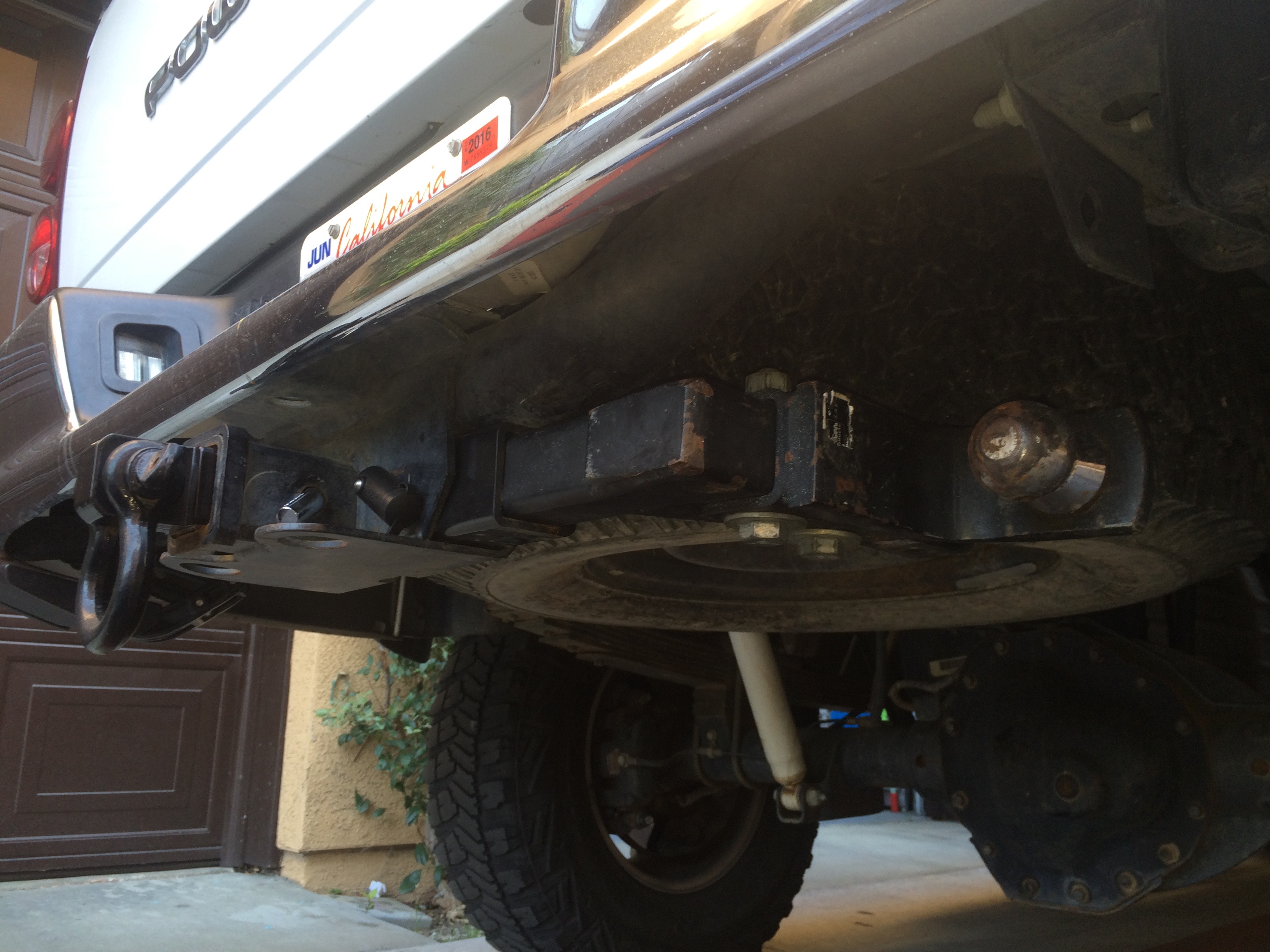

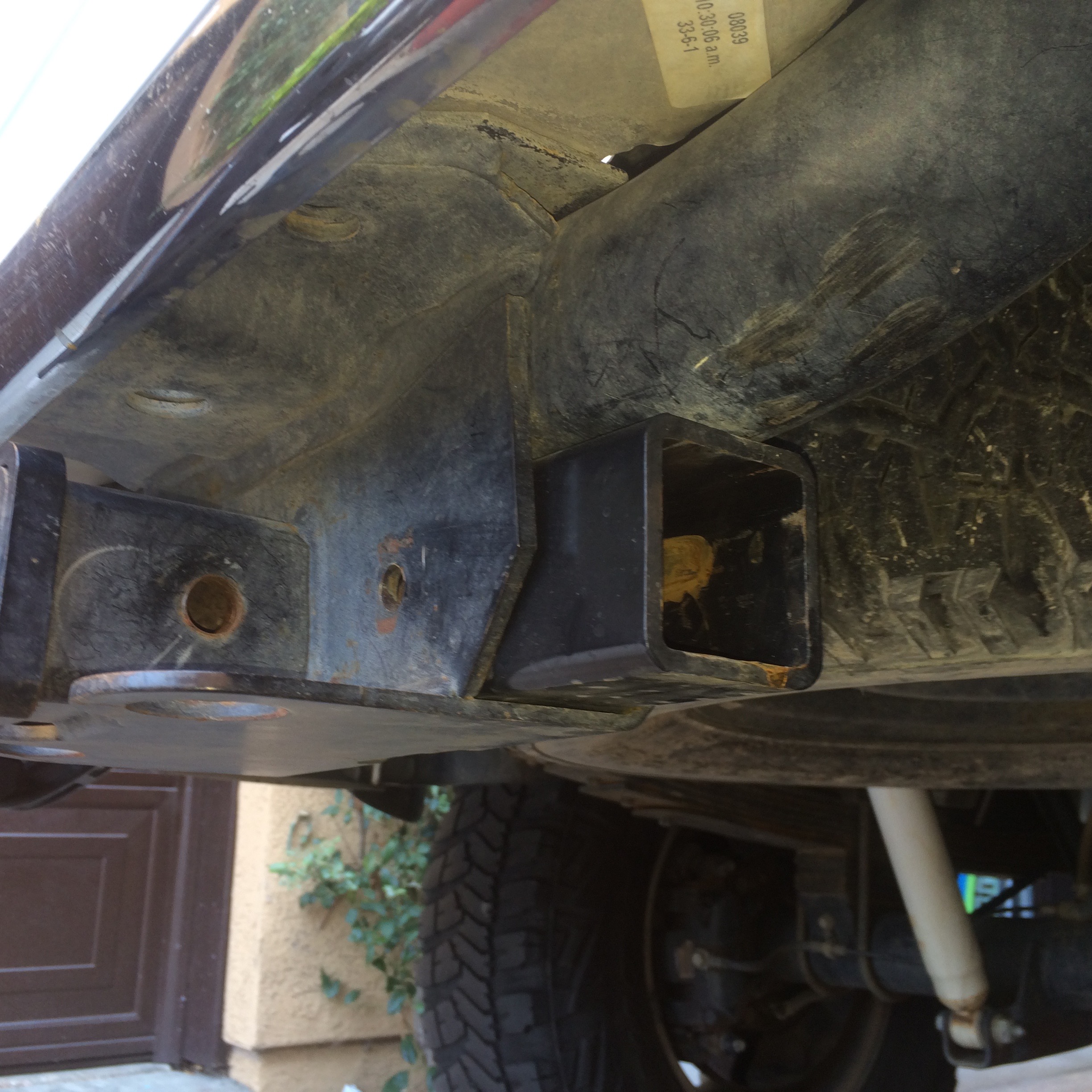

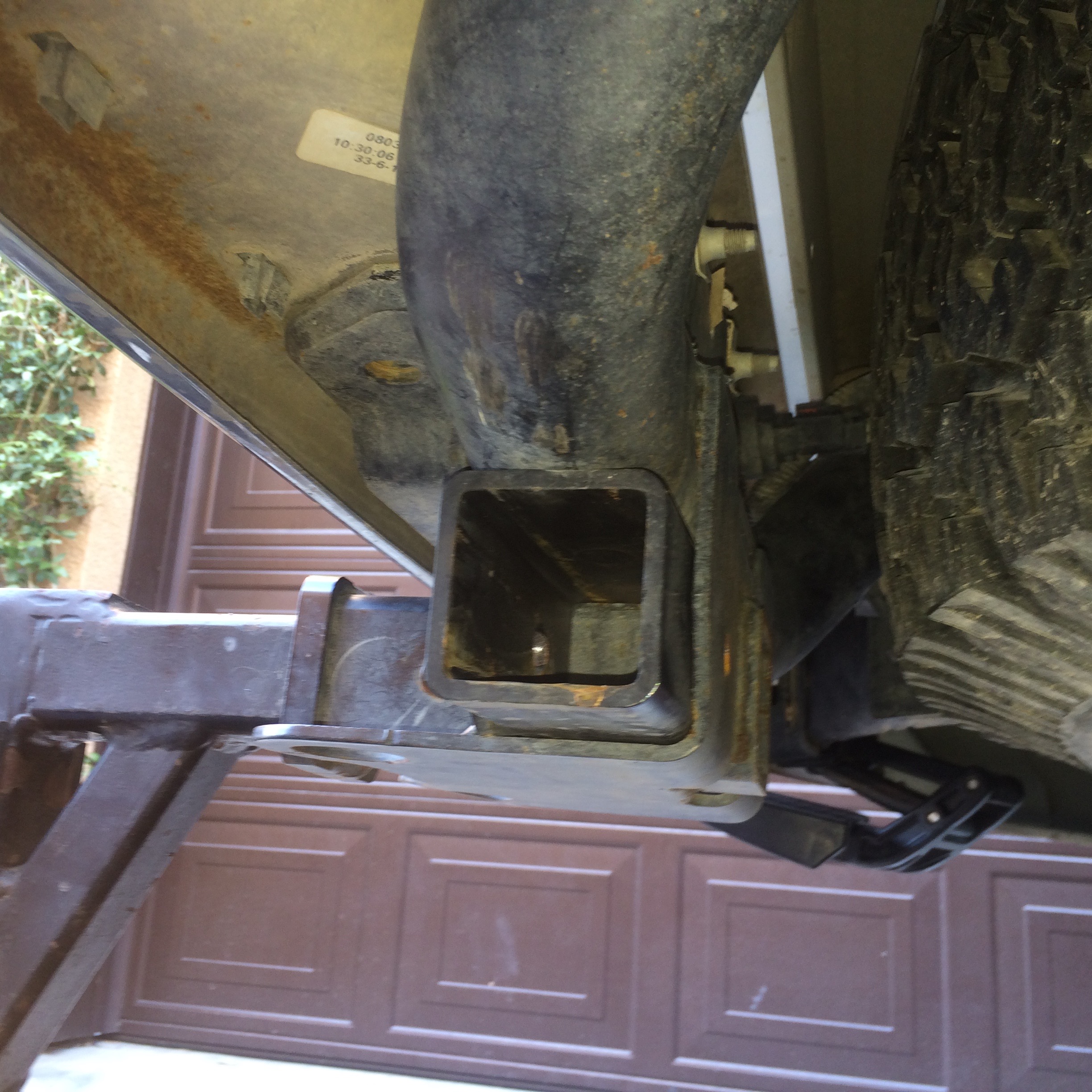

I started thinking about the possibility of storing it under the truck somewhere so it would be completely out of the way but easy to access.
After spending way too much time thinking and looking, this is what I came up with.
My truck has a 2" receiver, so I went to Walmart and bought a Reese 2-1/2" to 2" reducer sleeve (#7028711) for $11.48
Reese Adapter.jpg (10.89 KiB) Viewed 8969 times
Then I installed it here on my factory receiver.
I had to beat it into place with a dead blow hammer. That sucker is in there so tight, it ain't never coming out without a blue tip wrench. It's not loose and it doesn't rattle.
Next I had to drill thru the entire assembly including my ball mount so everything would line up. I decided to drill it the same size as the hole that was already in the receiver, but I probably could have gone with a smaller 1/4" hole.
I purchased a Master Lock keyed alike trailer pin set and I put a piece of clear plastic hose over the small pin to stop any rattling and compensate for the difference in size.
It droops a tiny bit, but it's out of my way and easy to get to. The average person won't even notice that it's under there and I don't think it will hinder my departure angle.
I don't think this has weakened my hitch system any because there was already a hole in the factory receiver and the hole I drilled in the ball mount is behind the standard pin hole and on a different plane. So far I'm happy with it!
