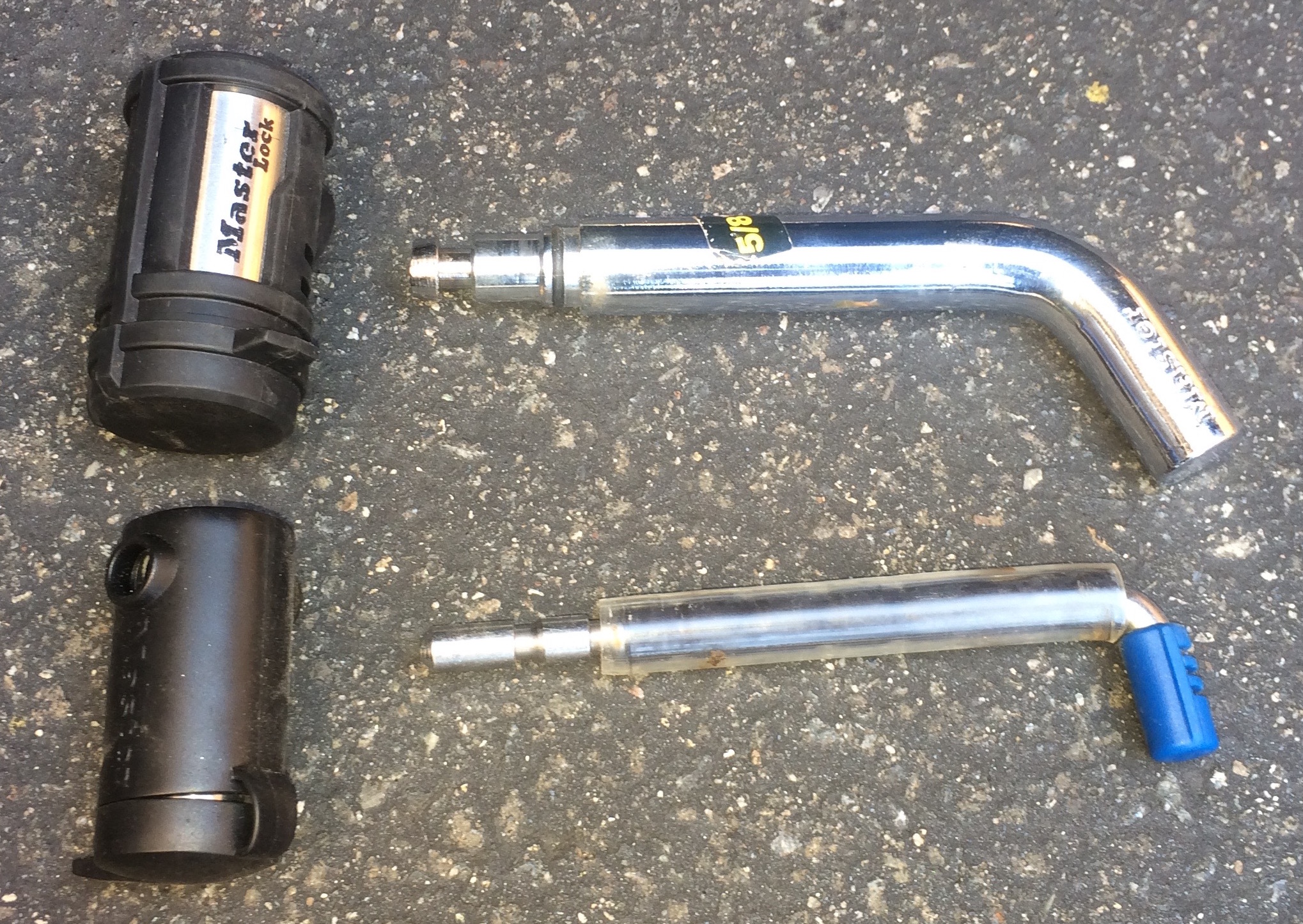

I purchased a Master Lock keyed alike trailer pin set and I put a piece of clear plastic hose over the small pin to stop any rattling and compensate for the difference in size.

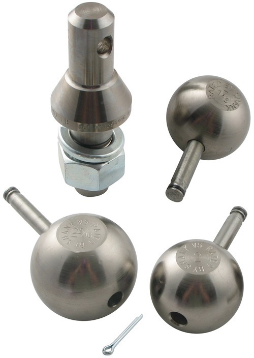

I use a "Convert-A-Ball" for quick easy changes with only one mount. It has a 10,000 lb. GTW rating.
In my youth, driving tow truck, this is what we used to be able to move any trailer at a moments notice.

2" and 2 5/16", costly, but very nice to have

I have one similar to this but it was only $80 or so. They have fancy stainless ones that are over $300! I would love to do this type of a mod but it would be rusted in place the first year it would be up there with all the salt on the roads.Stickman wrote:2" and 2 5/16", costly, but very nice to have

I used one of these on my mini van years ago. After the first two years, the rubber seals must have gotten sliced and it would take a few minutes to switch the balls. I swap tongues in about 10 seconds. And the convert-a-ball isn't rated high enough for my PowerWagon and trailer.Retired BLM Rig wrote:I use a "Convert-A-Ball" for quick easy changes with only one mount. It has a 10,000 lb. GTW rating.

Don't get me wrong, I do like the new adjustable hitch inserts (as shown above), unfortunately they weren't available 25 years ago when I bought mine. I do like the new ones with the built in tongue weight scale, I may need to upgrade.
