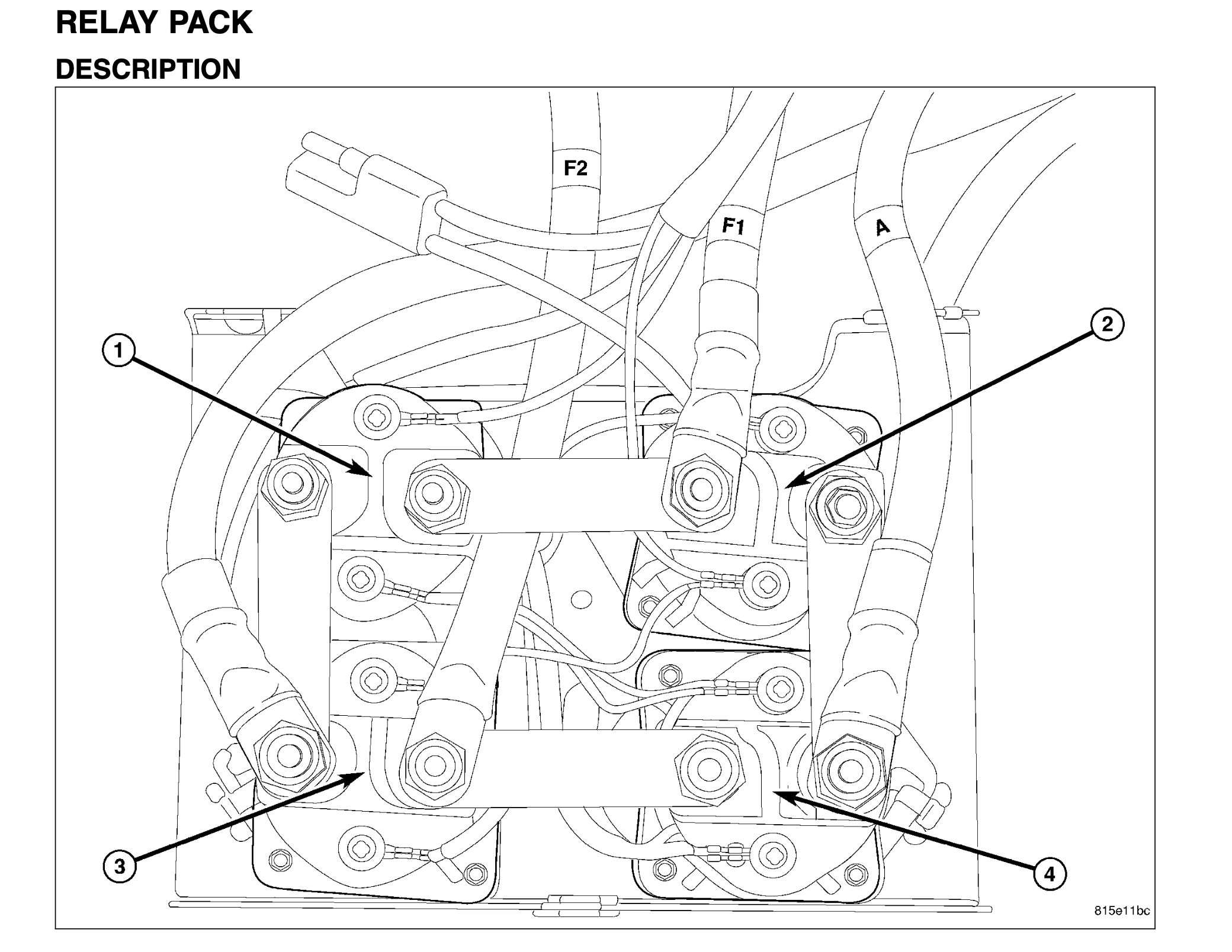

First I know where the ground goes but which solenoid does the battery +cable go to?
Second I understand the one cable gets wired out of the LVI circuit. Is it the red wire that's going to the controller that's supposed to go directly to the ground?

Based on this picture from page #29 of the manual, it looks like you're missing a bus bar between solenoid #1 & #3 and the positive battery cable is supposed to connect to the outer terminal of solenoid #3.

I have that bus bar, I was taking everything apart and cleaning the connections at the time. That's the info I needed though, I appreciate it.
