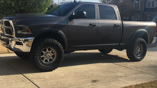

Finally wore the Nitto Trail Grap MT's out and went back to my favorite tire the Toyo MT... Not many miles yet but already loving them... I know some guys love the Nittos but I did not have good luck with them at all... They wore out in about 20K miles and, to me, rode like crap... Still playing with pressures on the Toyo's but much smoother already... Happy Wagon owner! :cheers:

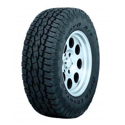

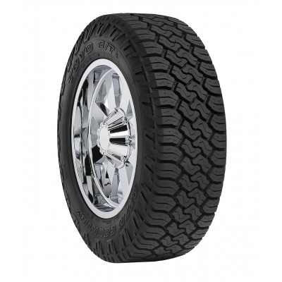

Anyone seen or tried the Toyo Open Country C/T? In the market for some new shoes and trying to decide between these and the Toyo AT2 Extremes. I think it's time for new ball joints too. Cooper STT's are cupping like crazy at around 40k. Think I'm done with mud tires. The old PW and me don't really like the mud all that much anymore anyway! :wink:
AT2 Extreme
C/T
Re: Tire Feedback
Post by Colibri » Fri May 19, 2017 4:37 pm
Haven't tried the Ct but the rt's on my van are pretty damn good. Very impressed with the traction on and off road and they ride smooth and quiet. It's hard to go wrong with toyo. If you try them please let us know what you think
Re: Tire Feedback
Post by DamageWagon » Sat May 20, 2017 12:19 am
Never heard of anyone running the CT (in sure tons of people do, just never met anyone or seen on the forums). If their sidewalk construction is anything like their MT they would be almost unkillable. I'm still amazed at these tires, they just won't die. Best of luck!

tried to price them (ct)..here in n.j....back in october..only sold in canada..so I got nitto exo they also have snowflake stamp
GunniPWguy
Posts: 954
Re: Tire Feedback
Post by GunniPWguy » Mon May 22, 2017 1:22 pm
Saw the CT's on a truck here. They look pretty nice. Almost exactly Like Mickey Thompson Baja ATZ's. Been there, done that. Local tire shop has them in stock but I decided to go with the AT2's because of their track record and price. Having them installed this Thurs for $1,267 out the door and free rotations. :D
Re: Tire Feedback
Post by OffroadTreks » Mon May 22, 2017 1:36 pm
The TOYO AT2 is a great tire. And the sidewalls are excellent. You will be very happy with the decision.
