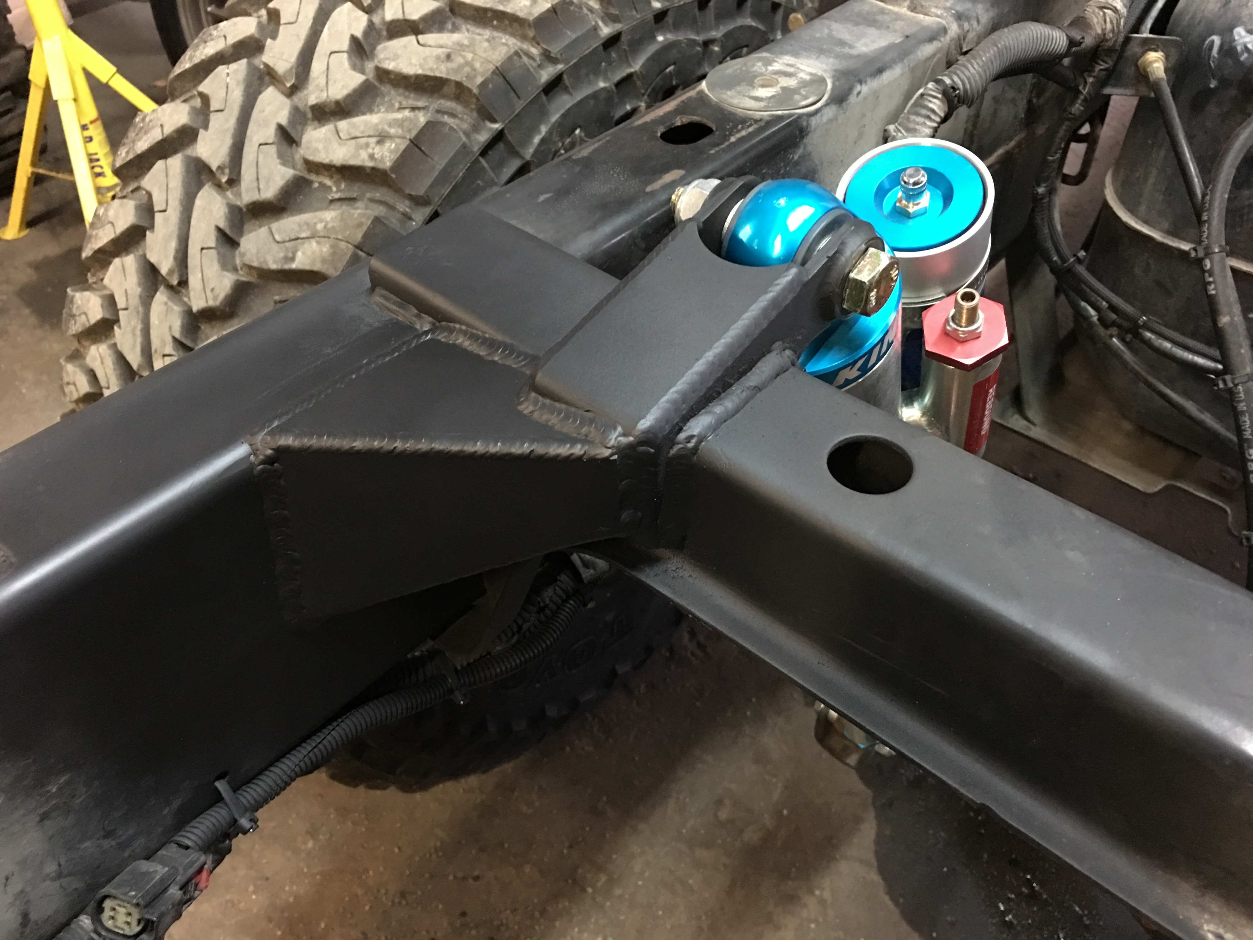

And the 3" 4 tube bypasses are on now with the Carli upper shock mounts with some extra gussets on the driver side mount/crossmember
