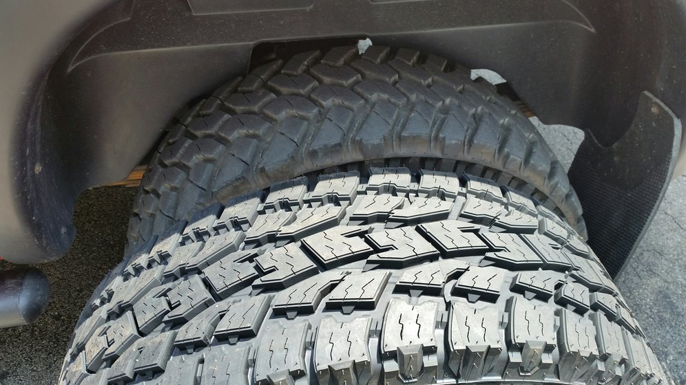

**EDIT, tires came in, went with 305-70-17, quick pic next to half worn 295-70 nitto trail grapplers still on the truck.
The online pictures do these tires no justice at all, I just hope they are not mud bogger loud like the TG's are now.
