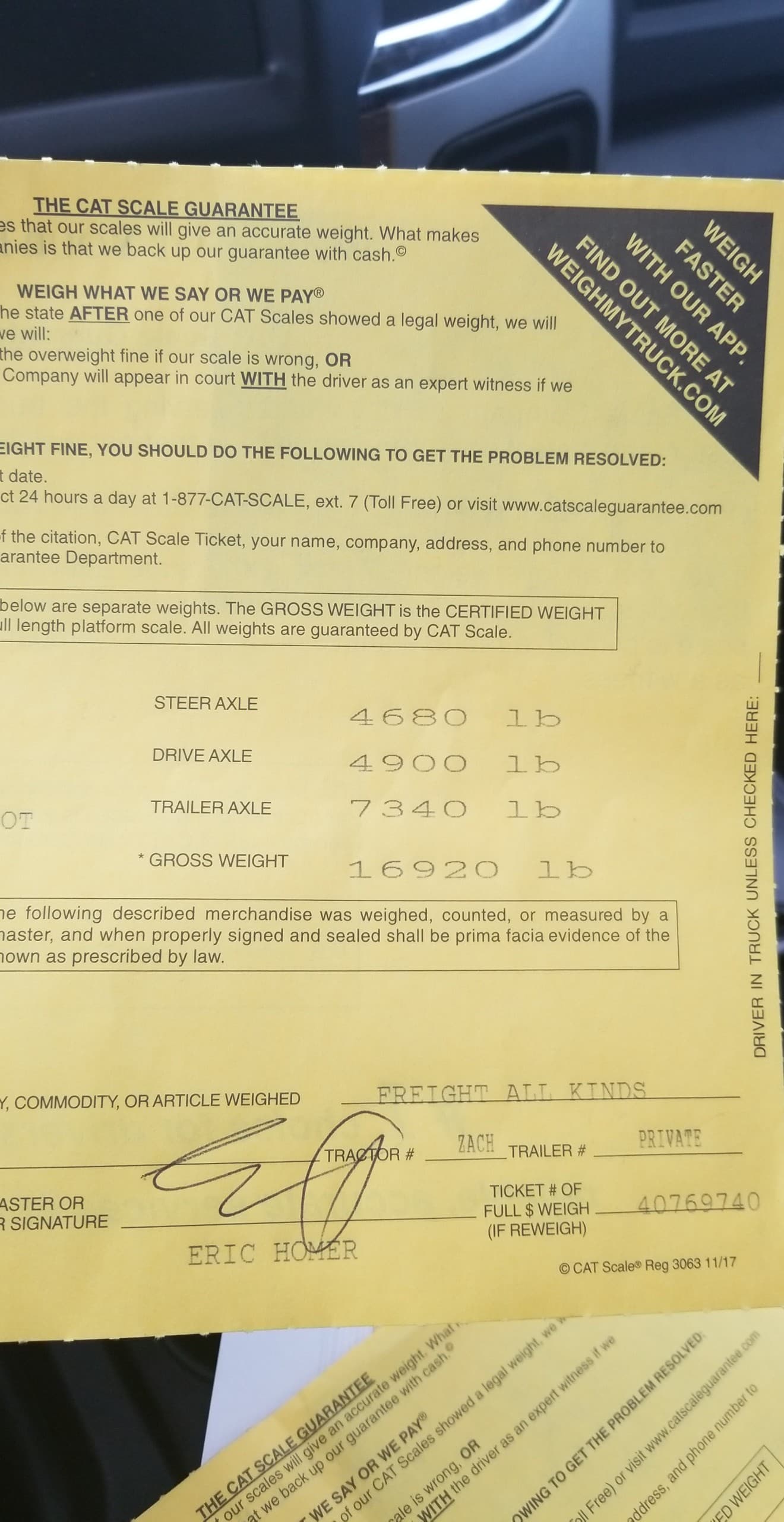

I realize this thread is old but... was doing some searching...
i have a 2017 pw. I pull a NASH 17K travel trailer, max weight on the trailer is 6995lbs. I live at high altitude and pull my camper frequently. (we travel full time, i work remotely)
I stopped by the CAT Scales the other day...
steer axle weighted in at 4380lbs (max 4750)
drive axle 4920 (max 6200)
trailer axle 5760 (max 6995)
total: 15060
GVWR (according to my door) is 8510lbs, so that puts me 790lbs over weight. Even though I'm underweight on axle rating and underweight on the gross combined weight, (which i think is somewhere around 17000 lbs). So underweight, technically, but over weight for gvwr... or cargo... lame.
I added the firestone airbags with the day star cradle.
At a minimum i have to keep 5 lbs of air in the bags, as per owners manual for the bags.
The rear sits about 3/4" higher than it did with stock, with no load and 5lbs of air.
With a fully loaded truck and trailer, I load springs to 25lbs of air, and this brings my rear height to about .5" lower than the stock right height (before adding bags - so i'm allowing it to sag some.)
The airbags have solved the rear end sagging issue. The truck seems to handle the weight fine. it does struggle on steep grades at high altitude, but that is to be expected. I do hate being overweight, from a legal issue, but the truck seems fine. I've thought about swapping to a normal 2500 or 3500 with a cummins but, i really think my truck is fine with the current setup. Please let me know if anyone thinks my truck is 'overloaded' and dangerous re: mechanical failure - i do realize the legal issue of being over weight and that is a risk i am willing to take.
