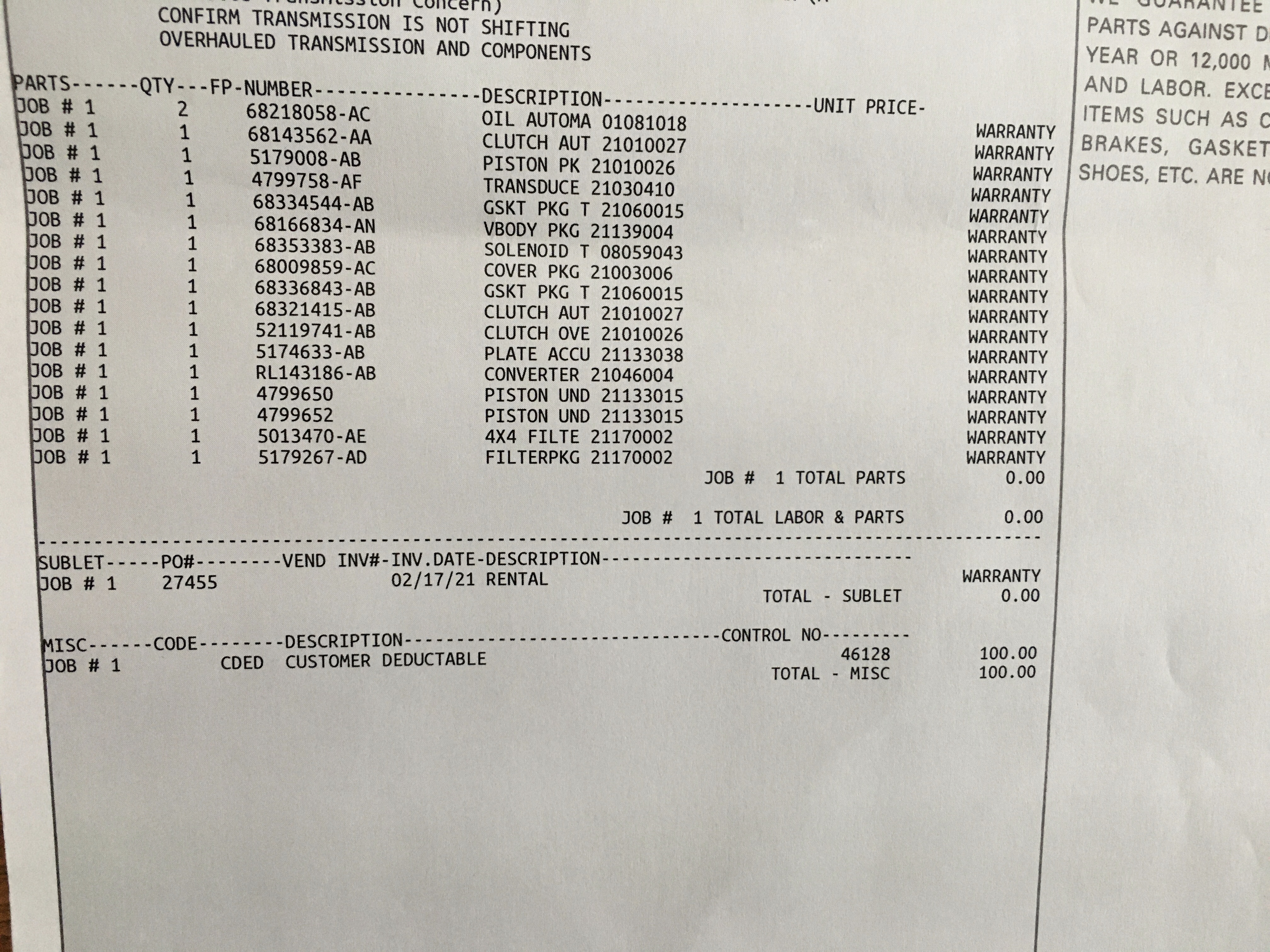

The PW is back home ... just a quick test drive home but she's driving great the guy at the transmission shop went thru that that old one at replaced a long list of parts. Not sure the pic I posted will show up with all the parts. I may have to go give that guy a a gift card for the BBQ joint in his neighborhood.
37 days $1200 in rental $140 in diagnostic, $100 in deductible, ... My max care plan will cover up to $35 a day on rental so I will get a big chunk if not all that back...
