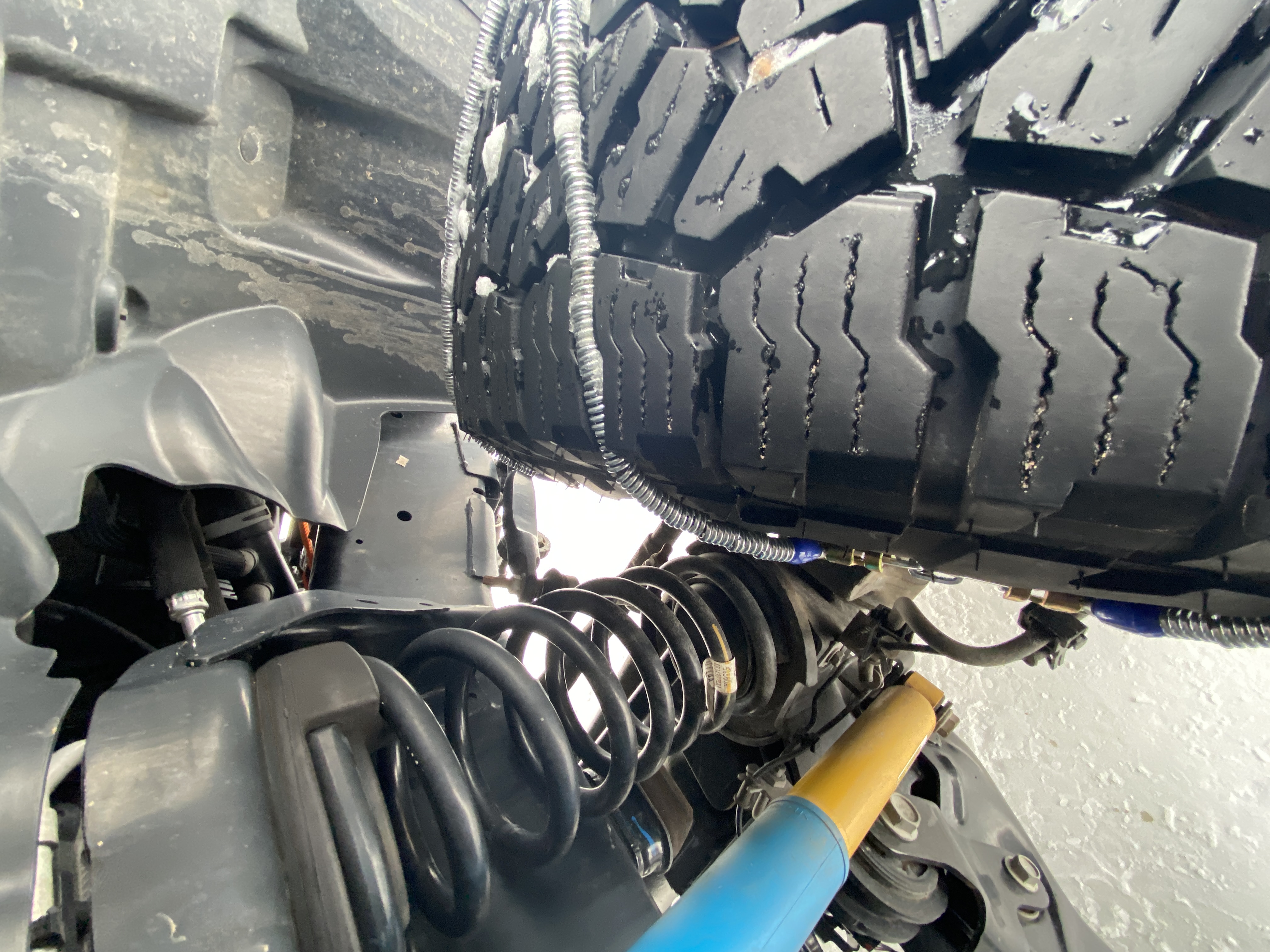

Just wanted to follow up on this post. I ended up getting cables for the front, from tirechainsonline.com (# 761C - for 315/70r17 tires)
Put like 20 hard* miles on them, no issues. Other than a few scrapes on the outside cable clips from rocks
*About half of this was high clearance Forest Service 4x4 road with a frozen creek crossing or two, and big rocks popping up thru the snow. The other half was semi-maintained dirt road, but covered in snow pack. There were a couple miles where there was no snowpack remaining and I was driving on dirt.
I made certain to keep the sway bar engaged and limit my steering... but I didn’t notice any scrapes inside my wheel wells afterwards
