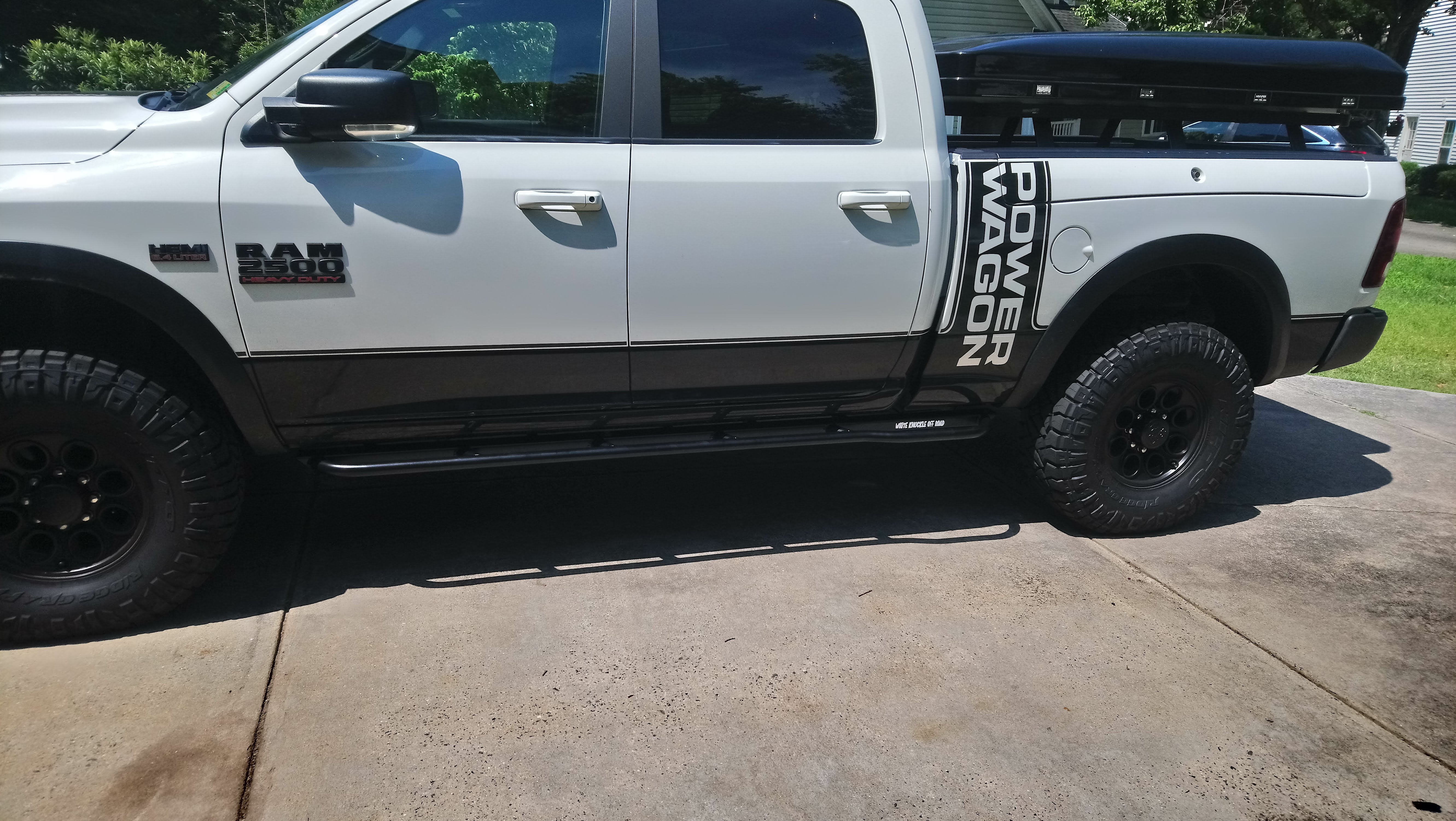

Got the White Knuckle Rock Sliders installed a couple weeks ago.  Notes on the install:
-Had to grind down the shim on the driver side due to an errant ground clip that was in the way. Ground clip probably could've been moved, but the grinder was handy and I prefer to leave as much stock as possible.
-Move of the frame rail wiring that had to be liberated from the frame has mounts close enough to the slider mount points that no re-securing was needed
-On the passenger side, one of the brackets is making contact with the body, causing a OCD-triggering episode. Probably due to an installation error, but it should be resolvable by loosening the one mount and shimming it away from the body with some plastic shims
-The extra ~300lbs. slightly affects stopping power. After the tent, rack, and bigger tires, I'll probably upgrade the brake pads with Power Stops or EBC Yellow Stuffs

Re: Torq's Build - 2017 RAM Power Wagon (Nickname Undecided)
I had the same passenger side ocd squeak as well. Ended up being a washer rubbing on the body. Took the bolt out, ground down a flat spot on the washer, and reinstalled so the flat spot was now pointing toward the body. Noise be gone.
Awesome. I'll try that and report back on how it works. It's bugging the shit out of me.
Yea, the first thing to do really is closely inspect all of the mounting bolts to determine which one is actually rubbing on the body.
