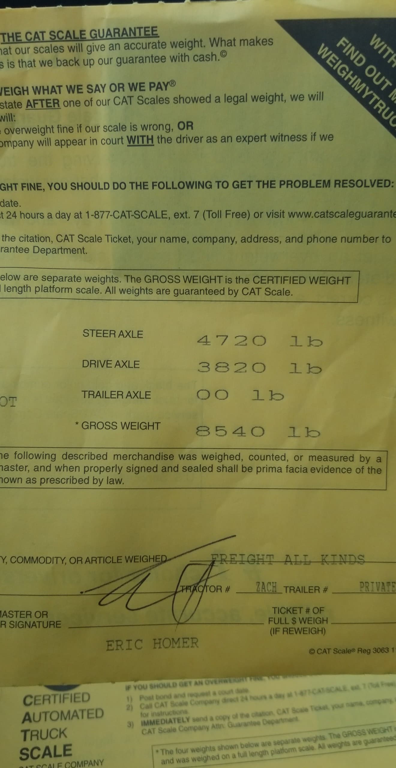

In this day and age of technology - there's lots of options to address the overweight issue...
Your sticker WILL be different than mine

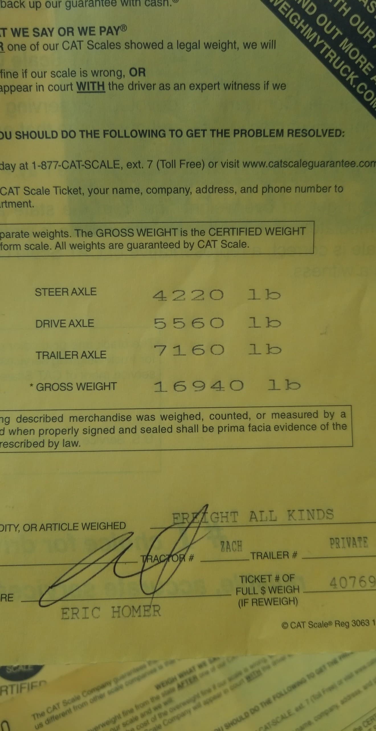

And...
Your sticker WILL be different than mine here also

So that figure for the tires... That's adittional load not including the truck?

Sometimes people obsess over the term payload - Ram classified the Power Wagon with a GVWRC of 8510 pounds despite it being a 3/4 ton truck. It has been classified that way through each of the modern generations. A standard 3/4 ton Ram with a 6.4 hemi and 11.5" rear end is given a GVWRC of 10000 pounds.Takingatrip1 wrote:So that figure for the tires... That's adittional load not including the truck?
So what is the capacity of the tires?
Goodyear specs. the LT285/70-17 to 3195 lbs @ 65 PSI and that is 6390 lbs for the pair. So driving on the highway, at highway speeds, fully inflated, they can carry that much weight.
What is the capacity of the AAM 11.5 rear axle?
It's listed as 6010 pounds - which is less than the pair of Load range D DuraTracs.
The 2014 PW rear end weighs about 2880 pounds - so considering only the tires and axle the most you should carry on the rear end is:
6010 - 2880 = 3130 pounds max payload
Of course there are other factors which can de-rate your carrying capacity
