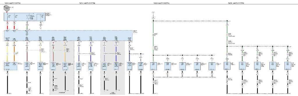

Here is the wiring diagram. They are tied to the parking lights which is normal. If you have DRLs you could always try to run a piggyback pin from the Body Control Module
I don't believe the clearance lights are part of the monitored lights on lights out so you may be able to repin just fine.

I know the tazer ram allowed me to choose if the drl’s are on or off, and what lights would be used if it is on. But i cant remember if the clearance lights were one of the choices or not.

Based on the wiring diagram it doesn't look like they would be part of that circuit but would need to see the pin out on the BCM
