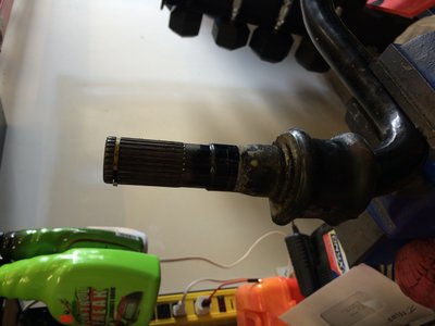

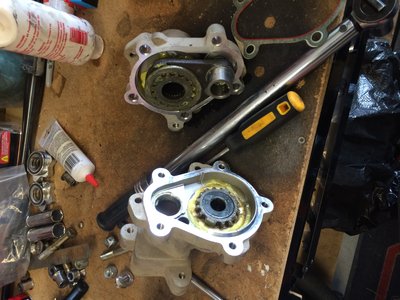

Not sure if this helps you or not but the end of the spline has a c clip on it. Here are some pics.

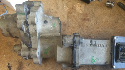

One more pic

Bakes, You could have a weak C-clip on the end of the sway bar. A couple (2, I think) had this problem. All they did was to push the bar back in and checked to make sure it was seated.
