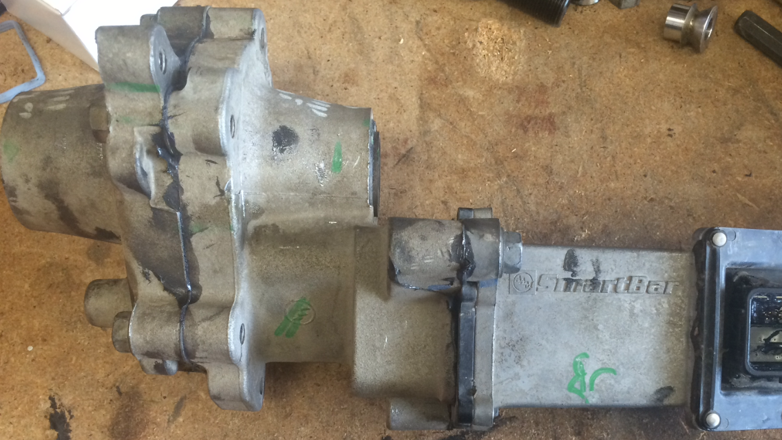

So, the passenger side of my swaybar popped out of my 2013 powerwagon. I don't abuse anything. just started rubbing on hard left turns. It has moved about 3-4 inches out and the splines are visible and just kinda sitting there.

Not sure if this helps you or not but the end of the spline has a c clip on it. Here are some pics.

Post by rbpowerwagon » Thu Oct 20, 2016 7:17 pm
One more pic

Bakes, You could have a weak C-clip on the end of the sway bar. A couple (2, I think) had this problem. All they did was to push the bar back in and checked to make sure it was seated.

I had an '11 that did this same thing twice. Once at 16k miles the other at around 20k. The first time I took it to the dealer and they had absolutely no idea what I was talking about. Then I showed them that the splines were sticking out of the smartbar housing. They said "that's normal. That's how the sway bar disconnect works." I laughed really hard and got in my truck and drove home. I mean I laughed REALLY hard. To the point they were kinda pissed and were gonna ask me to leave had I not been on my way already. Any who, I went home and soaped up the bushing that holds it in place the slid it back into the housing all the way using a dead blow hammer and a block of wood. Then it happened again. This time I took it all apart and found mine was missing that C clip. I work in a factory where We actually machine splines like these so I just got a hold of a buddy and he got me the C clip that was close and I put it all back together and it was fine after that. Granted I don't use the sway bar disconnect at all but when I traded it for my '15 it had 67k and it didn't ever come out again.
