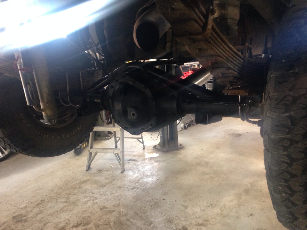

Re: 5.13 R+P for 10.5"
For the front I'm running Chevy gears with a spacer, but aam is now making 5.13's for the dodge carrier that don't need a spacer
Well I'm probably going to copy your build then and start putting together a bullet proof 5.13 gears arb locked 11.5 probably with a truss too. Eff it why not lol
Sent from Canada
Sent from Canada
I somewhat regret not trussing the rear lol. Probably not really necessary but too much isn't enough sometimes
I need to see this truck offroad first before u do any more mods lol. You will have to re learn everything about your truck and how to drive it again. You changed everything lol.
Haha it's true, definitely gonna be a learning curve involved
