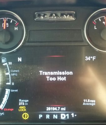

Got the truck back yesterday and went out to the Rio Puerco trail head in ABQ. Didn't make it a mile in before I got the transmission temp warning. This morning I replicated it on a small dirt hill just by holding a steady 1/4 throttle with the truck just creeping up.

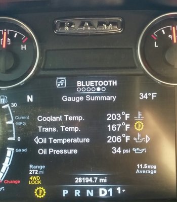

I had my camera ready so I got the initial warning, and the guages immediately after. My findings show that the warning is coming on at lower and lower temps, often at temps lower than what I see sitting in traffic. No limp mode with the warning yet, but there is certainly something wrong here. I just dropped the truck off and sent the rep my pictures. I told him I don't want it back until it's fixed. I'm going to start getting a packet together and prepare to lemon law the thing if it comes to that.

Re: About to pull the trigger on a 15 PW, need some advice!
I figure I would update this for anyone still following. After I dropped the truck off last time, I waited 4 days for the transmission specialist to look at it, only to be told they could not duplicate the problem. They finally agreed to let me take a tech out and show him which I've been suggesting since the second time I went in.
This time the truck had sat and cooled for 30 minutes or so and the transmission temp was at about 157 when I got to the hill. Not sure if that is relevant. The first encounter I had with this problem was at 190, then 176, and then 167 so I expected to have to get the transmission temp over 160. To do that I lightly power breaker up the hill in 4hi 1st gear. 159 degrees. That's how hot it got before the warning. To me that could mean the problem is getting b worse since it happens at lower temperatures every time. Or it could mean the warning is load-induced not temperature-induced. The tech was flabbergasted, he said he had never seen that. I mentioned how it only ever happened in 4hi regardless of grear, so he asked to see in 2wd. That time I did it on level pavement, temperature had climbed to 175 in 10 minutes since the hill and the warning light had gone off, brake down, holding at 1000 rpm. The temperature climbed to 179 and the warning came on again.
I dropped the truck off again and asked for a loaner again. The told me no again. They said unless engine or transmission were out I didn't get a loaner. Anyways they apparently had ever tech there look at it, and somehow after almost 10 unsuccessful attempts to duplicate my findings, they were suddenly able to duplicate it multiple times.
They had no idea what it was so they initiated a STAR case. I told my gf that they will probably just go in and remove the light so I can't see it.
Fast forward 2 days to Thursday. They leave me a voicemail telling me that Chrysler's official decision and solution is...drum roll please....to replace the instrument cluster. Not the transmission, not the PCM, the guages themselves. Idk, to me that's like getting an error message on your computer and replacing the monitor to fix the problem. Of course it will be next week before the new cluster even gets in, I'm not authorised a loaner, and I don't feel comfortable driving the truck. So in 7-10 days when I finally get it back, the first thing I'm doing is heading back to my hill and getting the transmission temp above my highest recorded warning to make sure that it's "fixed". Honestly I don't even know who to be upset. I don't know what my options are. I don't think this issue qualifies for a Lemon case, I didn't buy from a dealer so getting trade or buy back seems pretty impossible since they already treat me like the black sheep when they see the carmax sticker on it. The only good news is that compared to my 1500, I am saving tons of money on gas.
I don't wanna be that guy but 167° is not a issue for the tranny. You cannot let the trans oil temp exceed 300° as at that point internal damage can occur. Your truck is just whining.
150° is the low minimum operating temp
175-200° is normal
275° is the maximum allowable for short duration during long uphill climbs
300° damage occurs like warping of metal parts and melting seals.
I see 200-210° on really hot summer days in the city just putsing around. And it cools off on the highway. I don't think you have a actual issue just a really stupid computer.

I don't see your tempature as bad in any way. At least not from a mechanical stand point.
