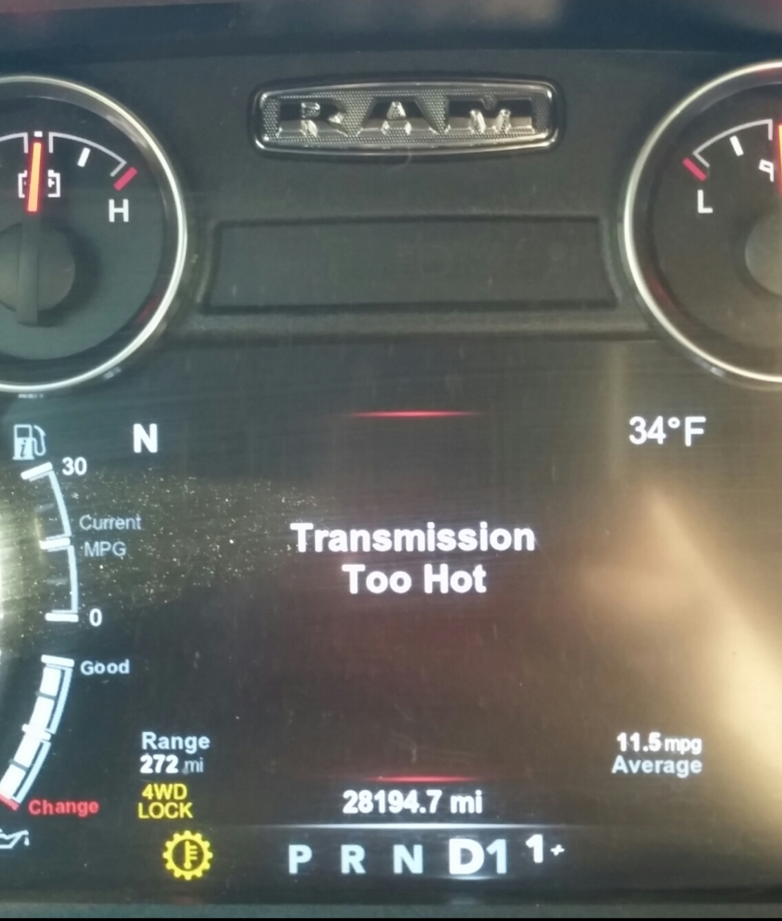

So I got the truck back Tuesday after having CarMax paint a large scratch I hadn't seen. They were super cool about it. I dropped it at the dealer Wednesday to replace the oil pan gasket and to rule out a wrist pin issue. I don't have any of the clatter but I figured worst case, I get a new engine.lol. They fixed the leak and put in the correct amount of oil this time.
Got the truck back yesterday and went out to the Rio Puerco trail head in ABQ. Didn't make it a mile in before I got the transmission temp warning. This morning I replicated it on a small dirt hill just by holding a steady 1/4 throttle with the truck just creeping up.
I had my camera ready so I got the initial warning, and the guages immediately after. My findings show that the warning is coming on at lower and lower temps, often at temps lower than what I see sitting in traffic. No limp mode with the warning yet, but there is certainly something wrong here. I just dropped the truck off and sent the rep my pictures. I told him I don't want it back until it's fixed. I'm going to start getting a packet together and prepare to lemon law the thing if it comes to that.

I figure I would update this for anyone still following. After I dropped the truck off last time, I waited 4 days for the transmission specialist to look at it, only to be told they could not duplicate the problem. They finally agreed to let me take a tech out and show him which I've been suggesting since the second time I went in.
This time the truck had sat and cooled for 30 minutes or so and the transmission temp was at about 157 when I got to the hill. Not sure if that is relevant. The first encounter I had with this problem was at 190, then 176, and then 167 so I expected to have to get the transmission temp over 160. To do that I lightly power breaker up the hill in 4hi 1st gear. 159 degrees. That's how hot it got before the warning. To me that could mean the problem is getting b worse since it happens at lower temperatures every time. Or it could mean the warning is load-induced not temperature-induced. The tech was flabbergasted, he said he had never seen that. I mentioned how it only ever happened in 4hi regardless of grear, so he asked to see in 2wd. That time I did it on level pavement, temperature had climbed to 175 in 10 minutes since the hill and the warning light had gone off, brake down, holding at 1000 rpm. The temperature climbed to 179 and the warning came on again.
I dropped the truck off again and asked for a loaner again. The told me no again. They said unless engine or transmission were out I didn't get a loaner. Anyways they apparently had ever tech there look at it, and somehow after almost 10 unsuccessful attempts to duplicate my findings, they were suddenly able to duplicate it multiple times. They had no idea what it was so they initiated a STAR case. I told my gf that they will probably just go in and remove the light so I can't see it.
Fast forward 2 days to Thursday. They leave me a voicemail telling me that Chrysler's official decision and solution is...drum roll please....to replace the instrument cluster. Not the transmission, not the PCM, the guages themselves. Idk, to me that's like getting an error message on your computer and replacing the monitor to fix the problem. Of course it will be next week before the new cluster even gets in, I'm not authorised a loaner, and I don't feel comfortable driving the truck. So in 7-10 days when I finally get it back, the first thing I'm doing is heading back to my hill and getting the transmission temp above my highest recorded warning to make sure that it's "fixed". Honestly I don't even know who to be upset. I don't know what my options are. I don't think this issue qualifies for a Lemon case, I didn't buy from a dealer so getting trade or buy back seems pretty impossible since they already treat me like the black sheep when they see the carmax sticker on it. The only good news is that compared to my 1500, I am saving tons of money on gas.

Re: About to pull the trigger on a 15 PW, need some advice!
I don't wanna be that guy but 167° is not a issue for the tranny. You cannot let the trans oil temp exceed 300° as at that point internal damage can occur. Your truck is just whining.
150° is the low minimum operating temp
175-200° is normal
275° is the maximum allowable for short duration during long uphill climbs
300° damage occurs like warping of metal parts and melting seals.
I see 200-210° on really hot summer days in the city just putsing around. And it cools off on the highway. I don't think you have a actual issue just a really stupid computer.
The higher the oil temp/duration the shorter the oil change interval due to oil oxidation. And these numbers are for atf under constant temps. Atf+4 has a higher tolerance so this is very conservative.
175° - 100,000mile
195° - 50,000mile
215° - 25,000mile
235° - 12,500miles
255° - 6,200miles
275° - 3,125miles
295° - 1,500miles
315° - 750 miles
335° - 325 miles
355° - 160miles
375° - 80miles
395° - 40miles
These are the distances and temps that major oxidation occurs. Obviously 300° plus is very damaging.
Atf+4 is far different than other oils (dexron, atf+3 ect) as it has higher resistance to tempature, oxidation, shear and cavitation. There are other things too but just do a Google search.
I don't see your tempature as bad in any way. At least not from a mechanical stand point.

You can put a gauge in the outlet line of the tranny. That would show you the working temps of the tranny.  If you put it in the inlet line. That would show you the temps after the cooler. If you put the gauge into the pan. That would give you an overall temps. That would be a mix of hot/cooled fluid, and some what metal temps. I have mine in the pan. I'm using the Mag-Hytec tranny pan.

There is a simpler solution. Get a $20 Bluetooth obd scantool and check to see what the pcm says. If it matches the cluster they cluster won't fix it, if it reads different the cluster probably will fix it.RustyPW wrote:You can put a gauge in the outlet line of the tranny. That would show you the working temps of the tranny. If you put it in the inlet line. That would show you the temps after the cooler. If you put the gauge into the pan. That would give you an overall temps. That would be a mix of hot/cooled fluid, and some what metal temps. I have mine in the pan. I'm using the Mag-Hytec tranny pan.

This is why I love this forum. I just ordered one from Amazon. I'll use it to verify when they get the new cluster put in. And I'll ask the technician that drove with me if they checked the actual temp compared to the display.loveracing1988 wrote:There is a simpler solution. Get a $20 Bluetooth obd scantool and check to see what the pcm says. If it matches the cluster they cluster won't fix it, if it reads different the cluster probably will fix it.RustyPW wrote:You can put a gauge in the outlet line of the tranny. That would show you the working temps of the tranny. If you put it in the inlet line. That would show you the temps after the cooler. If you put the gauge into the pan. That would give you an overall temps. That would be a mix of hot/cooled fluid, and some what metal temps. I have mine in the pan. I'm using the Mag-Hytec tranny pan.

Just got a call from the dealer. Well more specifically I called them to ask if the new cluster was in yet. Turns out it came in this morning, they swapped it out already, and were already seeing the same issue. Which confirms it is not a cluster-specific problem. I called during rush hour for them, so he didn't have much time for me to ask any other questions. He told me that the lead technician on the case has no idea what it could be, and that they have contacted Chrysler again to see what their next idea is. The service rep believes that I'm the only person in the country that has had this problem. He could not give me a timeline to expect. I am fine with waiting, because New Mexico law states that after 30 cumulative days in the shop for the same problem that the vehicle can be considered a lemon and I am at about 18. I love the truck, I wish I could drive it for the next 15 years but this whole ordeal will be hard to forget about when I'm trying to camp 15 miles from pavement and out where there is no cell service.

My guess would be the temp sensor has a momentary short that the computer picks up but the dash doesn't show.adeluca73 wrote:Wow--really sucks , such a strange error process, I'm a bit vexed. Since it's only happening in 4Hi, & the trans isn't really overheating, & the instruments weren't faulty, then something is going on to the trans when you put the transfer case in 4Hi. Maybe it's as simple as the sensor is bad, or maybe the entire trans is bad...
So the last time I drove it with the tech, I actually got the same error in 2wd while lightly power braking.adeluca73 wrote:Wow--really sucks , such a strange error process, I'm a bit vexed. Since it's only happening in 4Hi, & the trans isn't really overheating, & the instruments weren't faulty, then something is going on to the trans when you put the transfer case in 4Hi. Maybe it's as simple as the sensor is bad, or maybe the entire trans is bad...
I spoke to the service rep yesterday and he said the next step is to order and replace "a module." He wasn't sure which one so I'll have to wait until Monday to ask the technician. I also whined enough that they will be putting me in a loaner on Monday. By my count if this repair doesn't work, that will be 3 out of the 4 required attempts to fix this issue. It should also bring it close to or over the 30 day requirement.

Talked to the service rep again today. All he could tell me was that the Chrysler master tech heading the STAR case said that the next step is replacing the transmission solenoid pack and one other solenoid I can't remember. Also after 3 weeks of not having a truck they finally set me up with a loaner to act in lieu of my power wagon. A 1500.lol. I mean it beats a minivan or something, but it is a little ironic that after all the work I've done to get out of my 1500 I wound up right back in one.
