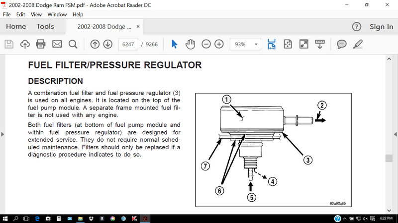

Hello CombatWombat, it's not considered a maintenance item on your vehicle no need to change it.
Re: Fuel Filter? Zo dumb to find?
Yea there wasn't an external one on my 2010 5.7 Hemi either. It's not a maintenance item. The days of fuel filters are passing. Used to be something back in the day you'd change after like 100k.

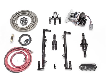

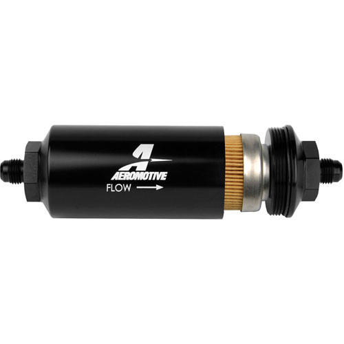

I've looked into doing this myself, the cleanest method I've come across is using a -AN to pushlock adapter either at the tank or the fuel rail and plumbing an inline filter between the stock line/components or if you want to go completely overboard do an aftermarket fuel system from fore innovation, starting with dual pumps in the oem position and run forward with -AN hose and billet fuel rails etc.
- -AN to factory style connection
- IMG_1292.JPG (14.78 KiB) Viewed 4562 times
