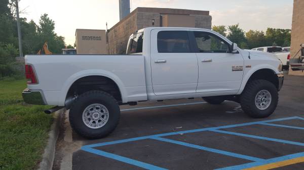

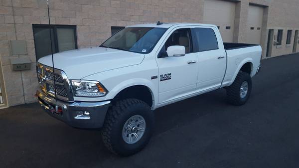

Post by olyelr » Fri Feb 24, 2017 7:36 am
I talked with this guy about his Hutchinsons, and all he could do was praise them.

Post by Hammerballs » Fri Feb 24, 2017 8:56 am
olyelr wrote:I talked with this guy about his Hutchinsons, and all he could do was praise them.
That truck looks exactly like mine. I would go black wheels though to go with the black bumpers and rock sliders I'm adding.
