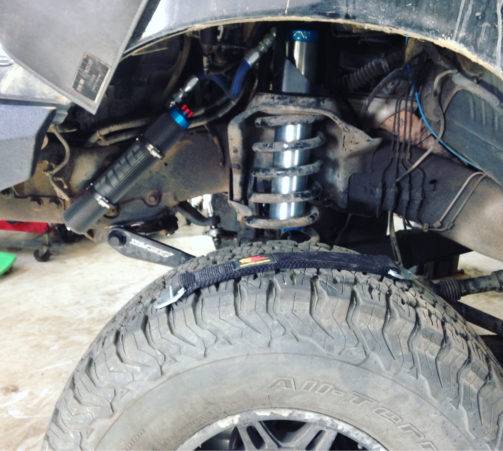

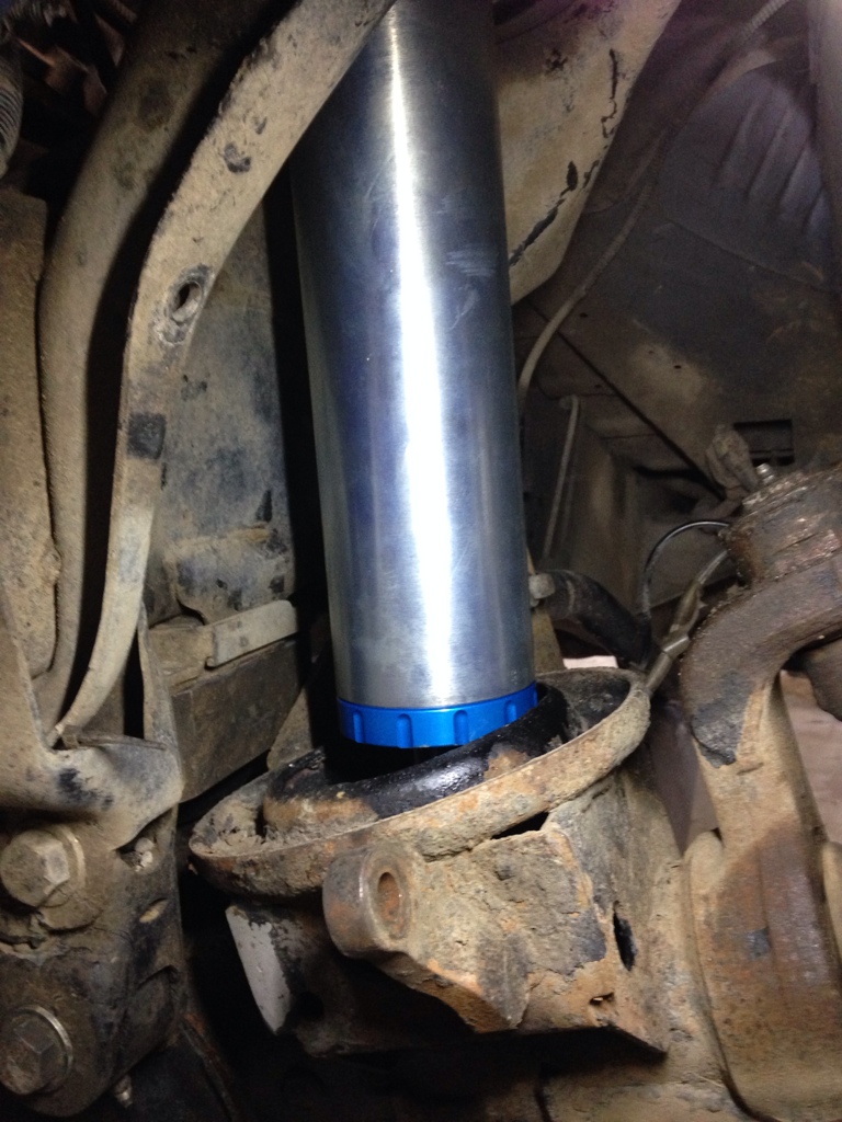

Jesus! That is one huge reservoir!!!!
Re: "Saggin wagon" short and sweet.
Lol ya it was a pain to get in there .... A real pain.

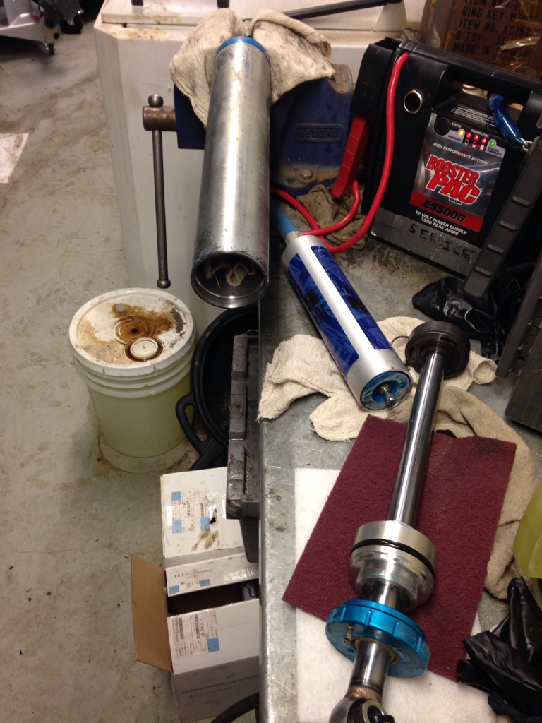

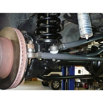

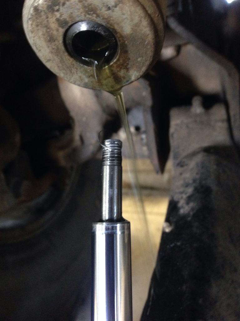

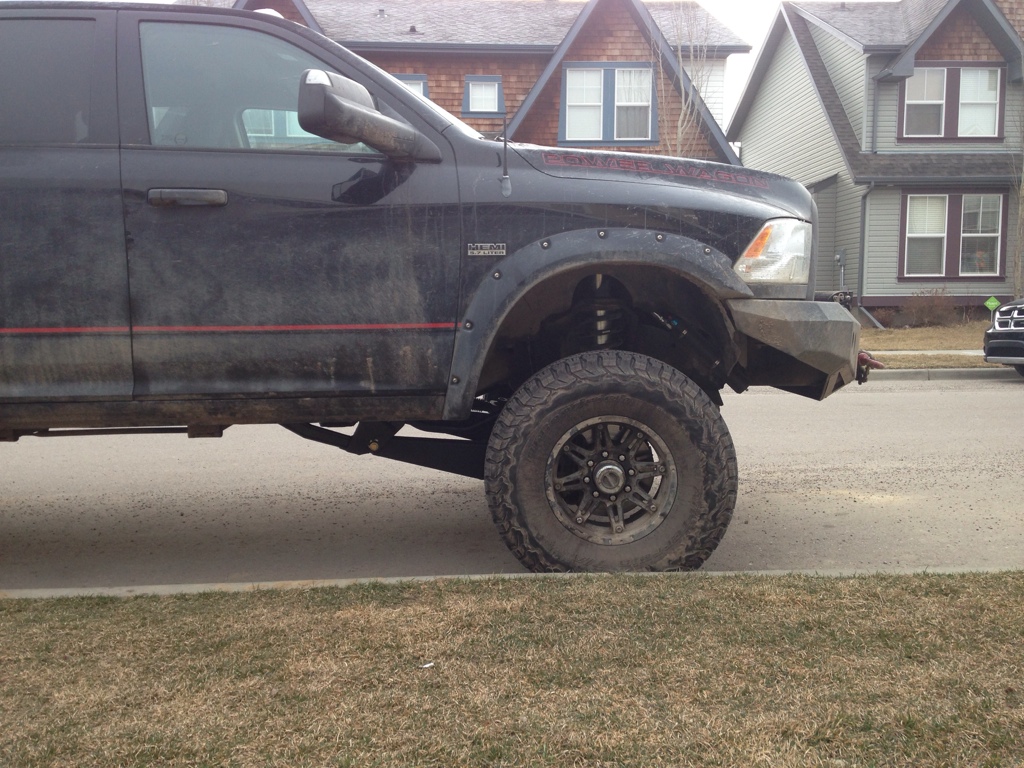

Btw they ride really nice tho! unfortunately got a pleasant surprise when I removed driver radius arm and control shock... Looks like it hasn't controlled anything for awhile lol.... Funny wasn't even leaking.... Maybe a factory defect or something? Pretty pissed I have to buy one now just to sell these effin arms....

Is it possible lee that that shock blew out all its fluid cause it was filled with maple syrup over the winter?? It is a 7100 after all.

https://vimeo.com/161547339 no it was full bud! Thin syrup If that was it!nts007 wrote:Is it possible lee that that shock blew out all its fluid cause it was filled with maple syrup over the winter?? It is a 7100 after all.

Lol. Looking forward to your final install. Did you buy a Prius for a daily driver yet?? Cause they are sooooo sporty now hahaha. Don't know about its jumping prowess but if anyone could find it that's you!!
Hurry up and get those alien arms installed!!

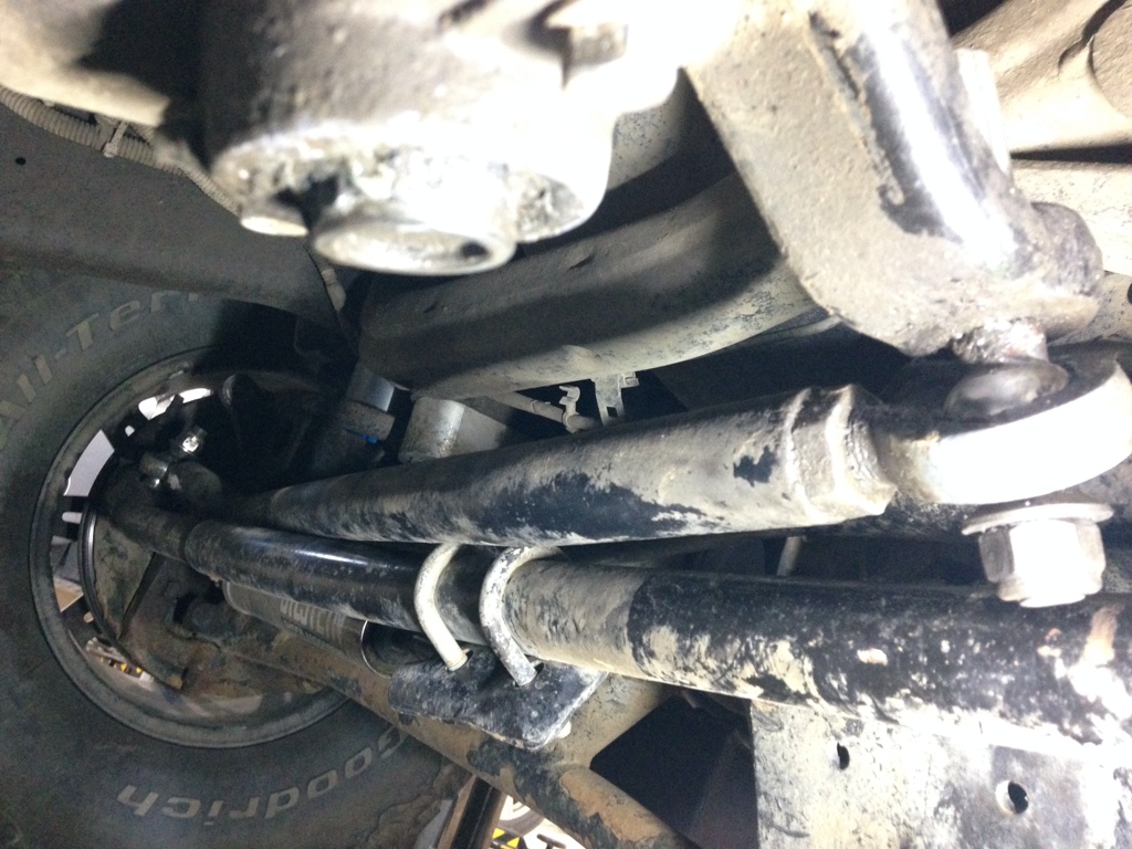

lol they are on! And they are smooth!nts007 wrote:Lol. Looking forward to your final install. Did you buy a Prius for a daily driver yet?? Cause they are sooooo sporty now hahaha. Don't know about its jumping prowess but if anyone could find it that's you!!
Sent from Canada
Re:
Shit, that's awesome! How do they compare to the radius arms?
Re:
2wagons1driveway wrote:lol they are on! And they are smooth!nts007 wrote:Lol. Looking forward to your final install. Did you buy a Prius for a daily driver yet?? Cause they are sooooo sporty now hahaha. Don't know about its jumping prowess but if anyone could find it that's you!!
Sent from Canada
Yea how are ey in comparison. The radius are supposed to the the smoothest riding so...
I was telling Tim last night they feel the same if not a bit smoother truthfully. Also one thing I've noticed is they are quite a bit quieter as well as less play in the front end all together. All the Johnny joints were still good and toght in the radius arms just maybe the fact they were bolted in allowed them to move around and make noise that much more? I dunno I'm impressed so far. Hoping these stainless joints hold up better in Canada as well!nts007 wrote:2wagons1driveway wrote:lol they are on! And they are smooth!nts007 wrote:Lol. Looking forward to your final install. Did you buy a Prius for a daily driver yet?? Cause they are sooooo sporty now hahaha. Don't know about its jumping prowess but if anyone could find it that's you!!

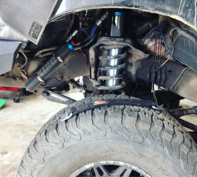

Looking fantastic lee! Cycling the front end is such a chore but totally worth it for peace of mind, those arms and shocks are straight pornography!

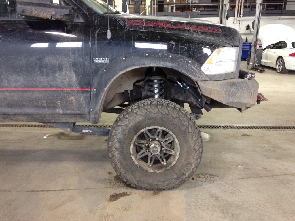

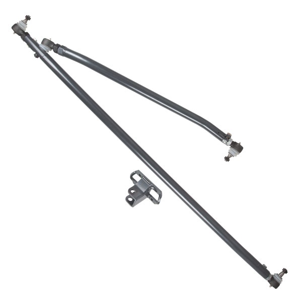

Hoping this new synergy steering will fix this problem at full bump- steering stuff connecting is no good :/ this is at 100% bump tho boogie completely gone And only the 1/4 base plate
Help this Thuren fab drag link is meant for a three inch lifted truck or stock-so I can only expect so much out it with a drop pitman arm that reverses the mount position. The synergy steering looks like a straighter drag link so it should function nicely if not I will take that bitch back and buy cross over steering

a straighter drag link shouldHelp this Thuren fab drag link is meant for a three inch lifted truck or stock-so I can only expect so much out it with a drop pitman arm that reverses the mount position. The synergy steering looks like a straighter drag link so it should function nicely if not I will take that bitch back and buy cross over steering

It's not good when two shafts touch each other...
technically I think ones a rod :/ lolWill wrote:It's not good when two shafts touch each other...

Lol ^^ I talked to don Thuren and apperantly my drag link will clear just fine when it's in the right spot lol fml I have had it installed wrong the whole time I've had it!! Need to be rotates forward more

also clean up the 3.0's for their new owner a lot of grit got Into the drivers seal head from the wiper seal letting stuff by. So I cleaned that mess all up so now they both cycle smoothly etc....
