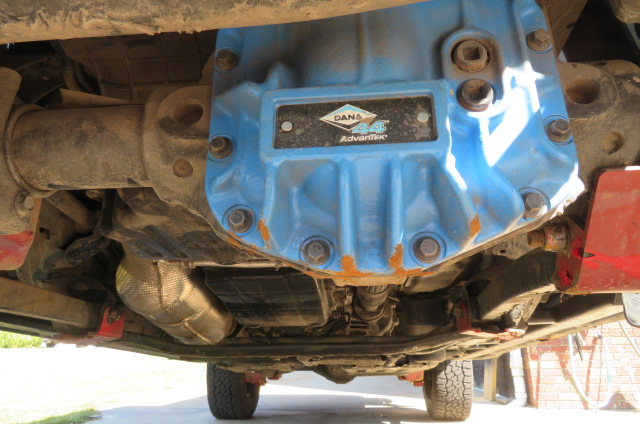

little trail damage from Rausch Creek.
The Diff covers
The Diff covers

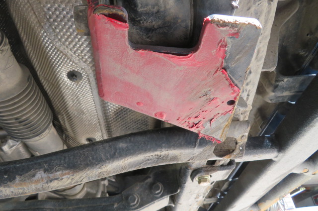

The suspension skid plates got kissed.

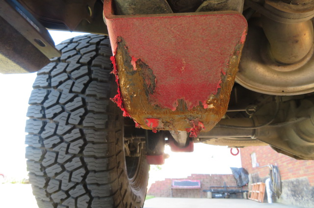

The White Knuckle sliders did their job. They got landed on from a 3ft drop. The Line-x coating got peeled off in a few spots.

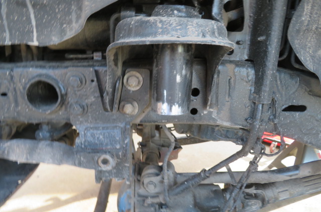

Added a Steer Smart steering box/ track bar brace.

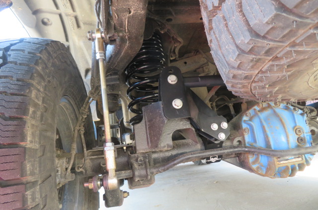

Installed a Frankenstein lift kit. Parts from different companies. Here's a list.
1. JKS Front Adjustable Coil Spring Spacer with Hydraulic Bump Stop. ACOS Pro. This will raise the front 2" by it's self.
2. Clayton 2.5" Diesel Springs in the front and Clayton 3.5" spring in the rear.
3. Core 4x4 Crawl Front Track Bar.
4. Core 4x4 Crawl Front Lower Control Arms.
5. Clayton Rear Track Bar with the bend for a 37" spare.
6. Clayton Sway Bar End Links.
7. Bilstein 5100 Shocks.
8.Teraflex Rear Upper Control Arm Extended Travel Brackets.
9. Teraflex Rear Spring Retainer.
10.Teraflex Rear Track Bar Bracket.
11.Teraflex Geo Bracket.
12.Teraflex Geo Bracket Reinforcement Kit.

Before picture. Picture with the 2.5" rear springs and with the 3.5" rear springs with 37"tires. I originally wanted a 2.5" lift. So I got the Clayton 2.5" springs for front and rear. I didn't know that the JKS adjustable spring spacer would add 2" of lift by it's self. So I ended up with 4" lift in the front and 2.5" in the rear. The JKs sleeve is tack welded in place, so that wasn't coming off. So I decided to get the Clayton 3.5' rear springs. That leveled out to Jeep.
