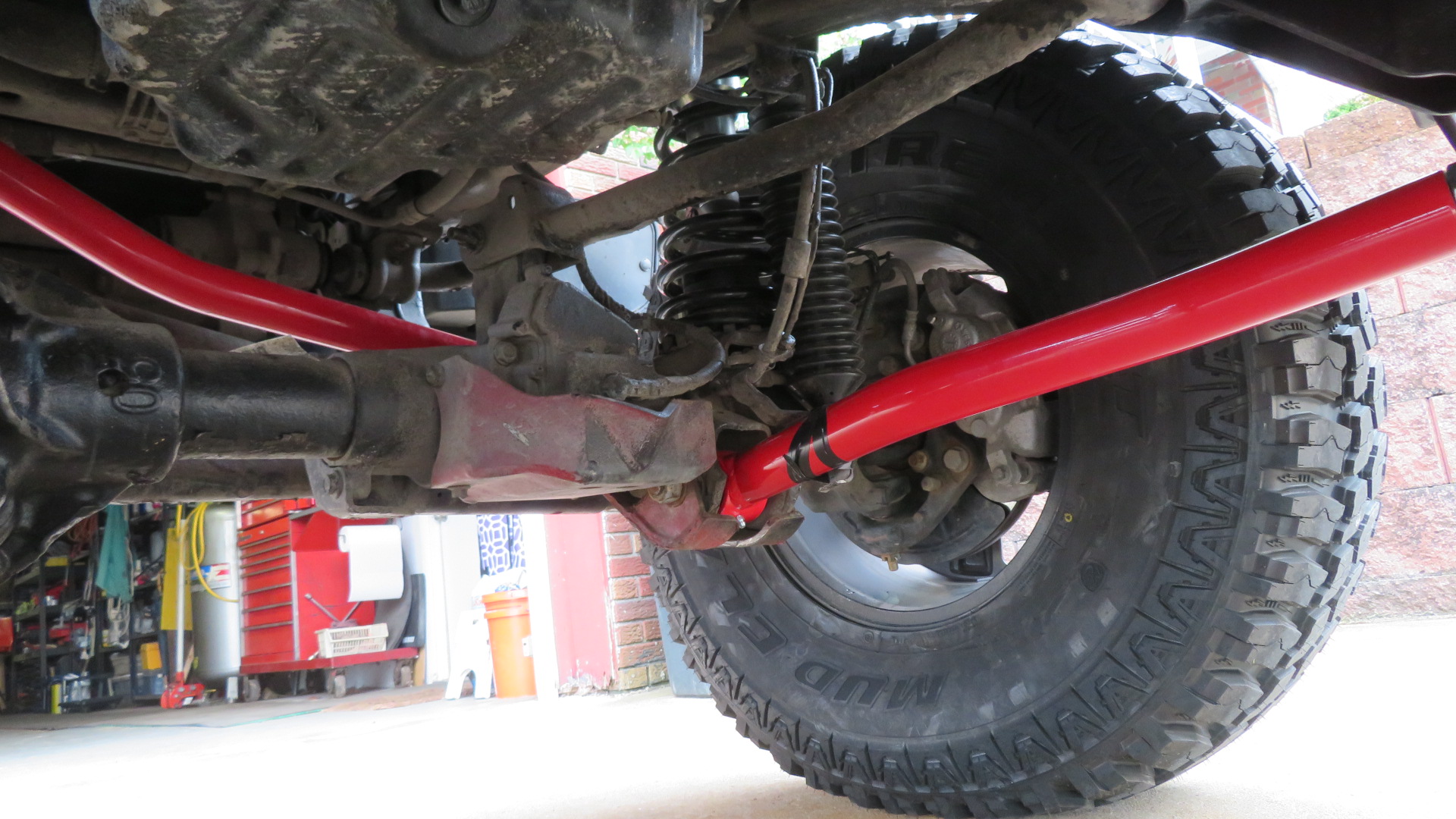

- Posts: 5574
Re: Rusty's Build 2022 Gladiator Rubi Diesel
Added a Steer Smart steering box/ track bar brace.
