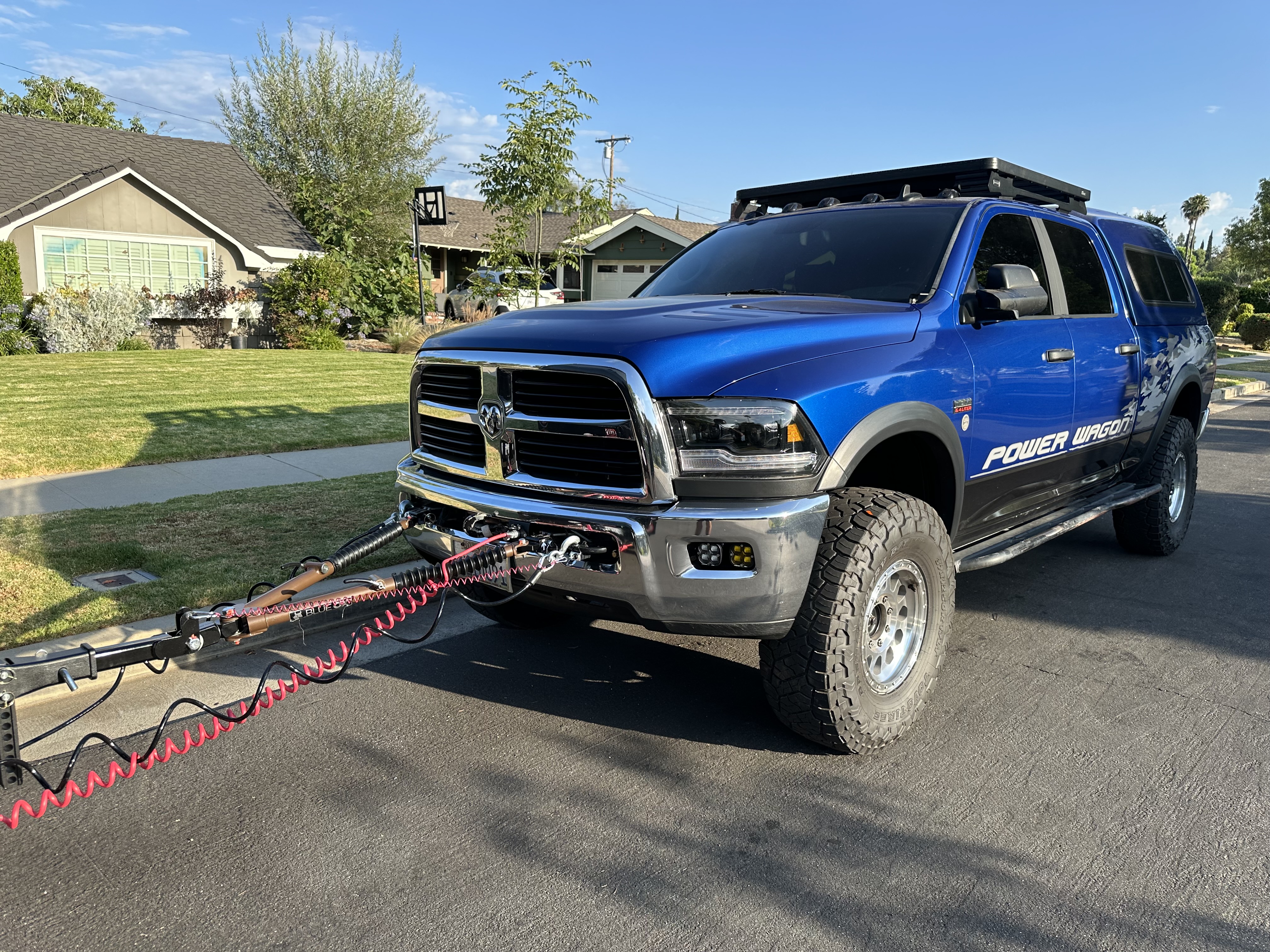

So I gathered all of the parts for this from etrailer and went with the Blue Ox components they recommended as well as the patriot brake kit. The only thing that wasn't readily available was the baseplate kit. I was hoping to get all of this together before a trip up to the Sequoias, but etrailer showed a month + eta on the baseplates, I called Blue Ox directly and they said at least 2-3 months - bummer. I sent some pics over to a friend that runs an off road fabrication shop in Simi Valley, Ca called The Fab Lab, and he whipped up some baseplates next day! I got them bolted up, and took it for a spin, and it felt fine. Definitely tows differently than a normal trailer, you can feel the weight back there when switching lanes or going over some of the nasty bumps in the slow lanes, but overall tows well and it was nice not having to pack up the motorhome and worry about parking that thing when we wanted to head out somewhere.
- Eddie
Will post some pics from my phone shortly

Post by yellowranger1 » Tue Jul 30, 2024 3:28 pm
Need to get some longer safety cables, and final mount the breakaway box, other than that it’s ready for more trips 🤙🏽

Post by yellowranger1 » Sun Aug 04, 2024 11:34 am
Not sure why it only posted 1 pic, here’s a couple of the bracket
yellowranger1
Posts: 286
Re: Flat Tow PW
Post by yellowranger1 » Sun Aug 04, 2024 11:38 am
Mounted on the truck
