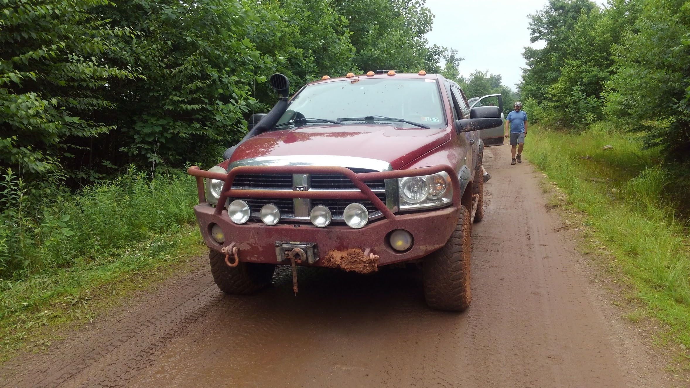

Off road lights in the center. Driving lights to the outside of the off road lights, Fog lights down low.

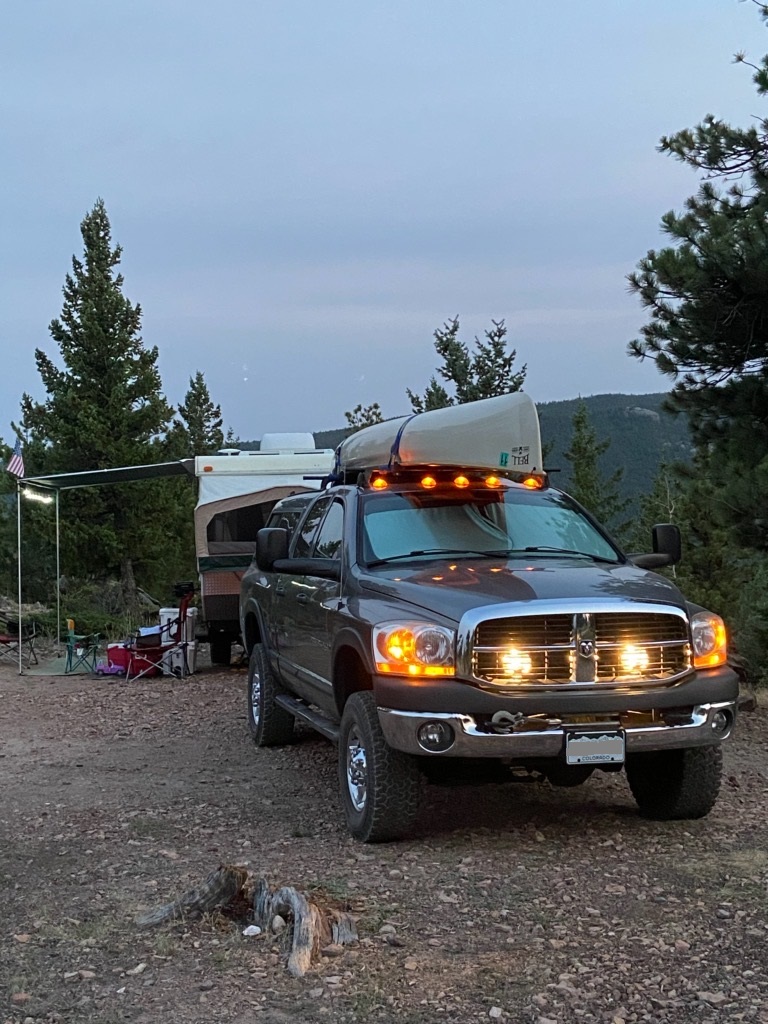

I have 4 KCs on the RED bar as well. 2 spots in center and 2 wides on the outside very slightly angled out (deer avoidance/ditch lights). Spots on one switch and wides on another. I find that being able to turn the wides on by themselves in certain weather, mist, fog, snow can help vs hinder sometimes. But, scouts honor, I never turn them on on the roadImageImage

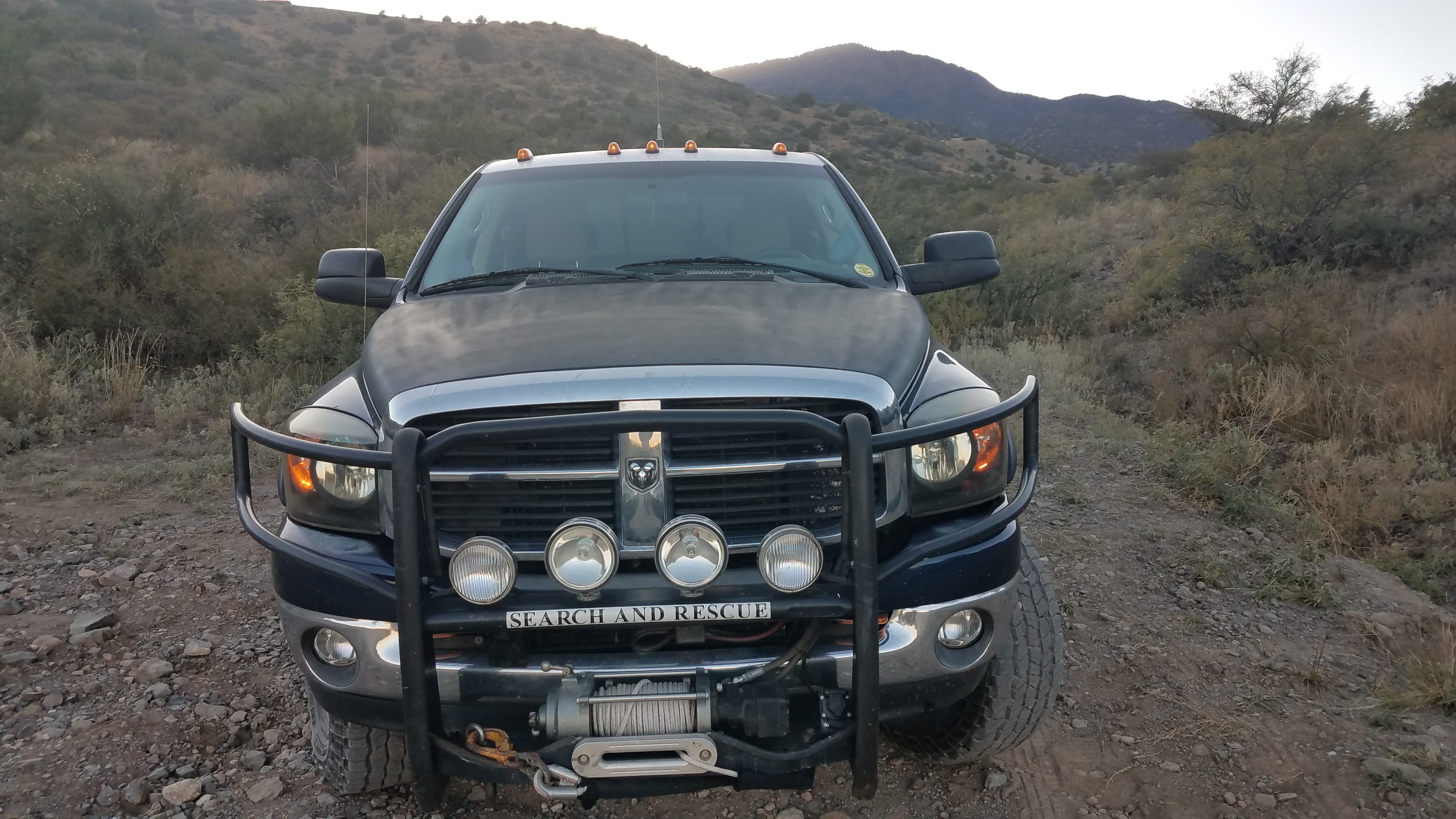

No hood lights or roof lights EVER!!! Center lights are long distance pencil beam, outters are for pattern and aimed slightly toward the ditch. Perfect for my use. I do search and rescue with my truck.
