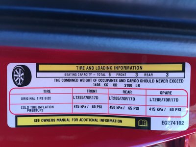

The Payload value is based on the options that are on the truck. It is effectively 8510 lbs minus the empty truck weight.
The gen 4 Power Wagons are 3/4 ton trucks with flexy springs roughly equivalent to a 1/2 ton.
If you want tow or haul as a standard Ram hemi 3/4 ton, your easiest and cheapest solution is to install airbags... :rockon:
Ram hemi 3/4 ton crew-cab payload is around 3100 lb
