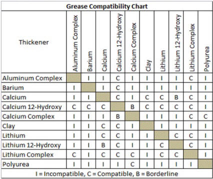

A little grease goes a long way.
Make sure you're adding a compatible grease to whats already in the bearing. Mixing incompatible products will cause them to breakdown and liquify.
Sorry for being a FUD monger.
Re: Wheel Bearing/Hub Recommendation
There is so little grease in factory bearings that diluting it so much probably saves any issues. Word from the OG crowd has been consistently - grease through ABS hole, use what tickles your fancy, and this has shown repeatedly longer bearing life by large margins with no negatives as of yet. This has probably been going on 10-12 years.
I use Amsoil Off-road grease NLGI 2 in mine. I have no clue what came in the bearings nor any idea how to even lay eyes on it without cutting the bearing open or destroying the seal
That said maybe somebody could run into an issue but I’ve not heard anyone have problems.
