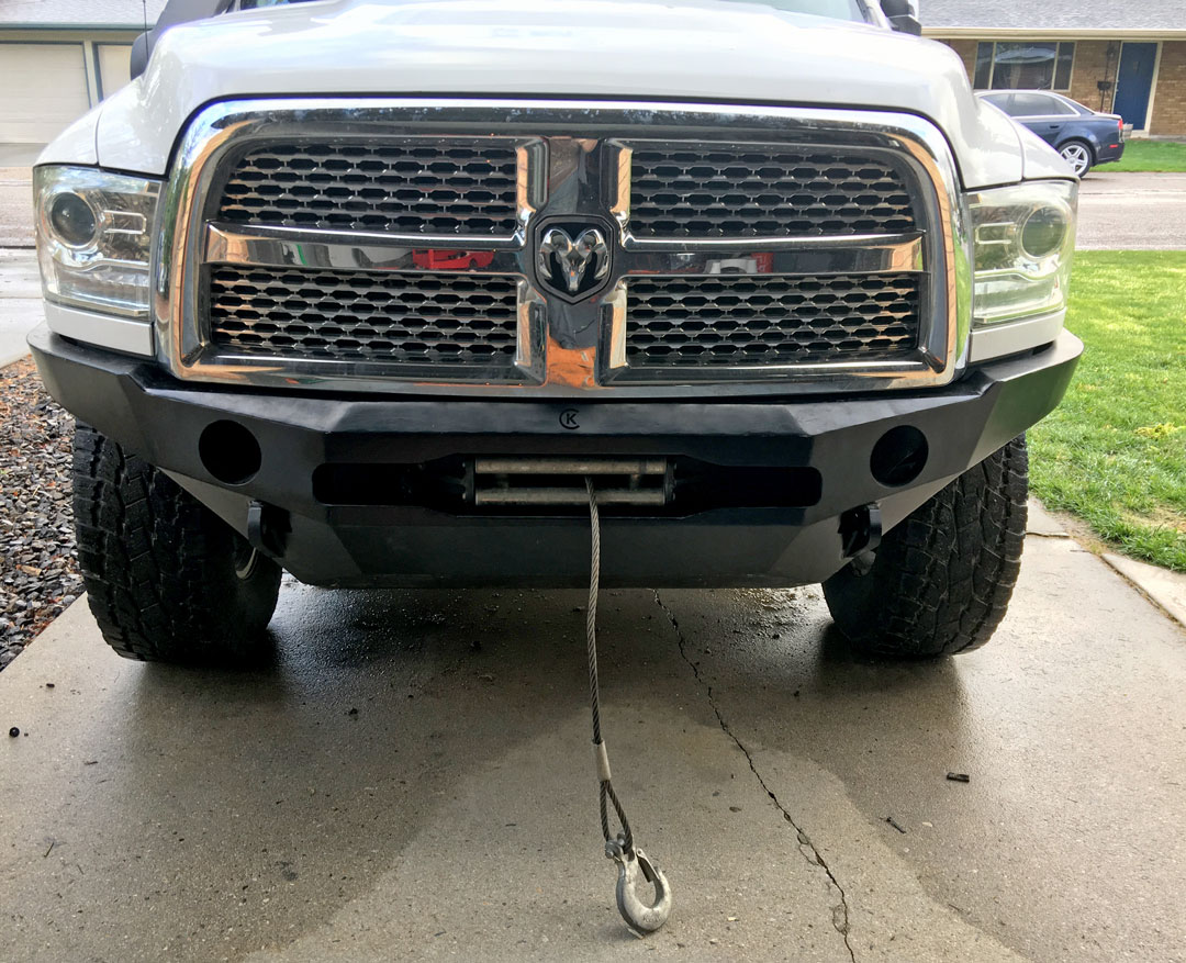

Here's my doodle hanging out.
Re: Winch Line Won't Retract
And a nice doodle it is. If the winch still spools in one direction out just keep it spooning out till all the line is out and it starts winding in. Just remember to re wind it the other way before you use it

On a positive note... That bumper looks killer!!!MikeKey wrote:Not sure I follow. Probably should have saved the beers till after the project was completed.nts007 wrote:You can just reverse wrap the spool till you can fix it. Just keep letting line out till it starts going in

That bumper looks awesome, can't help but imagine it on a MY17 truck with its black grille
