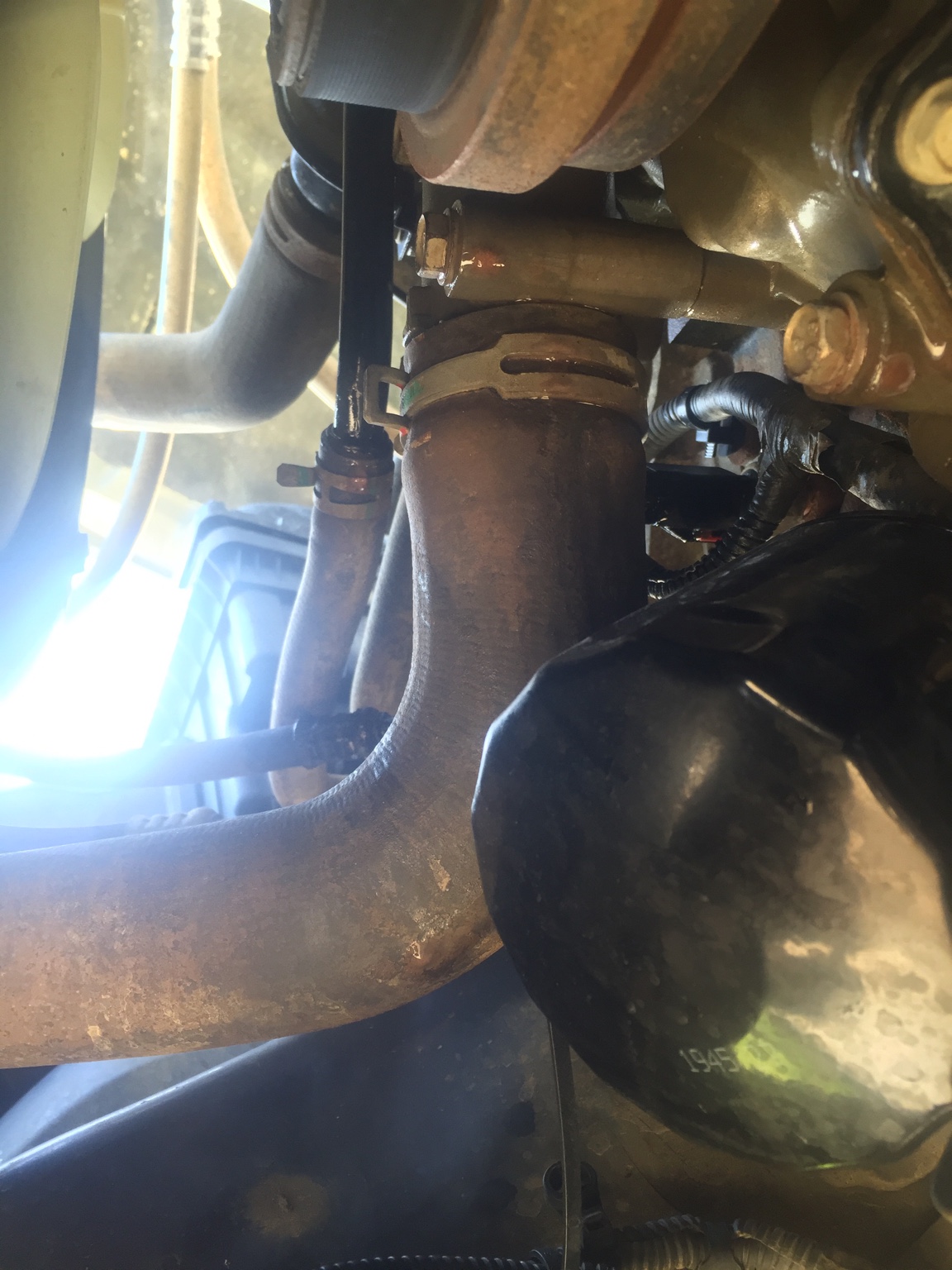

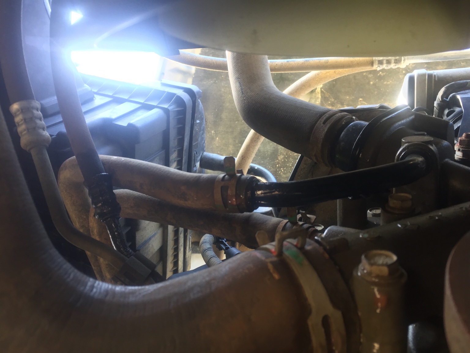

Gents, top of the morning. I have had an odd leak and I can't quite figure it out. I think it is coolant because of the color. It is orange not red like tranny fluid. I think I have it to where its leaking, but not sure. And it only does it if I DON'T drive the truck…. The fan dries it all up, then when it sits I get a leak. I have not driven the truck since Friday night. Not moved it since. It seems like as the day warms up it might leak more? I pulled the big upper hose off I thought it might be and didn't see anything odd. The gasket/o-ring looked attached to the motor?
Here are a few pics. Not the best pics and the 2 are from under.

2 ways to tell what it is. The touchy feelly test, and the taste test. Try looking at the weep hole under the water pump to see if anything is leaking from it. Might have to use a small mirror.

That's coolant all day long. Check the water pump, heater hoses, going to need to dry it and then watch to see where it's coming from.
Re: Leak
Get your hands on a pressure tester, too.
Re: Leak
Yup, coolant all day long. Thermostat gasket, or water pump.
Thermostat gasket on my truck (2008 5.7) goes around the edge of the thermostat. If it squishes & shrinks too much, it will leak. This is what happened to or 04' 5.7, the night before our vacation. No one had one in stock. I went to NAPA. Guy said don't panic, it not rocket science, it's just plumbing. He sold me a generic piece of rubber gasket material. I went home, traced the thermostat housing on it & cut it out. Installed it & it fixed the problem & was still holding strong when i traded it in on the PW. I think there should have been a real, regular gasket there anyways. It would have prevented this from happening in the first place.
- Posts: 59
Re: Leak
I've had the exact same gasket problem that TwinStick references on our '04 Durango. Easy fix. The thermostat housing only has two bolts that hold it to the block (metal-to-metal interface), with the thermostat gasket acting as the seal. Over time, I'm sure the heat cycles affect the sealing capability of the rubber.
