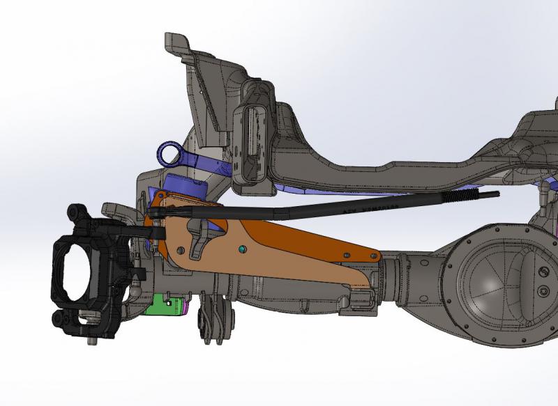

For those who are thinking the AEV lift is just a typical cheap kit with a few spacers, here is a good bit of information about it that I read on another forum. This is written by a fella from AEV...
Wow! Where to start?!?!
First, I'll ask for the benefit of the doubt on the "spacer" lift and what that really means. I know as well as all of you that a "spacer kit" has certain connotations that are hard to overcome, but let me take a stab at correcting some of the misinformation on the first 4 pages of this post and see if I can't swing some of you who are willing to listen/read. This isn't some pc of sewer pipe with two flanges welded to it and stacked on top of the spring
Keep in mind a few things:
AEV certainly knows how to do spring engineering, in fact, I would argue that between Jim and Dave Yegge (former chassis engineer on TJ and JK) we have more knowledge and spring engineering capability than any of the "enthusiast turn suspension company's" in our industry. I would also argue it would have been cheaper/easier and faster for us to spec and make springs than to go the route we did.
The cast aluminum spacers we use are far more expensive than springs with far lower ability to mark up from a business standpoint. Springs are relatively cheap. We did this because it was the best way, not the cheapest.
The spacers are a relatively small part of the kit. The forged draglink, trackbar, geometry correction and shocks all play into the kit in big ways. Don't forget the kit comes with a procal to correct for tire size and gear ratio because we don't just leave it up to our customers to figure it out. All that is important to make sure things like ESP are working properly.
While AEV does sell a lot of parts into Jeep and has had a relationship building show cars for nearly 20 years, we are not "part of Mopar" in fact with the Jeep they now sell their own kits and with the Ram they sell I believe a rebadged Superlift kit.
Jim Frens formerly of Jeep/Chrysler, Nth Degree and AEV still does all of our suspension design and is responsible for all the engineering in this kit. Personally I am very proud of this kit and Jim's work. Though this kit is unconventional, we went through much more expense for what is routine in the aftermarket, I think its our best work yet.
Our intent for this suspension was not to try and make the Ram a rock crawler, a pretend trophy truck, or something that was all looks, aka 12" lift with fancy shocks. Our intent was to increase the off-road capability but not ruin the truck in terms of what 99% of people use these trucks for, everyday driving, towing, and load carrying. That meant low lift, big tires, proper geometry and OE engineering.
On to the (front) suspension:
We started with the steering, in order to not have the issues most lifted Rams have, we kept the steering angles stock, to do that we forged a new draglink that flips the TRE onto the top of the knuckle as we pioneered and have been doing on the JK since its introduction. This flip set the height, 3".
In order to fit 37s on with only 3", that dictated moving the axle forward, in order to do this we needed to make an all new trackbar and geometry correction bracketry for both the control arms and the trackbar.
Since our stated goal was to keep the MILLIONS OF $$$ in OE engineering, we decided to base the lift portion on the stock springs since we realistically could increase travel (ours has 5" of uptravel vs 4" with OE and most aftermarket) without yielding the springs.
Anyone who has ever been involved with car companies knows that they don't do things that cost money if they don't have to. The new Ram has 44 front spring part numbers, 18 for the rear of a 2500. The front springs are specifically matched to the rear springs for frequency tuning and is critical to making the truck ride correctly. In the aftermarket, you'll typically see one rear spring and two front springs (gas/diesel) THATS A MAJOR ISSUE. I'll be honest, we can't and I don't think there is a single aftermarket company out there than can inventory 44 front springs and 18 rear springs, nor could any of our dealers inventory any of that. The customers ends up throwing out away springs that Ram thought was so important that they couldn't get away with less. For those who don't understand why there are so many, it has to do with weight, wheelbase, cab style, and options and capabilities that you, the customer, specified when you went out and specifically bought a Cummins, manual trans, megacab with a 6'4" bed. Yes the springs are very different than a gas auto single cab longbed with a tow package. Remember our goal was to not ruin the truck's capabilities for what most people use them for.
There are spacers and then there are spacers. Ours is a cast aluminum 3" spacer on the bottom of the spring attached to the axle which allows the spring to maintain its inward camber as designed but that gets eliminated with an aftermarket spring, it gives 3" of lift, it allows us to move the axle forward in vehicle position and it gives us a way to mount the steel jounce spacer where it will actually work. Those extended urethane jounce spacers in most kits will take very few actual hits before they fracture. This kit has been through extensive durability testing that would destroy most kits on the market.
Here are a few pics, note the camber when viewed from the front that our spacers retain but a taller spring eliminates and causes an "S" to form in the spring. You can also see how the spacer ties together with the trackbar brackets and jounce spacer. Also visible is the draglink flip.
Hopefully this sheds some light on why AEV went with what at first seems like a really bad way to go...the dreaded cheap spacer kit...In reality after looking at the problem extensively, the spacers were the right way to go on the Ram and in fact the springs where the cheaper easier route with less performance.

I am adding the two pictures that he had in his post (which did not show up with the 'copy and paste').
