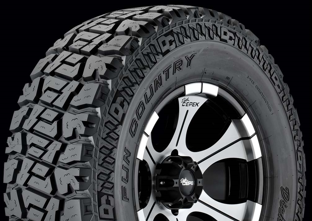

I don't think it's an option through Discount, but I'm interested in seeing someone with the DC Fun Country (the brand new design). Looks like a commercial traction tire like the Goodyear Duratrac and Cooper ST Maxx, and they have the 37x12.50R17 size.

I'm kinda reluctant to go with Dick Cepek tires, I had a set of their mud terrains and they wore quickly and very unevenly! Those were the mud terrains though so, maybe these more all terrain oriented tires may wear better? I ended up opting for some Nitto Trail Grapplers, should be here in a couple weeks. I hope they will be the new design! (37x12.50R17)
