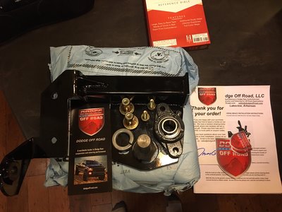

Look what just arrived from Danny at DOR. This thing is massive & heavy & just over the top ridiculous HD steel, & the hardware is no joke. I'll have to have a 2nd set of hands or a floor jack to hold this thing in place during installation, wow!

Subscribed... I ordered one from Synergy, because it didn't say it wouldn't fit a power wagon, but it wouldn't fit a power wagon... Curious to see how you like that one...adeluca73 wrote:Look what just arrived from Danny at DOR. This thing is massive & heavy & just over the top ridiculous HD steel, & the hardware is no joke. I'll have to have a 2nd set of hands or a floor jack to hold this thing in place during installation, wow!

Oooh, I've been eyeing one of those.adeluca73 wrote:Look what just arrived from Danny at DOR. This thing is massive & heavy & just over the top ridiculous HD steel, & the hardware is no joke. I'll have to have a 2nd set of hands or a floor jack to hold this thing in place during installation, wow!

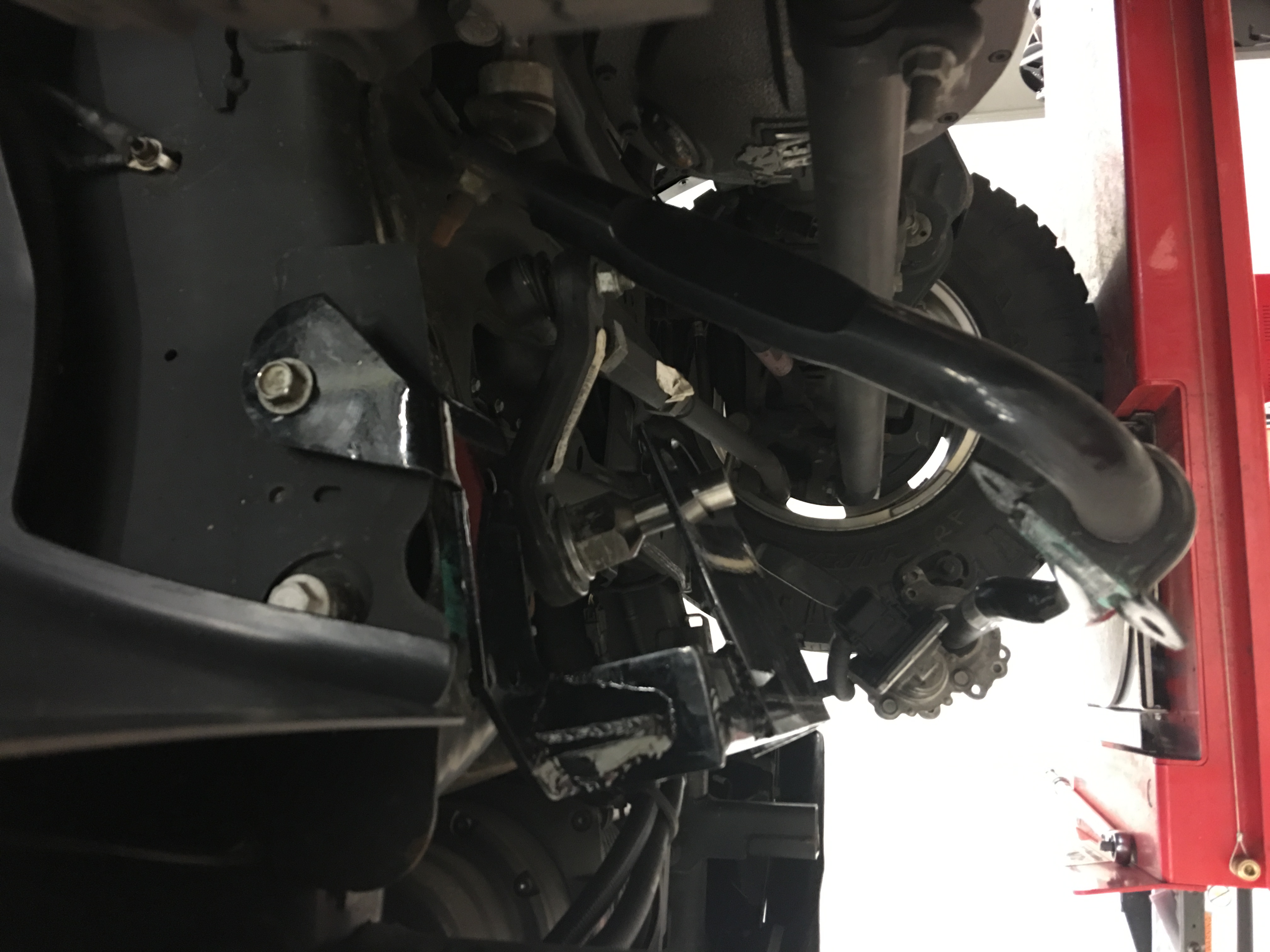

DOR Steering Box Brace
MOD: steering Box Brace
VENOR: DOR (Danny Gaston)
COST: $150 + Shipping
TIME: 2Hr all in
DIfficulty: Light-Moderate

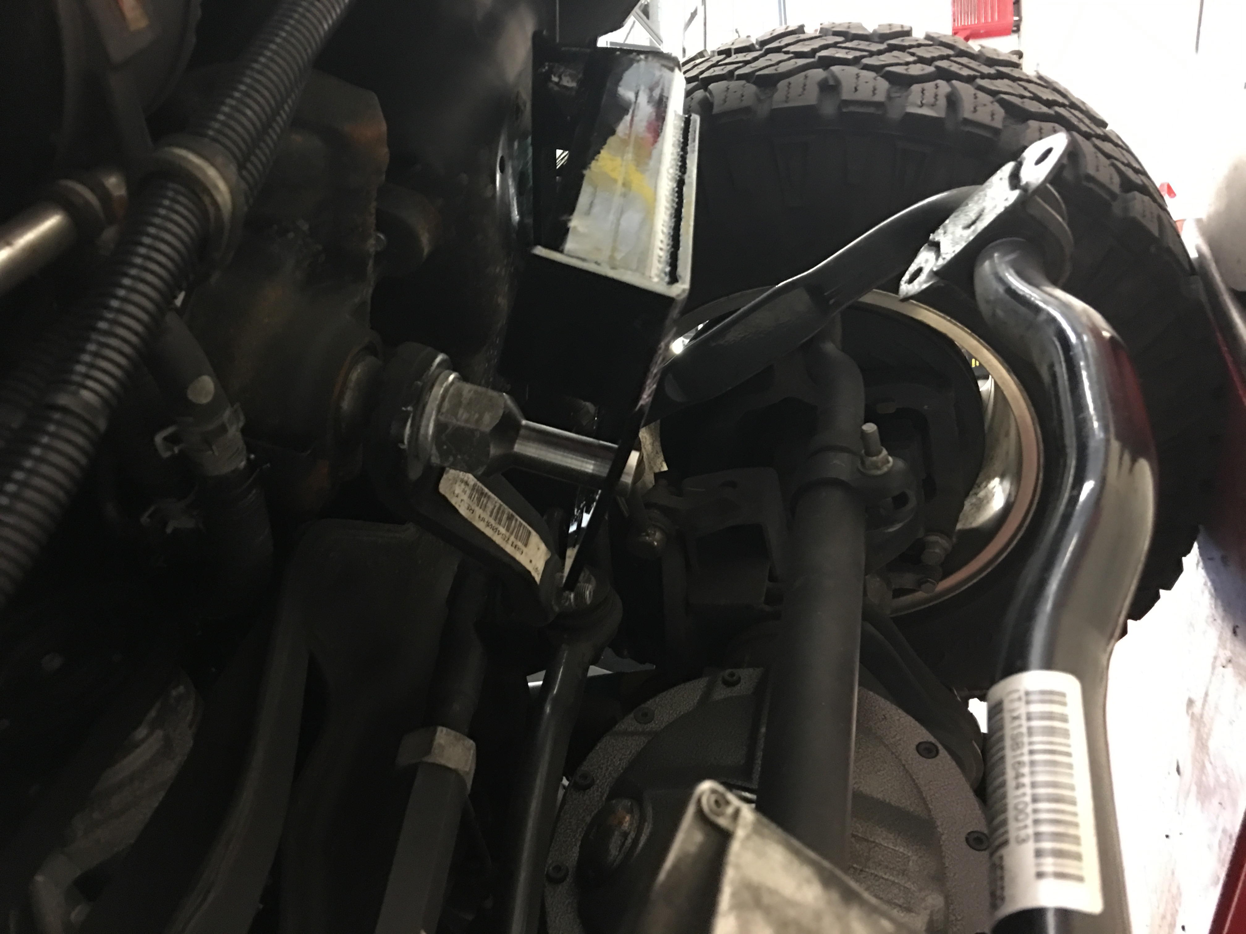

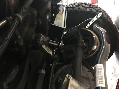

Installed the DOR brace yesterday. Used the base auto hobby shop because they have more tools, & more importantly lifts, so I'm not laying on my back! The install is pretty straight forward, but I recommend completely dropping the sway bar on both sides. If you just back out the passenger side bolts, there really isn't much room to fanagle that 12lb brace over top and then underneath the sway bar. Using an impact makes zipping the bolts in way faster when you're holding the weight of the sway bar & brace with one hand. Also the sector shaft calls for 185ft-lbf torque, but the hobby shop didn't have a 44mm or 1.75" socket, & most of you probably don't I'd guess, my biggest is 37mm & 1 3/8", so I had to use a giant crescent to take off the Pittman arm bolt & tighten the sector shaft extension, which means I was guessing on the torque number.
I put the sway bar through the back of the brace, bungeed then together & lifted the sway bar in place, zipped in passenger side sway bar bushing bolts ½ way, then started the steering box bolt so everything & all weight was being supported by something, then used the ole dead blow persuader to alight the brace holes with the drivers side frame sway bushing holes & with the sway bar itself, started one bolt, aligned for the other, then loosely mounted the shaft bearing race, & stated tightening & torquing in order. Also greased the bearing shaft & hit all bolts with silver anti-seize.
Overall, I honestly don't feel any difference in steering precision, stiffness, or any other basic driver feedback mechanism right now. And it might feel a tad looser than before installed the brace & not sure why either.
Strange about the steering feel, I have no experience with the one sided stabilizer but my regular one made a noticeable difference. I hope you get the looseness figured out soon. Soooo much nicer working on a lift eh?
DOR Brace
Thanks Colibri...lifts do make life easier! I'm not sure why the steering hasn't tightened up w/ the brace. You're right, most I've looked into tie the gear box into both frame rails to provide lateral stiffness in both directions, Danny claims that induces unnecessary lateral loads into the gear box & is more detrimental, & thus that's why he has decided on the one sided brace. The only thing I can try is to tighten up the sector shaft extension more and see how that goes.

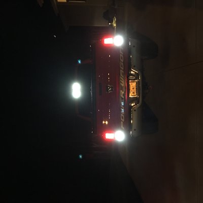

Let there be LIGHT
Minor update:
Ordered Phillips Hi intensity 5500K (white) colored LED's for the CHMCL (cargo lights) and for the Back-up lamps.
The Cargo LED's were about $10 for 2. The back-up lights were about $30ish for two. Use the auto bulb finder here:
http://www.sylvania.com/en-us/applicati ... gmain.aspx
to get the bulb numbers for each type, the search on Amazon for those numbers.
Overall, yes, there was improvement, a lot, eh, maybe enough to justify the cost of the upgrade....

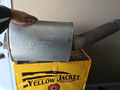

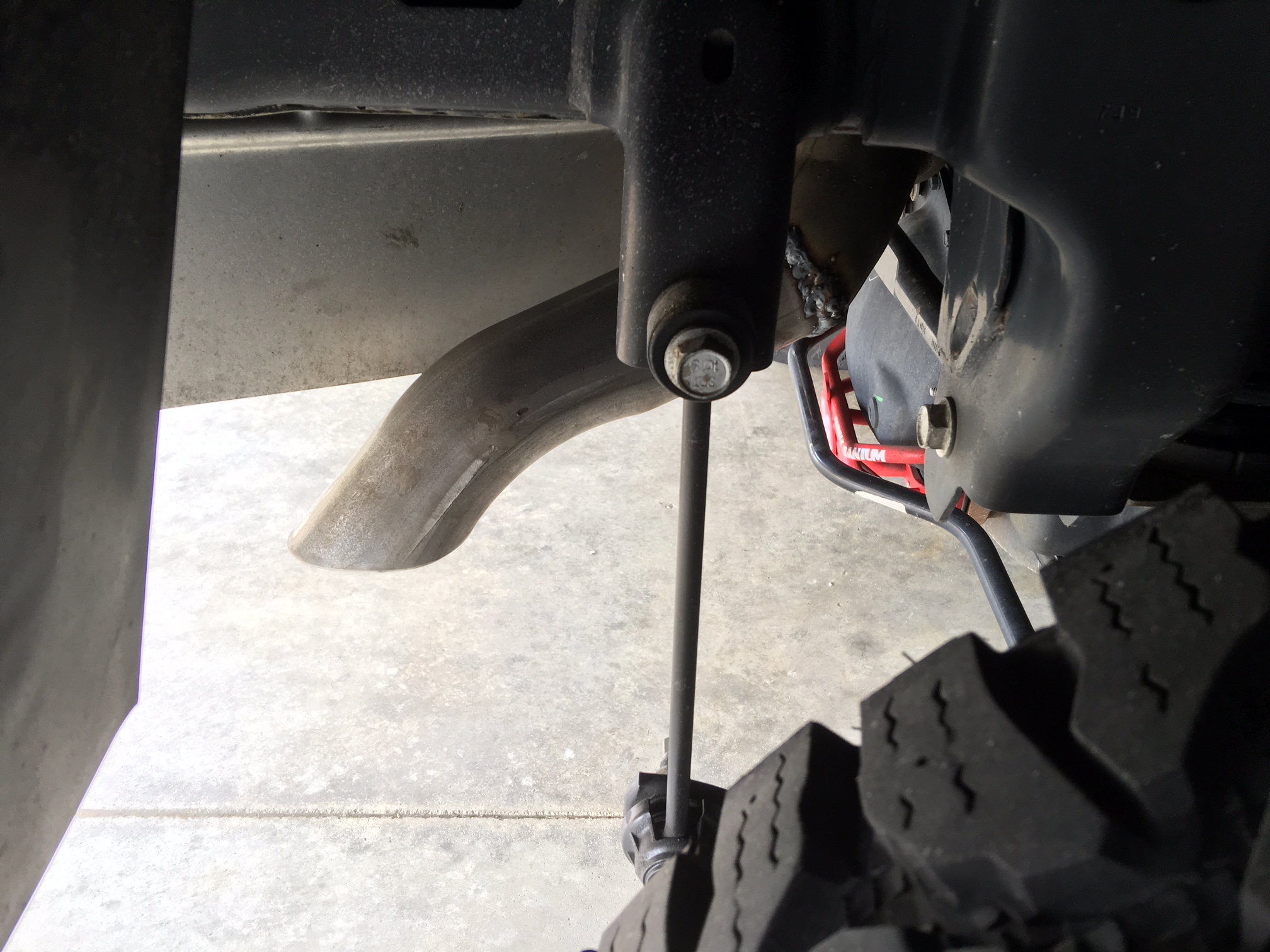

So this mod has been a long time coming. I've wanted to dump that resonator can the 1st week I brought my PW home. I ordered the mufflex replacement muffler within the 1st month, and almost had the shop cut off the resonator and dump the exhaust just aft the spare. I chickened out because I was terrified of driving around in a red neck mobile that was unbearably loud and screamed A-hole on board. Plus in my ehh, 40's, having to blast the radio so I don't hear my exhaust droning on isn't particularly palatable, so I held off. I drug that can pretty bad on the last excursion and decided I'd live with the audible consequences.
Well, all that fuss was for not. It's no louder at all on the highway, can't tell any difference on cruise at 50, 55, 60, 65 or 70. Drove 50 miles with the can removed this weekend, and about the only noticeable difference was on initial start up and acceleration between 20-40mph it's definitely louder, but not terrible. If you're considering it---do it.

Were you able to get the steering sorted out? I'm trying to decide if the DOR brace is worth the risk or if I should just dump the smart bar for a Thuren torsion bar with HBS brace.adeluca73 wrote:Thanks Colibri...lifts do make life easier! I'm not sure why the steering hasn't tightened up w/ the brace. You're right, most I've looked into tie the gear box into both frame rails to provide lateral stiffness in both directions, Danny claims that induces unnecessary lateral loads into the gear box & is more detrimental, & thus that's why he has decided on the one sided brace. The only thing I can try is to tighten up the sector shaft extension more and see how that goes.

I did. I had to loosen everything, pull the bearing race off, retorqued the sector shaft, recentered the endlinks & then tighten it all up again & seems to have gotten better now.Reloaderguy wrote:Were you able to get the steering sorted out? I'm trying to decide if the DOR brace is worth the risk or if I should just dump the smart bar for a Thuren torsion bar with HBS brace.adeluca73 wrote:Thanks Colibri...lifts do make life easier! I'm not sure why the steering hasn't tightened up w/ the brace. You're right, most I've looked into tie the gear box into both frame rails to provide lateral stiffness in both directions, Danny claims that induces unnecessary lateral loads into the gear box & is more detrimental, & thus that's why he has decided on the one sided brace. The only thing I can try is to tighten up the sector shaft extension more and see how that goes.
