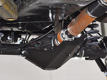

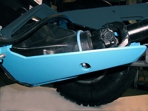

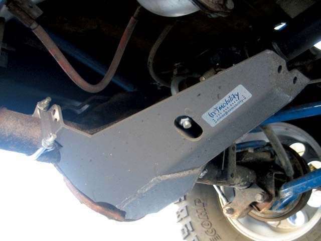

Hey Ken, I came across these two diff skids mounted to the axle tubes and pinion housing ...
- aev-nth2420.jpg (22.33 KiB) Viewed 4533 times
- slider 2.jpg (16.91 KiB) Viewed 4533 times
- GunniPWguy
- Posts: 954
Re: Group Buy of Iron Pig Off Road Rear Diff Skid
Who makes those? I kind of like that no drill/u-bolt installation method better. Don't neccesarily know if it IS better. Just looks like an easier install.
here is another one
Here is the link to AEV...
http://www.knowwhere2jeep.com/extreme-o ... lider.html#
I remembered I'd seen this type before and just started searching online.
With the skid up tight to the bottom of the diff and the mounting points are there to locate and secure the skid only, the majority of the impact force would be on the diff housing. It's pretty much the same as Ken's idea but a no drill install.
Ken, what do you think ?
Yep, I saw both of those designs before. The first one is from AFE (I believe). I wrote them about it and they said that they did not plan on making one for the AAM 10.5 any time soon. The second one is by Nth Mobility (for XJ's & such) and I actually sent a picture of that one to Iron Pig as a starting point for the design. They liked that one. That said, when I showed up for the truck after they completed the prototype, they had gone ahead with what I currently have. The only problem with the U-bolt type for our diffs is that the flanges on the sides are so wide that it would require the u-bolt to be really wide or in an awkward position. Now maybe it's possible to have the u-bolt on ours very near the pinion, so I guess that's option. Also, because the rear part of the diff is so wide, it might require the whole skid to be monstrously wide back there, and of course heavier. You guys are right....something like this would be a much simpler installation and not require drilling holes through the flanges/webs. I guess it may be worth talking to the Iron Pig guys again very soon and seeing if the u-bolt option couldn't be revisited. Vice that, I guess the path will lead to getting the brackets that run to the flanges at the pinion end shored-up to address the potential of cracking the flanges at that point in the event of a hard strike near the pinion. I definitely at least plan to have that taken care of. Plus, I think the current design needs to have steel welded to the skid in between the skid and the pinion end to act as a bridge and "fill the gap", to keep it from deflecting and possibly cracking the webs. I'm up to my ears with job-taskers right now, so I might not be able to give this the attention it deserves until this weekend. I'll try to contact them this coming Saturday.
