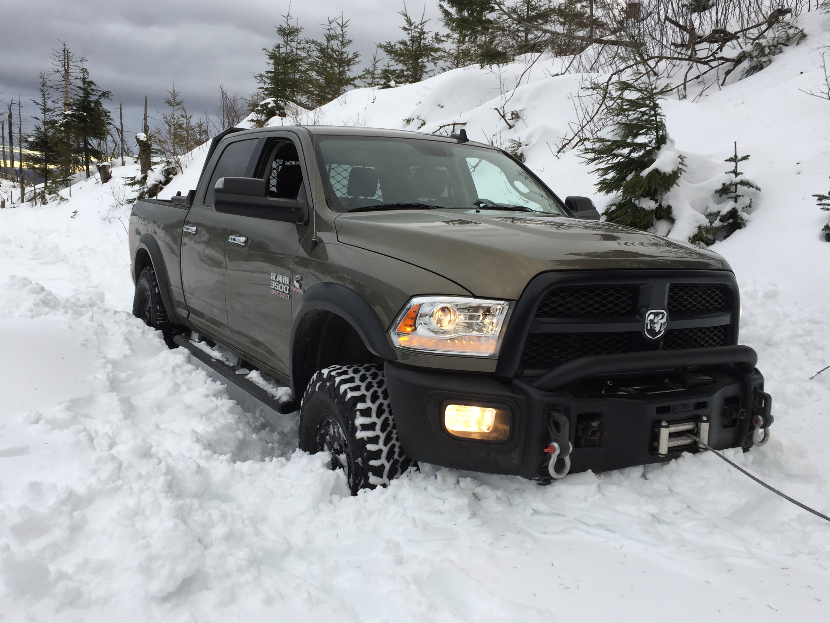

This is the same EGR flare on my CTD and you can see the width and such a little better in this photo. This is the "Rugged" style of the EGR. They also have a narrow OEM style as well as the larger "Pocket" style with the riveted look.

Dayum, looks like quite a bit of fairly wet/packy snow for sure!!!
Be honest. Which rig do you enjoy more, your ctd or pw?

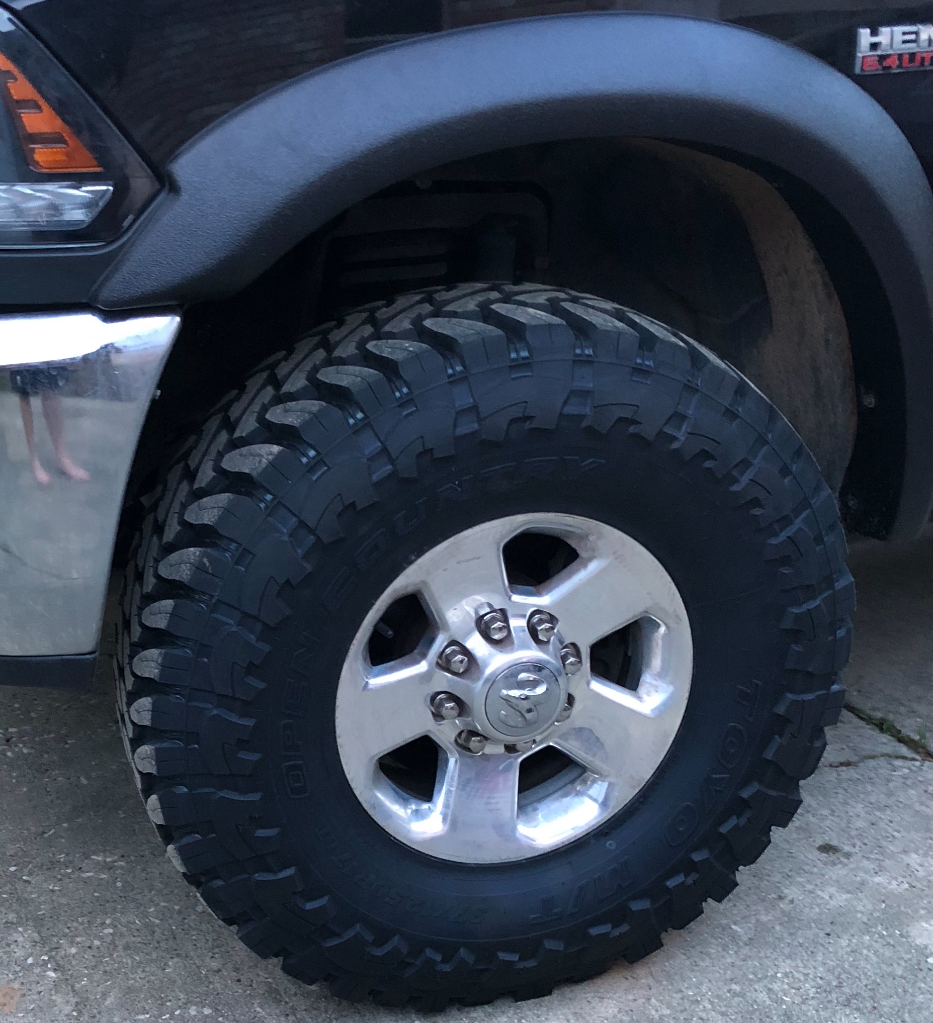

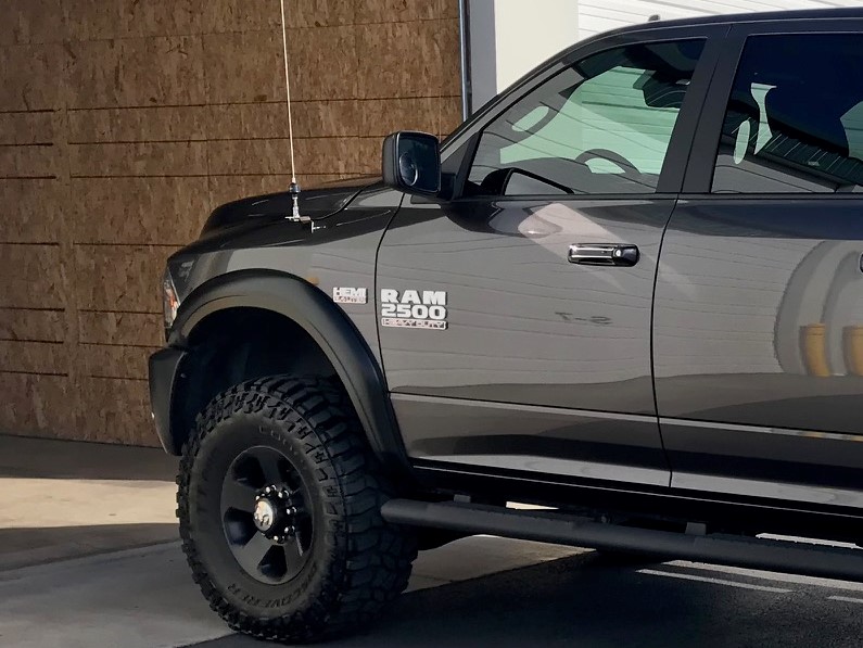

I bought the Amazon EGR flares and thus far I’m liking them,I bought the sand-blasted black.

Does it stick out too far with oem wheels?

It's not bad. But, could you post up a picture further back, showing the whole truck with them?
I have the factory flares and I'm running those same tires on the stock wheels, don't feel like they really stick out at all.

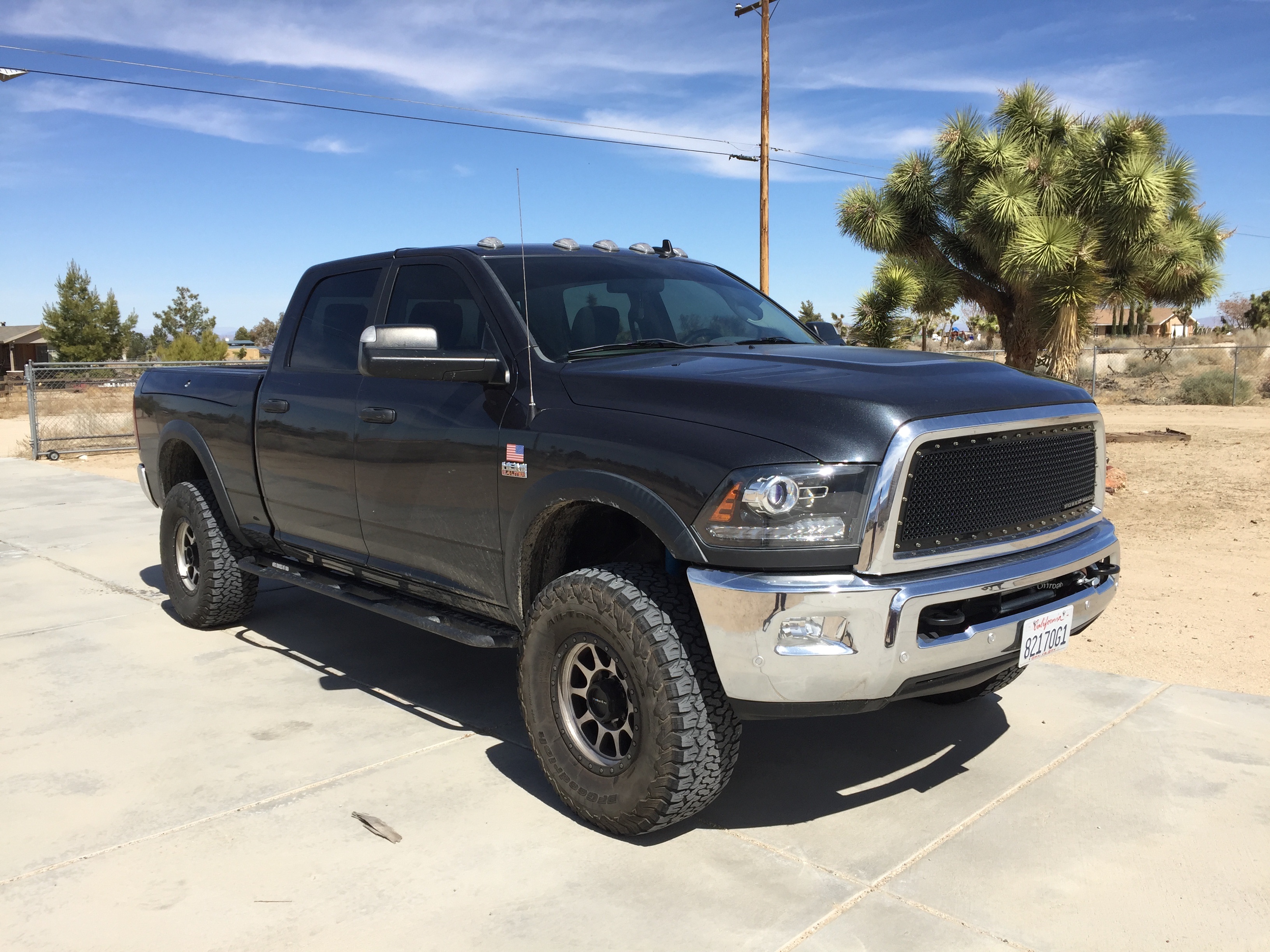

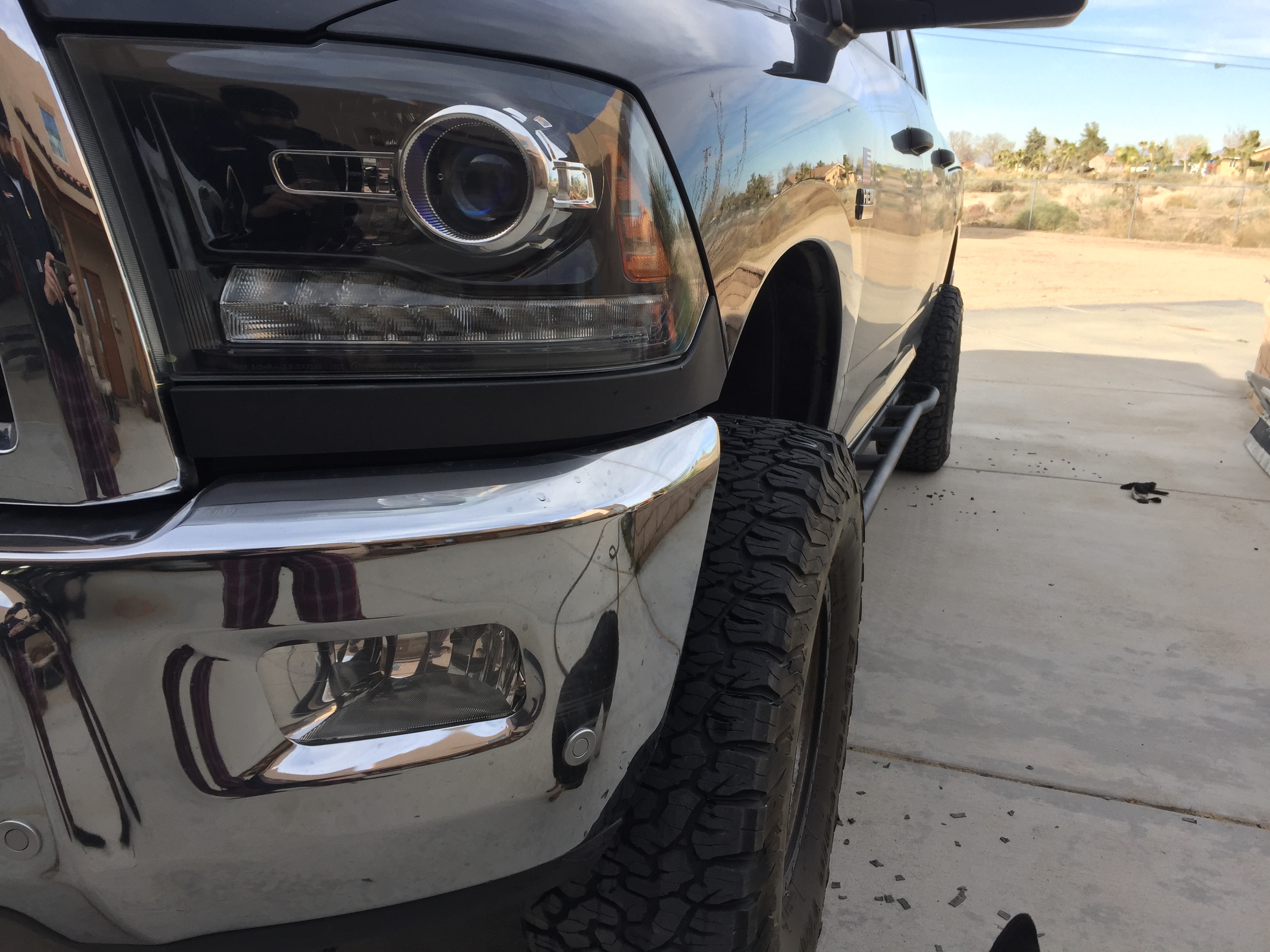

Here is my take on flares... If they fall off your truck repeatedly even after being replaced under warranty several times, they belong in the trash! :evil:
But these trucks look funny without them in my opinion, especially with a wider offset wheel like my Walker’s. I’m waiting on a few more pieces before putting my new ones on and will have pics “soon.”
Though I agree they do very little to prevent damage, strictly an aesthetic touch. Speaking of things falling off my truck, just finished supergluing my Rambox panels back on for the 10th time or so... Adhesive tape sucks, and so does the engineer that designed these Ramboxes. :angry:

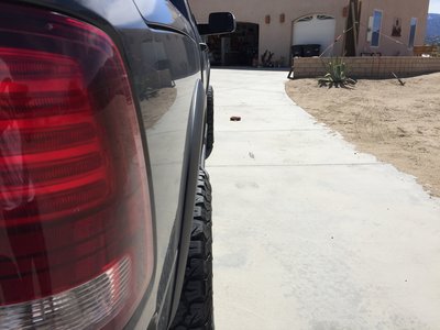

I will post a pic from side and top tomorrow. The flares stick out a little further than the tires about an 1” or 2.

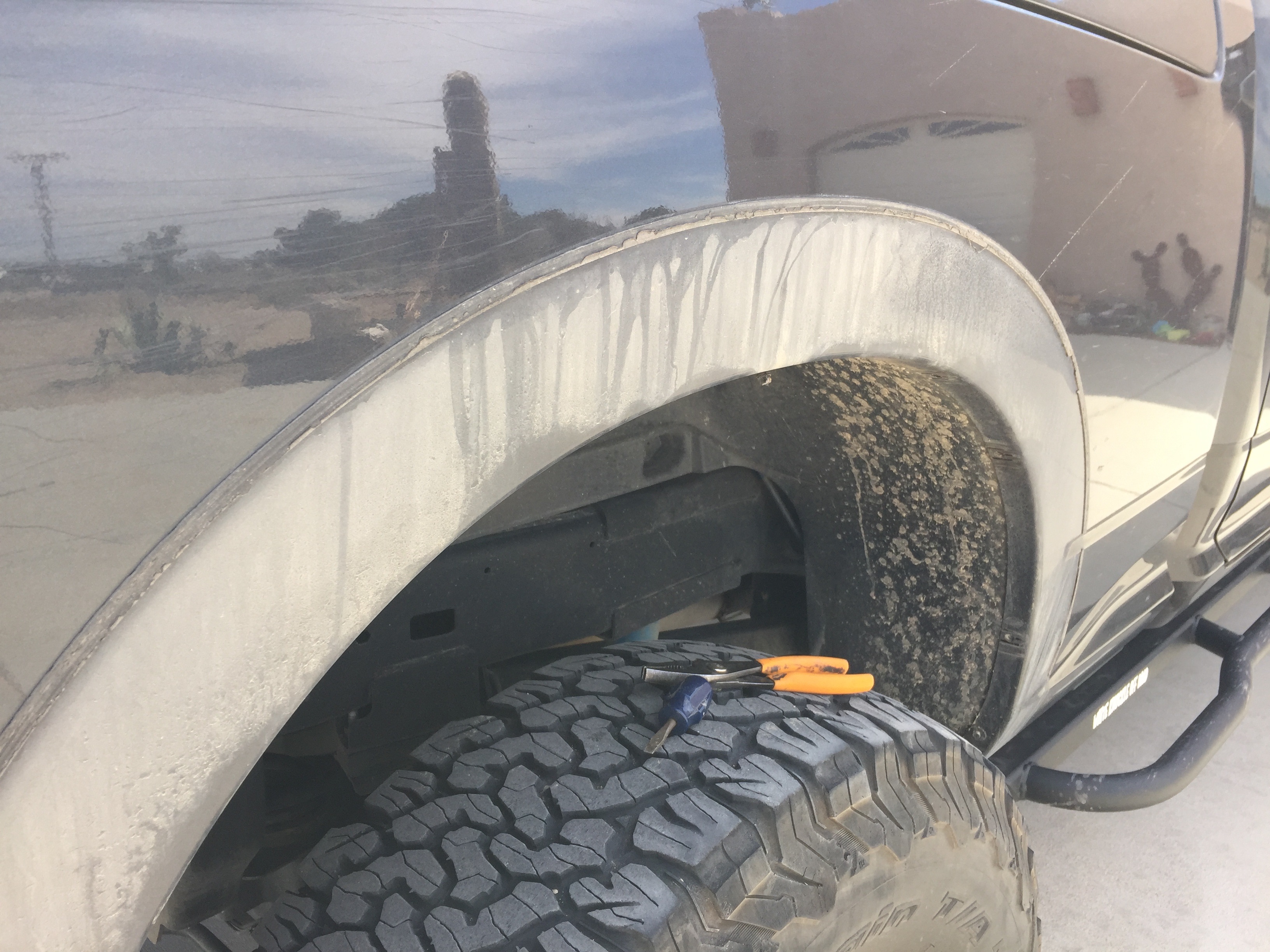

Chromolykid, when the flares come of our trucks what is under them? Is the paint rubbed away? I considered taking them off but I was worried about the paint being already screwed up with 15k miles on the truck.

Yes, tape of some kind is a must under a standard flare. I understand why Ram chooses to use tape, but it doesn’t work well on their unpainted flares, not for long anyway. Go to a local dealership and look at any truck with black flares on and I bet you will find at least one starting to come off. My folks’ brand new Rebel has the same issue already (side note: their Ramboxes do not have the same issue because they are designed differently on 1500’s with retaining tabs in the upper corners). The painted flares don’t seem to be nearly as bad, but I hate that look personally. Either they’re mounted incorrectly (taped first and then bolted) from the factory and dealerships or they’re molded with too little tension to keep them tight against the body. Likely the first scenario, but if I don’t like the new ones I can re-tape the old ones and try a proper install to see how they hold up.
I haven’t taken my factory ones off yet, waiting on a couple more pieces to a bigger project that includes the flares. I highly doubt the factory ones will have left any rub marks with the tape. Not too concerned anyways because the new ones are bigger and could actually almost be bolted on over the existing flares. I’ll post pics soon.

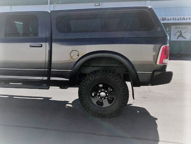

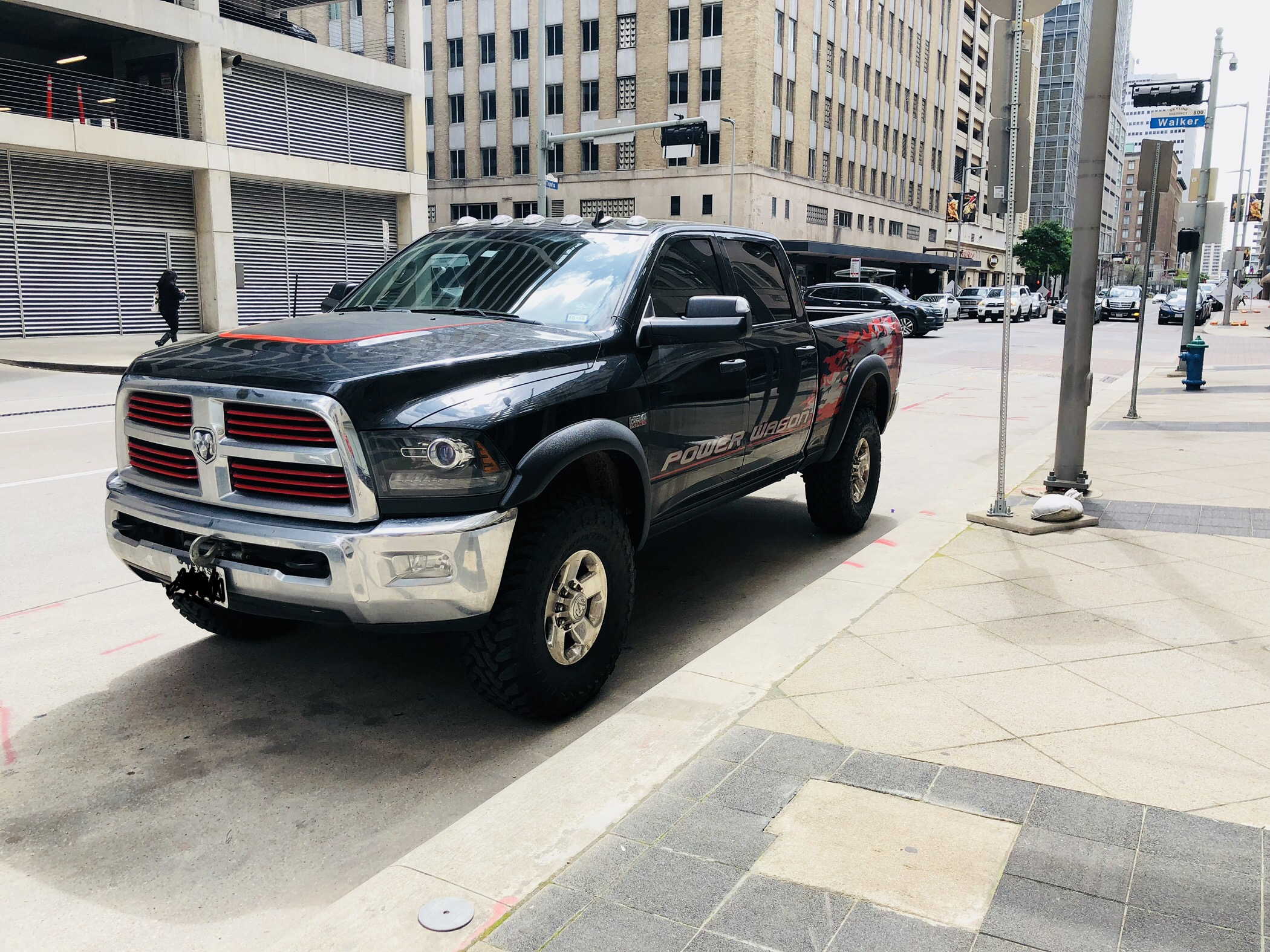

Here’s a photo from downtown.

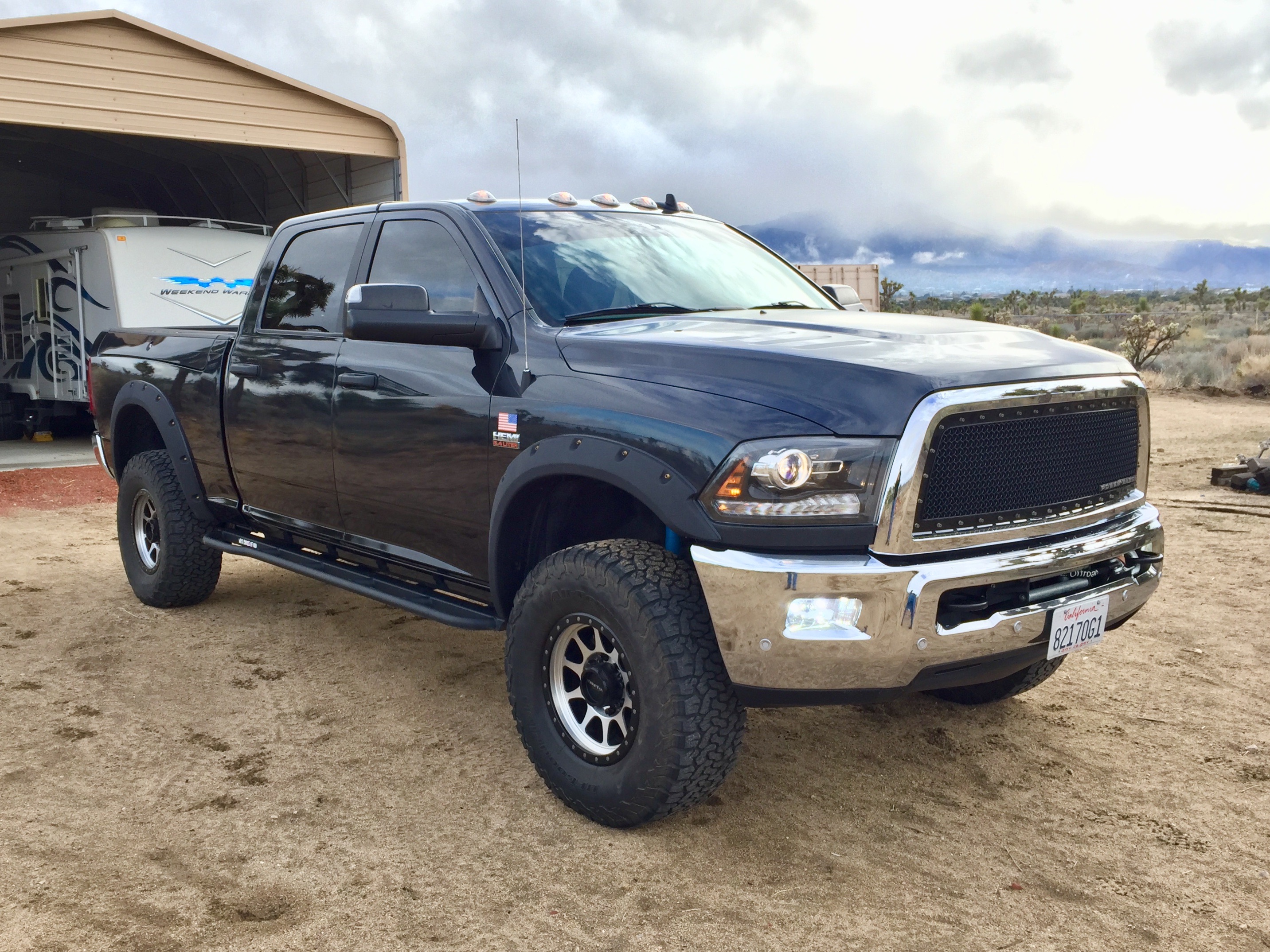

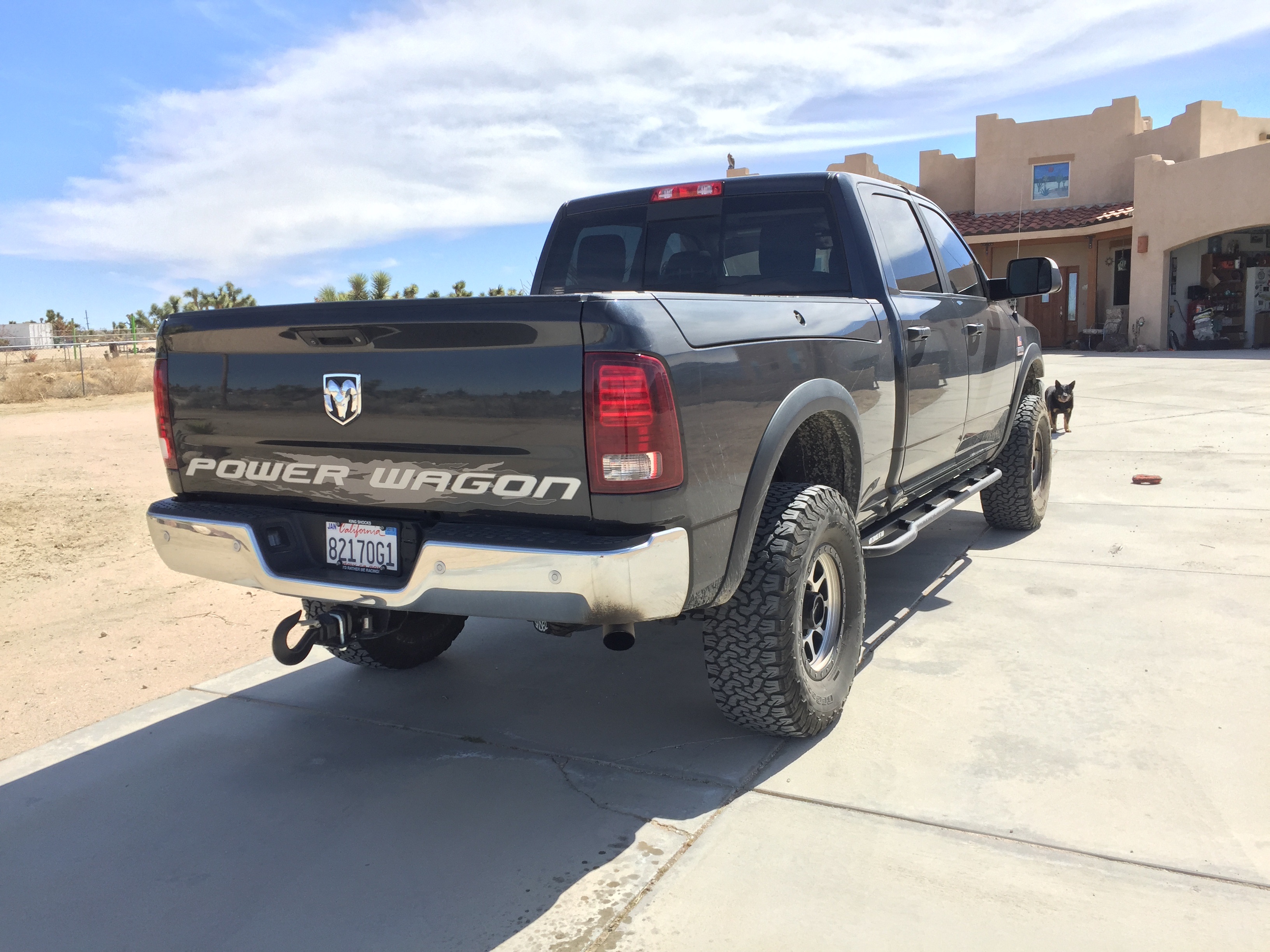

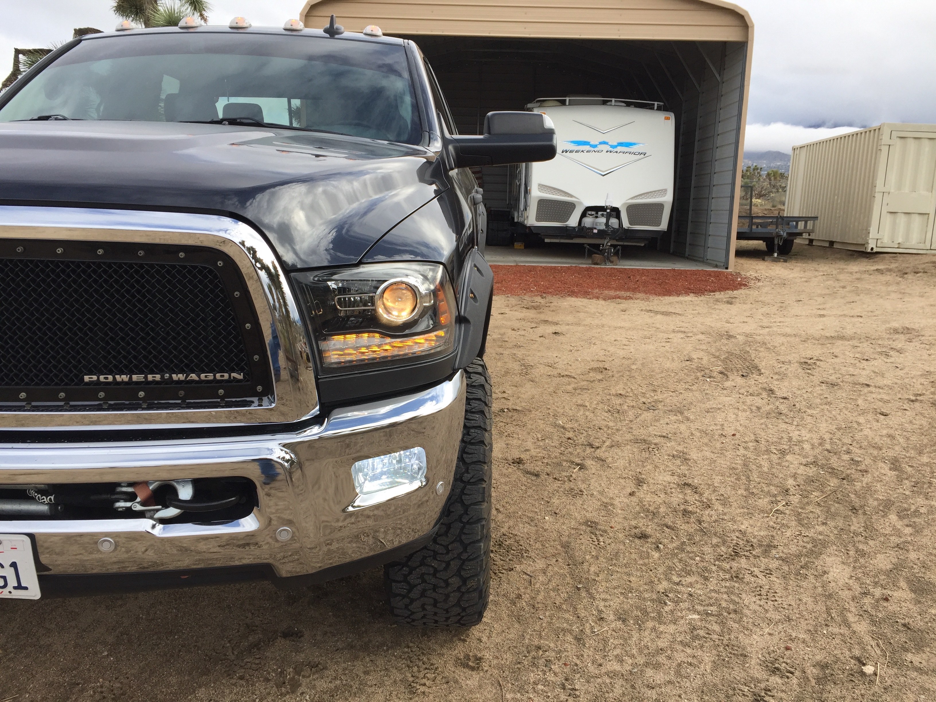

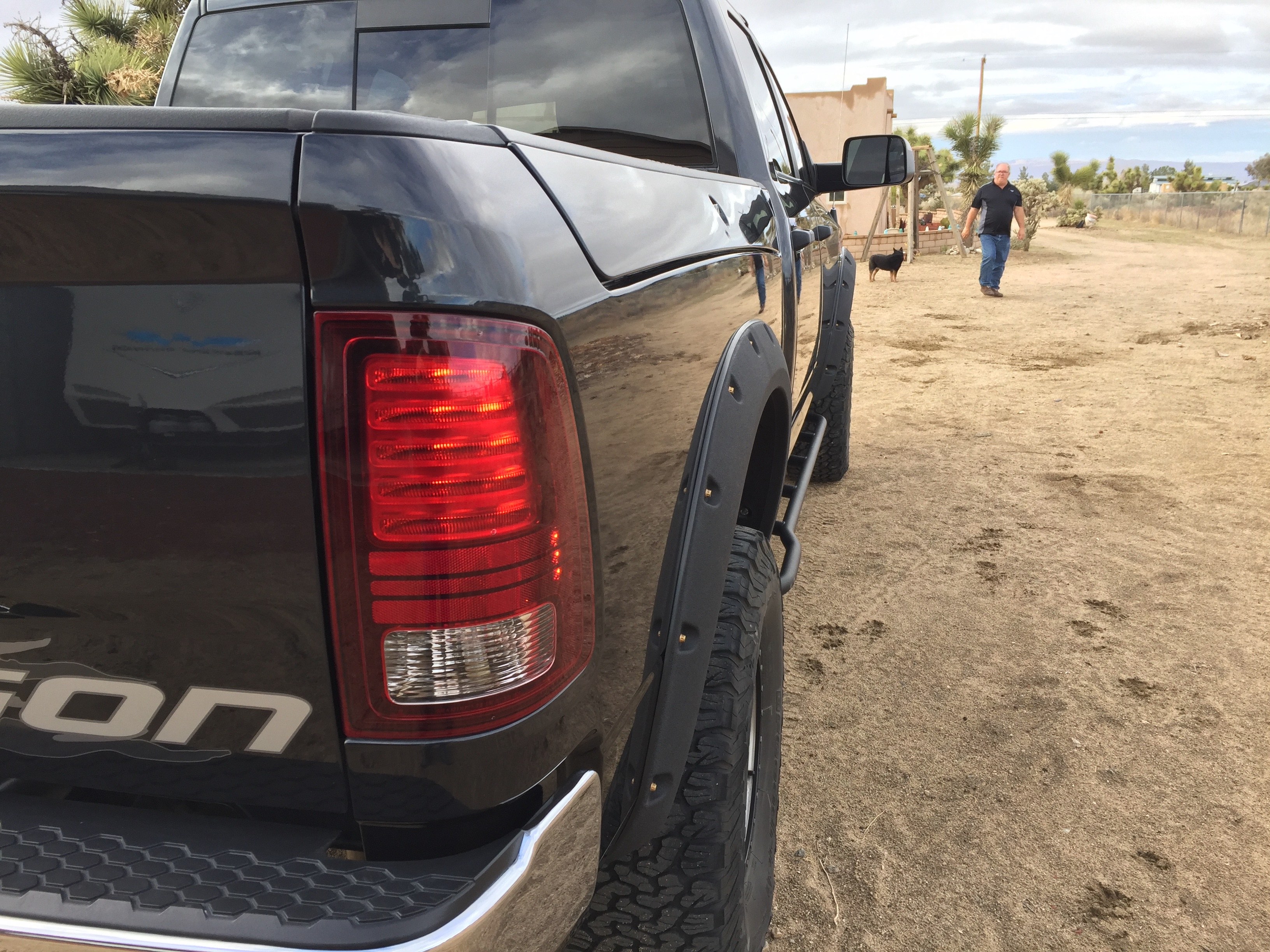

Finally got around to installing the flares after spending half a day removing the leftover tape on the truck. It was completely separated from the flares, but stuck pretty well to the body. Thank 3M for their eraser wheel, that thing is awesome. Anyways, here is the finished product. I'm usually not a fan of pocket flares, but can tolerate these for now. They cover the wider offset Walker wheels nicely. I ditched the gaudy giant chrome button head bolts the flares came with for coated stainless double hex aircraft nuts over black set screws to look a little less flashy and match the 12-point aircraft bolts in the grill. Putting 3M clear film strips under the flares was the most time consuming part, but worth it to save the paint. When I get tired of these I think I will try those EGR flares, they look nice.

Came out nice, those wheels look great on your truck!
