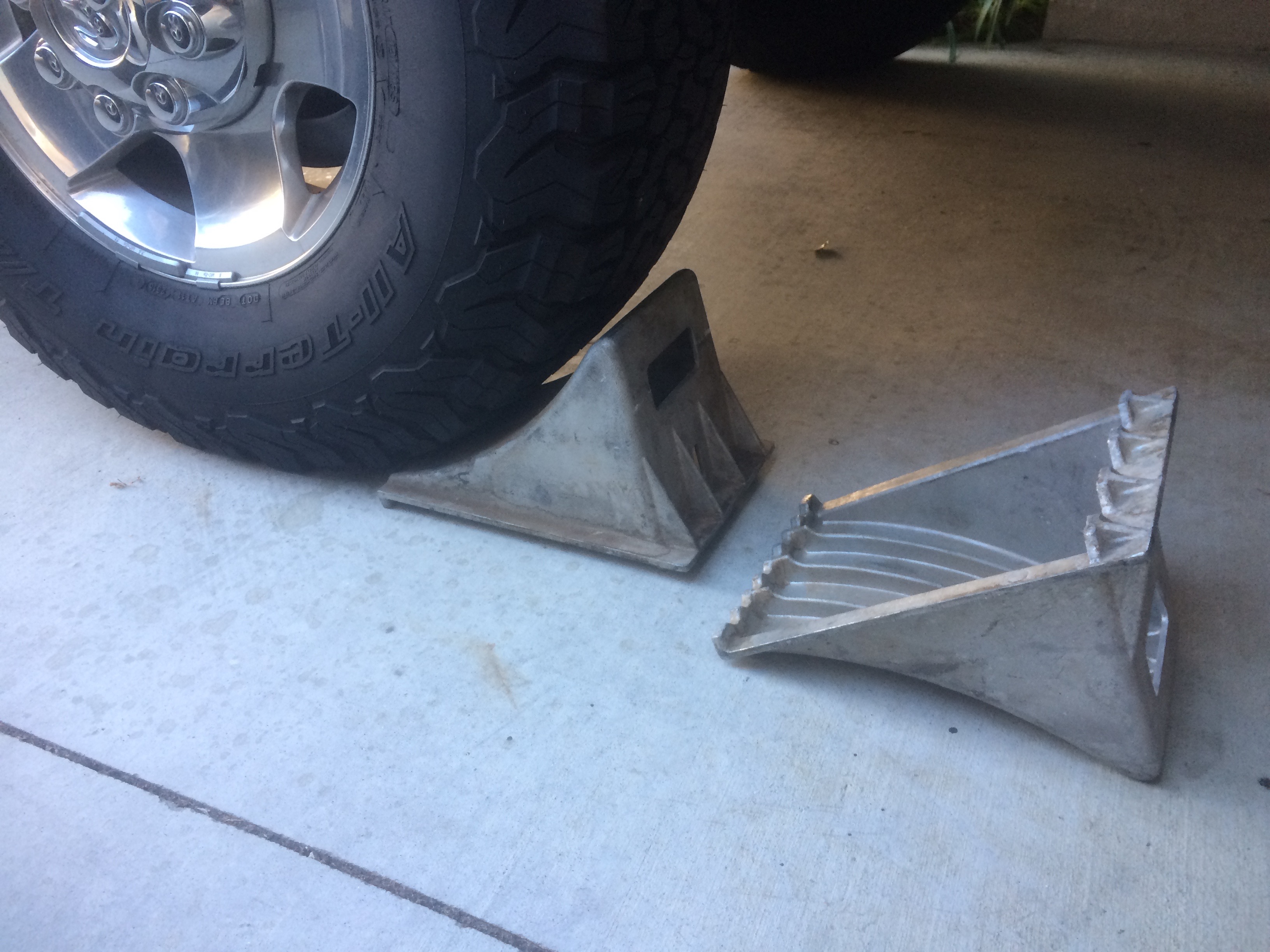

Here's the chocks I carry. 12"X8"X8"
The rule for wheel chocks is that they need to be taller than the sidewall of the tire they're holding.
The problem with these, because they're hollow, they can sink into soft ground.
I've had them for about 20 years, so I know they're not made in China.

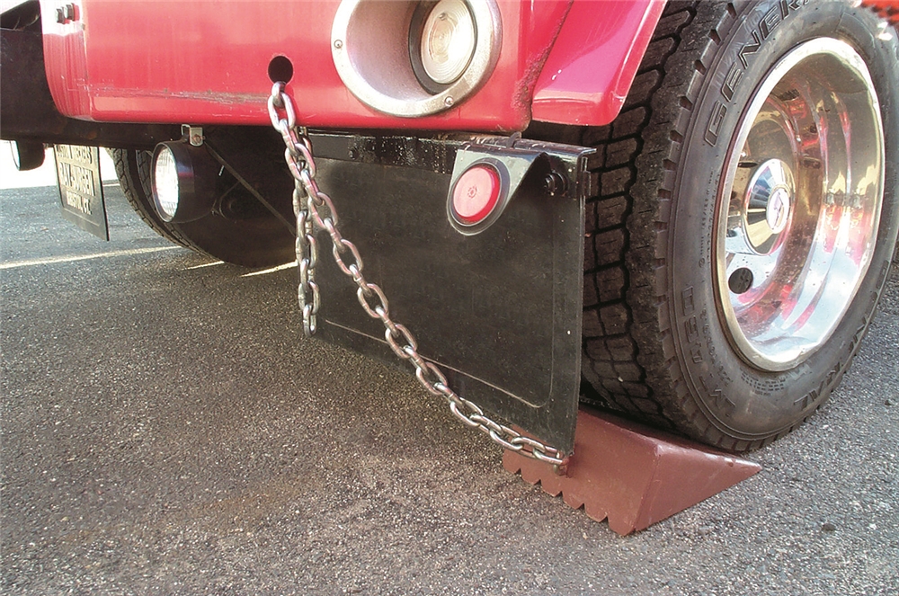

This is the type of wheel chock tow trucks use for heavy winching. They chain to the rear bumper of the truck, as the truck gets pulled on top of them, they dig in and move with the truck (if it moves at all). The Highway Patrol hates them, because they'll ruin a section of asphalt in nothing flat.

Yes, those are the good ones. Hard to find them anymore, ESPECIALLY Made in the USA, for a reasonable price. The good ones are

Not sure I'd feel safe doing that. Those bumpers aren't that strong. Maybe connect to a bull bar / brush guard off the frame? Am I missing something?Retired BLM Rig wrote:Here's the chocks I carry. 12"X8"X8"

What you are missing is this: 95%+, tow trucks are on blacktop or concrete when winching. The tow truck IS the anchor. That is the perfect scenario. And generally, tow trucks are more HD everywhere than a standard pickup. Off-road throws a whole new spin on things, as there are just so many variables. Those hollow ones with teeth would be almost worthless in the mud, unless you dug down to solid ground. But then again, so would mine. Off-road, many times, you are winching yourself out & chocks are not needed. But yes, I have seen tow trucks use those, and even move with the truck. They work and they do wreck the surface when they move with the truck.
Re: Winching Question
The back end of a wrecker is made for that purpose. They have chain slots cut in to use, as well as hinged d-ring type anchors. Our bumpers, not so much. You would need a purpose-built bumper.

Ah, I gotcha. I wonder if a bull bar or brush guard would suffice if it was strong enough and attached to the frame.FirerescuePW wrote:The back end of a wrecker is made for that purpose. They have chain slots cut in to use, as well as hinged d-ring type anchors. Our bumpers, not so much. You would need a purpose-built bumper.

I really dislike the cast hollow aluminum chocs. They are what we used on the fire department, and I can tell you firsthand that if you drive over one of them, they tend to grenade. We had two pop at once when a guy in training drove over them and as soon as the truck started to rise over them, they just went *bang* and threw shrapnel. Nothing got hurt but the chocs, but I'm more of a fan of something more serious. If you could buy a set of repurposed-rubber chocs and applied some type of stake to one side, you could use one side on asphalt for driveway repairs and one side off-road for traction.

Nope. Both of the things you listed tend to mount to the lower radiator support or worse. They usually tend to be incredibly weak. Very few guards are actually structurally sound. Those are usually the expensive ones. Most are for appearance only and mount with two tabs:zak.salhab wrote: Ah, I gotcha. I wonder if a bull bar or brush guard would suffice if it was strong enough and attached to the frame.
