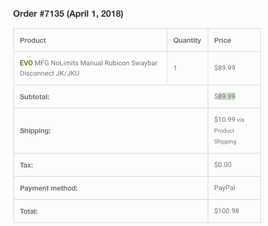

Re: Locker Bypass
They raised the price on that thing by about 10 bucks vs what I paid back in April.
If you're clever you could just make one yourself, it's literally a plate, with a screw that pushes the plunger or whatever you want to call it, inwards to disengage the sway bar. It's all mechanical. This could be made very very easily. Maybe cheaper than 98 bucks, but 98 bucks less any hassle/effort on your part too. So that's up to you on whether that's valuable or not.

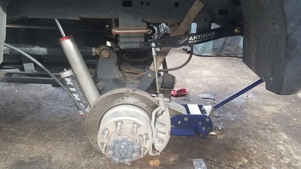

Re: Locker Bypass
Like I was saying...
So Chris did the rear sway bar, I told him to do the front... The report so far is good. We're going wheeling this week. I've been in Moab since Sat, Chris will be here later tonight.
