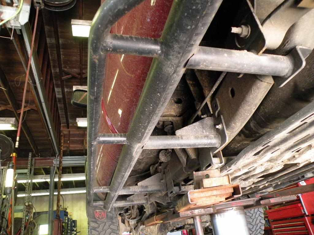

Zlaayer wrote:
Thu Sep 27, 2018 6:09 pm
Thu Sep 27, 2018 5:58 pm
Zlaayer wrote:
Thu Sep 27, 2018 5:16 pm
What's wrong with the factory running boards? They aren't rated for that kind of thing? I was actually looking at the Amp Research Powerstep. It looks like it would give me better clearance but I'm concerned that it would take too much damage in the event that I did end up doing a little rock sliding with them.
Any running board will not hold up to offroading very long. They will get ripped off on the rocks. Just ask Firerescure. :rofl: I seen his come off. I seen the Amp steps get damaged and not work afterwards. The running boards bolt to the pinch weld on the body. That's not a strong point. The WhiteKunckle sliders bolt to the frame, and are built to take a beating on the rocks. Plus they have a nerf bar that is used as a side step. They will protect the under side of the cab.
Won’t I lose like three inches of clearance though?
I can't really comment on this. As I have a 3G, not a 4.5G. On the 3G's. The frame is lower then what the body is at the doors. So the rock rail is at the bottom of the door but even with the frame. I'm not sure how far down the body sticks down at the doors on the 4.5G.
The pictures are the factory rock rails for the 3G. Which you no longer can get.
