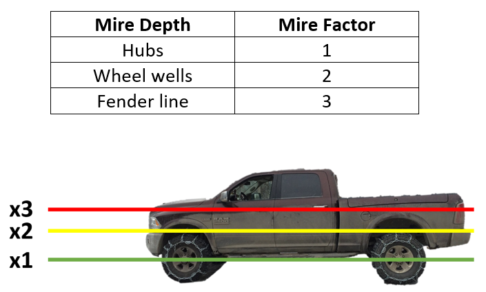

Mire Resistance
Post by Low_Sky » Wed Jul 11, 2018 12:01 pm
Mire resistance is the load on a stuck vehicle imposed by the surface it is stuck on. The resistance of a mired vehicle depends primarily on the depth to which it is mired, and the weight of the vehicle and cargo. Not all surfaces are created equal, but the mire factors presented here are a good starting place. If in doubt, adding extra mechanical advantage won’t hurt. For example; soft soupy mud with a fairly hard bottom will offer less resistance than bottomless thick clay. Fresh powder snow offers less resistance than spring snowpack with a hard crust. The clear exception to the mire factor chart below is being high centered or otherwise hung up on rock. Go straight to mire factor 3. Vehicles with smooth skid plates underneath may drag over rocks more easily, but with the mess of crossmembers, bars, small skid plates, etc. underneath a Power Wagon, plan for a hard pull. The best course of action is to jack the vehicle up and build track under the tires so you don’t have to drag it over rocks in the first place.
Multiply the weight of the vehicle (including cargo) by the mire factor to determine the mire resistance.
Mire Resistance = Vehicle Weight x Mire Factor

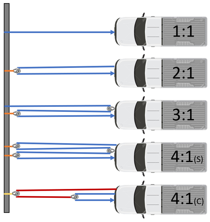

Mechanical Advantage
Post by Low_Sky » Wed Jul 11, 2018 12:04 pm
Mechanical advantage is the ratio of the force applied by a machine to the force applied to it. To determine the mechanical advantage required for a recovery, divide the load resistance by the available effort and round up to the nearest whole number. This first mechanical advantage calculation is an estimate that will be validated later after accounting for friction losses, which can be substantial. Obviously, a mechanical advantage of one is a single line pull, no blocks and no losses involved; required effort equals load resistance.
Below are examples of common riggings for mechanical advantage. Note that in the last example (compound 4:1), this is a 2:1 system working on a second 2:1 system. The rigging in the second system sees twice the loads seen by the first system and needs to be rated accordingly.
Mechanical Advantage = Load Resistance / Available Effort, (round up)
