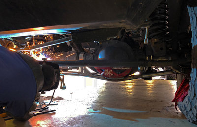

The new trucks can’t take the beating the older trucks could, the front axle is 5 distinct sections and can bend easily. The older trucks bent front axles all the time I’m really hard hits but they could take a lot more and could be bent back. You don’t even have to get air in the new trucks to bend them. I can almost guarantee the axle on that Power Wagon is way bent. The truss is to keep the axle straight and prevent bending and works crazy well.
Re: Thuren 3.0 KING on 2018 Powerwagon!
Also keeps the center from breaking the plug welds and spinning. You don't have to bend the axle to spin the center.
