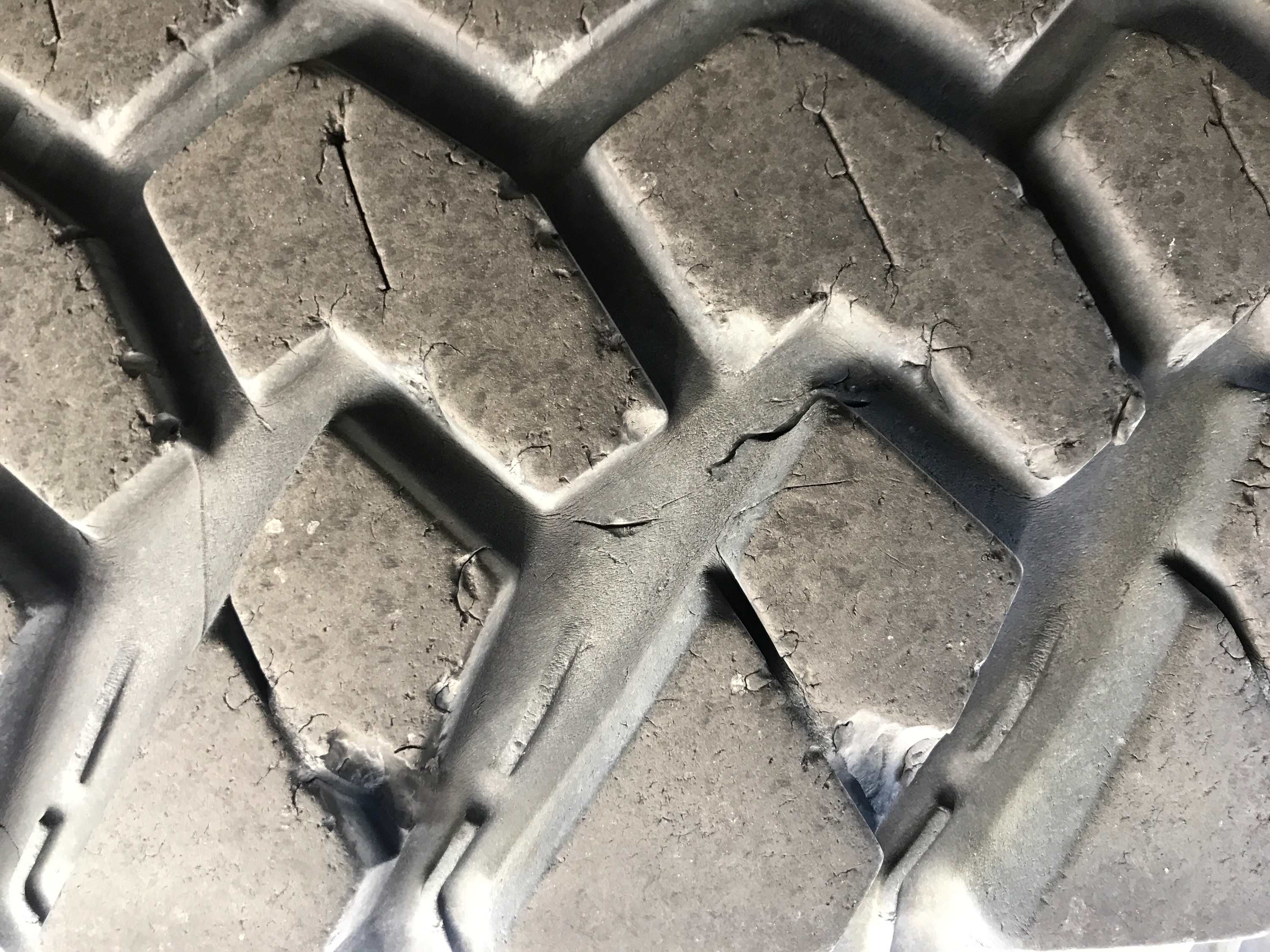

So we've gotten some snow and freezing conditions (big surprise) and I can tell you this about the Nitto trail grapplers
They SUCK!!! Spin out on fresh snow. No traction on ice. Slide everywhere under braking. HOW THE HELL DO PEOPLE RUN THESE YEAR ROUND!!!!
It's stupid dangerous!
I have a new set going on in the next few days. I will never buy another set of the Nitto trails again. Wear way to fast. Crappy traction. And they are tearing apart.
Here's a comparison pic. The Nitto trails have about 25k km on them.
The cooper st maxx have 60k km on them.
Same drive same roads same speeds. I won't be buying toyo products ever again

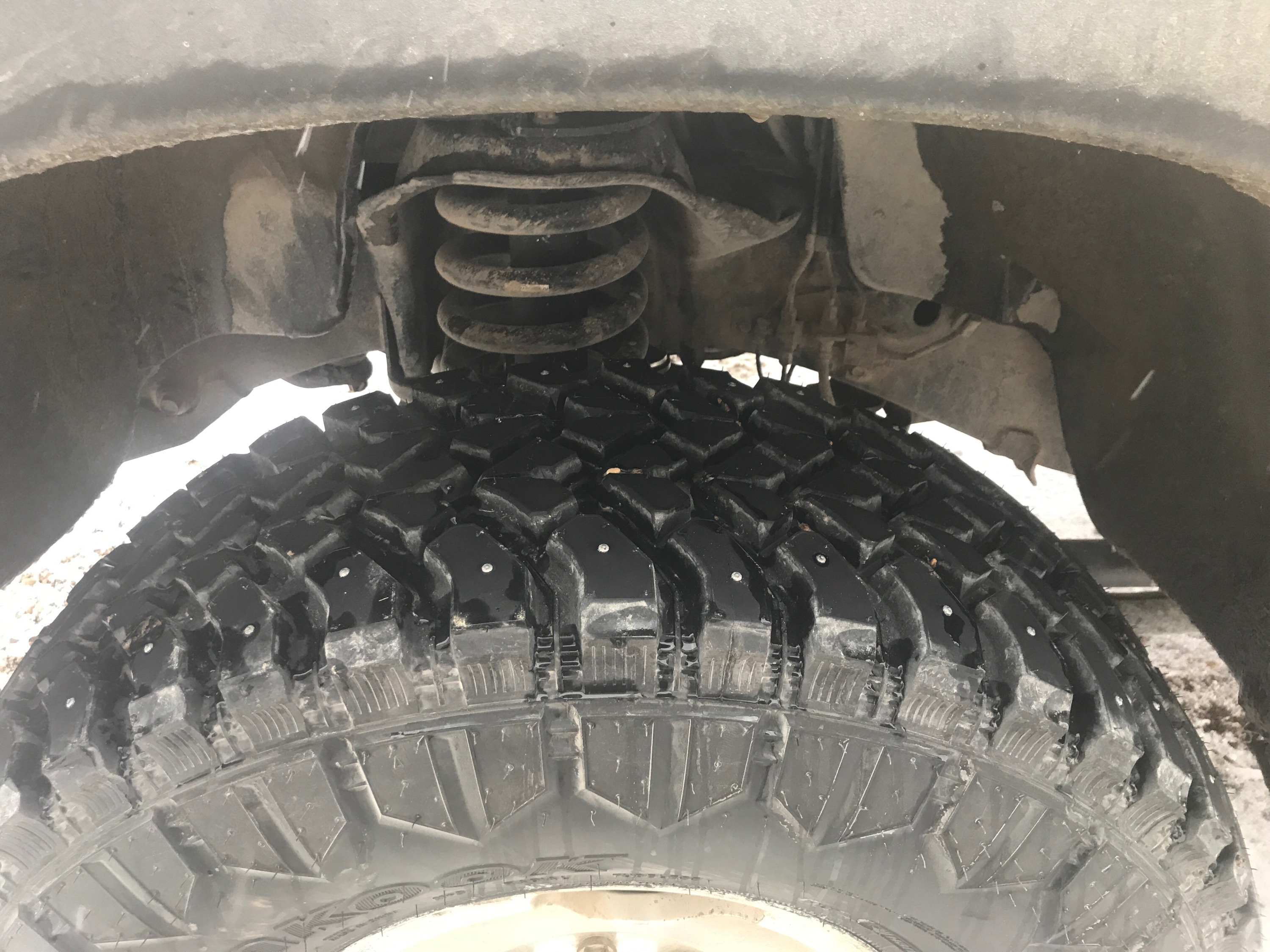

Post by nts007 » Fri Nov 03, 2017 9:22 pm
Problem solved. Finish wrecking the nittos next spring. Been snowing for days here now and hovering at the freezing line. Lots of ice. Much safer now.

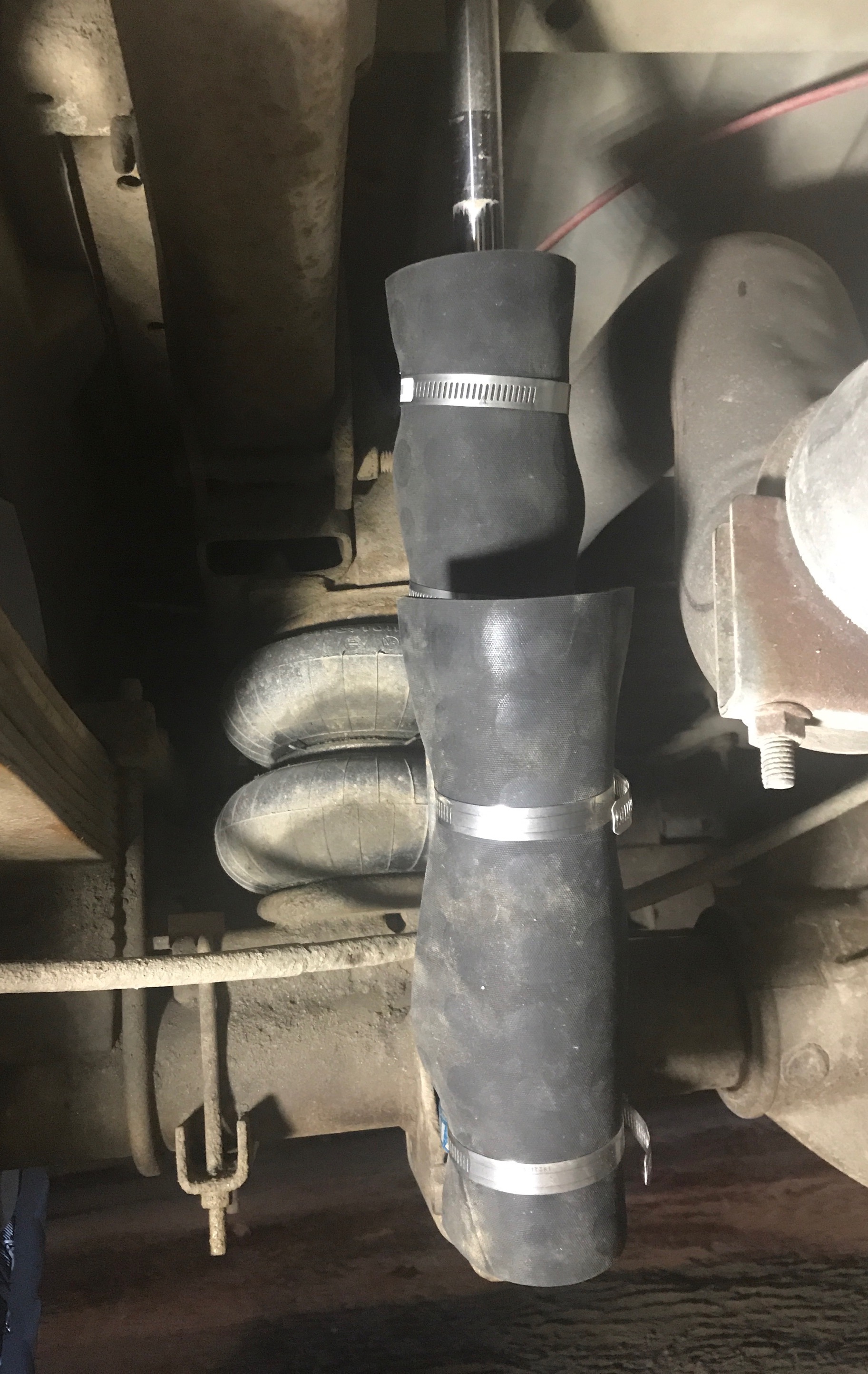

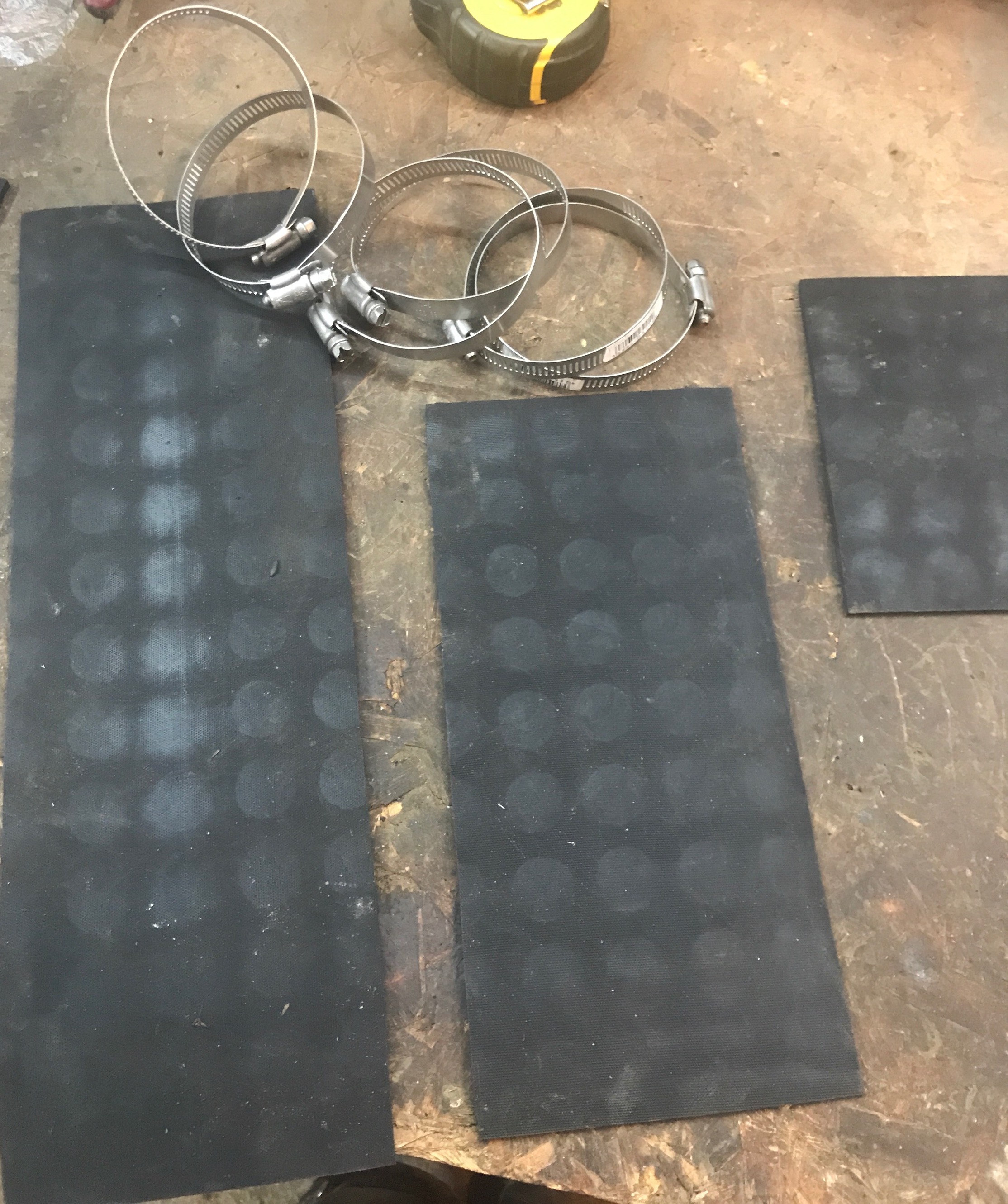

Worked a little on the kings today. Just the rear. Pulled them and changed the compression valving a bit. Trying to make it softer over the frost heaves. Still not quite good but defiantly an improvement. When I get bored I'll pull them again and make minor changes. These body down resi setups are just taking a beating. Body's are gouged and beaten from rocks. Hate to say this but I think the 7100s are slightly better quality in some ways. Oh well it is what it is. Going to have to keep on protecting them.
Made some rubber guards that should help.

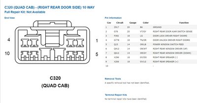

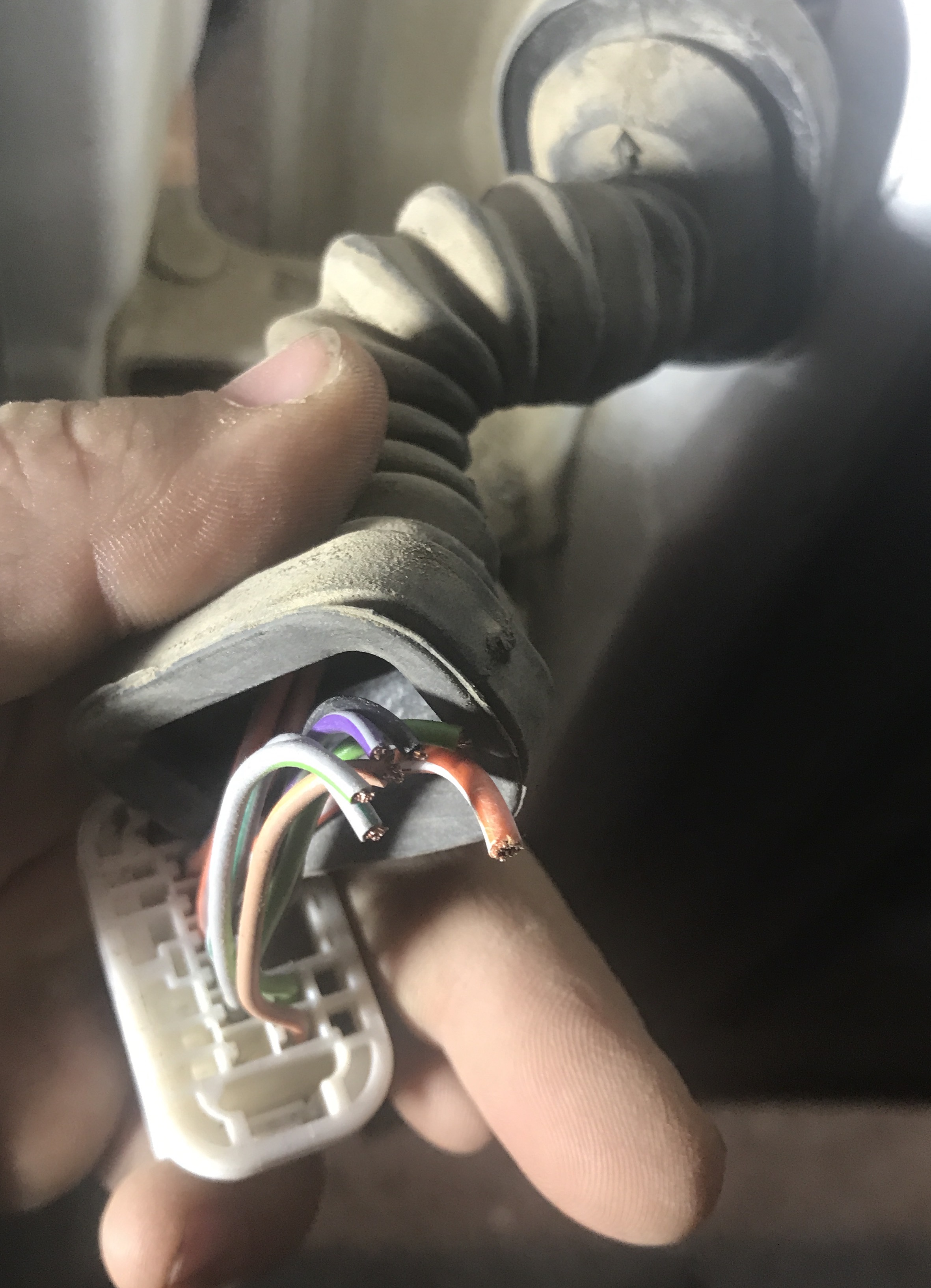

After 2 years of no rear door lock and power windows. Finally decided to look. :( :doh: I knew a wire was broken. But jeez
Re: Diesel PW Build Thread
Post by nts007 » Sun Jan 14, 2018 4:12 pm
One cluster f of wires done. Hope it lasts.

I fixed my drivers side rear door wiring twice and the passenger's side once the original drivers side hardness final gave up the ghost and had to be replaced a couple of weeks ago.
The problem is Dodge used various gauges (14-20) of wiring in that harness and the thinner 14 gauge wires break from opening and closing the door.
Post by nts007 » Sun Jan 14, 2018 6:00 pm
I ended up making the wires all 5" longer and put them in a loop. Minimal hinging on wires now more of a twist. Seems to be working

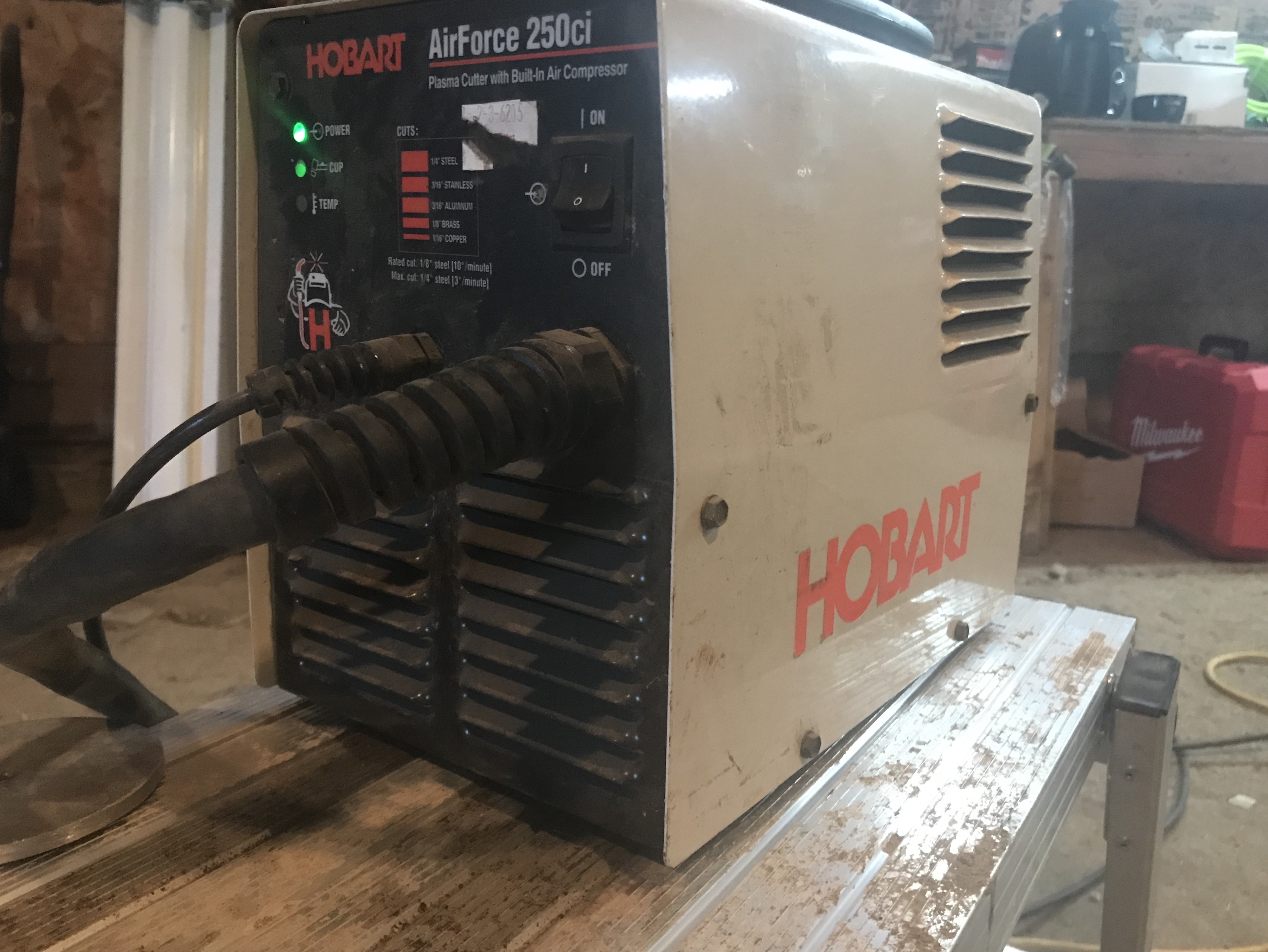

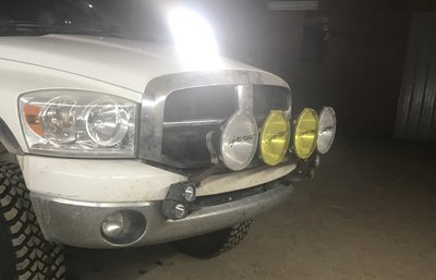

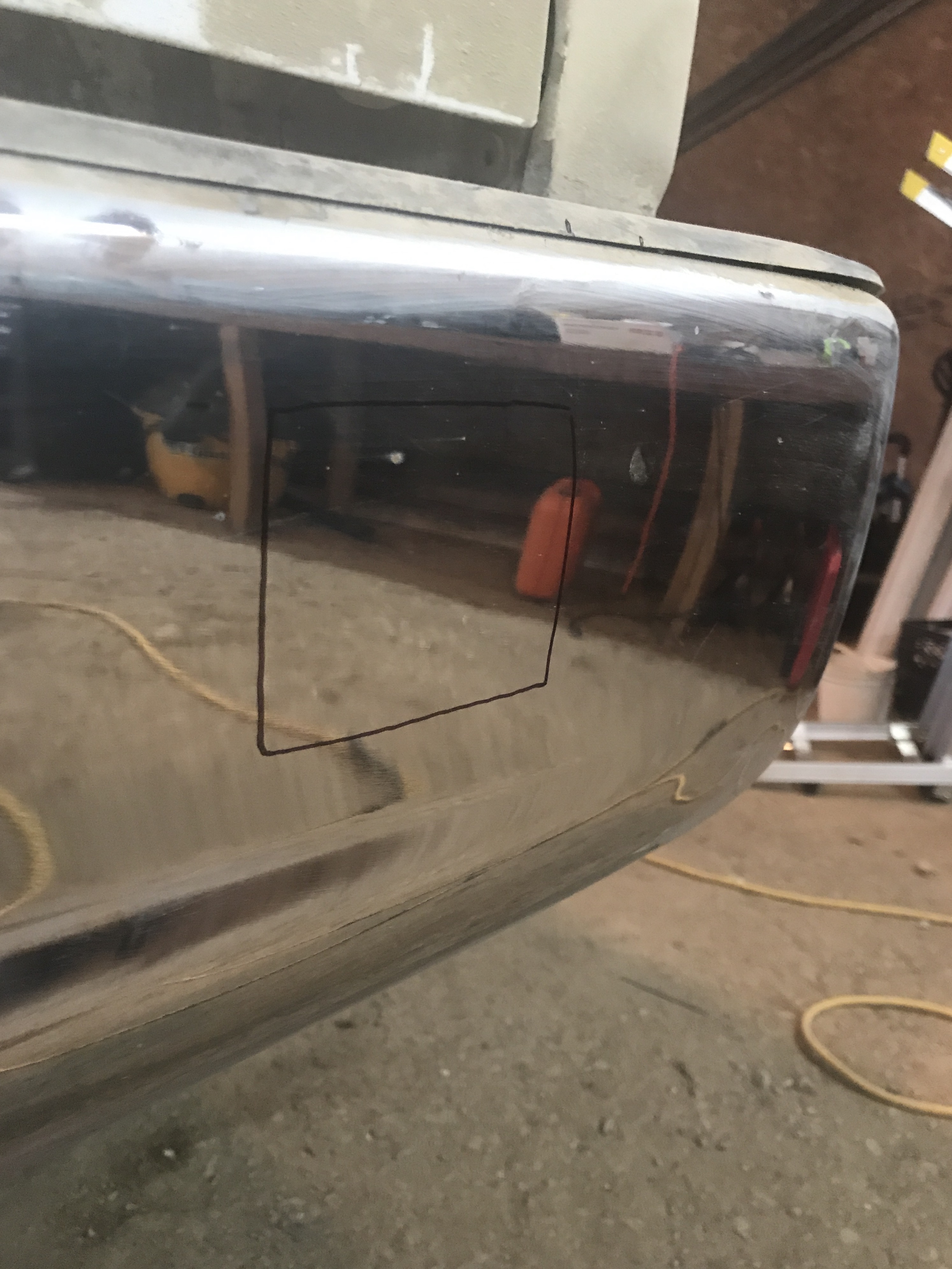

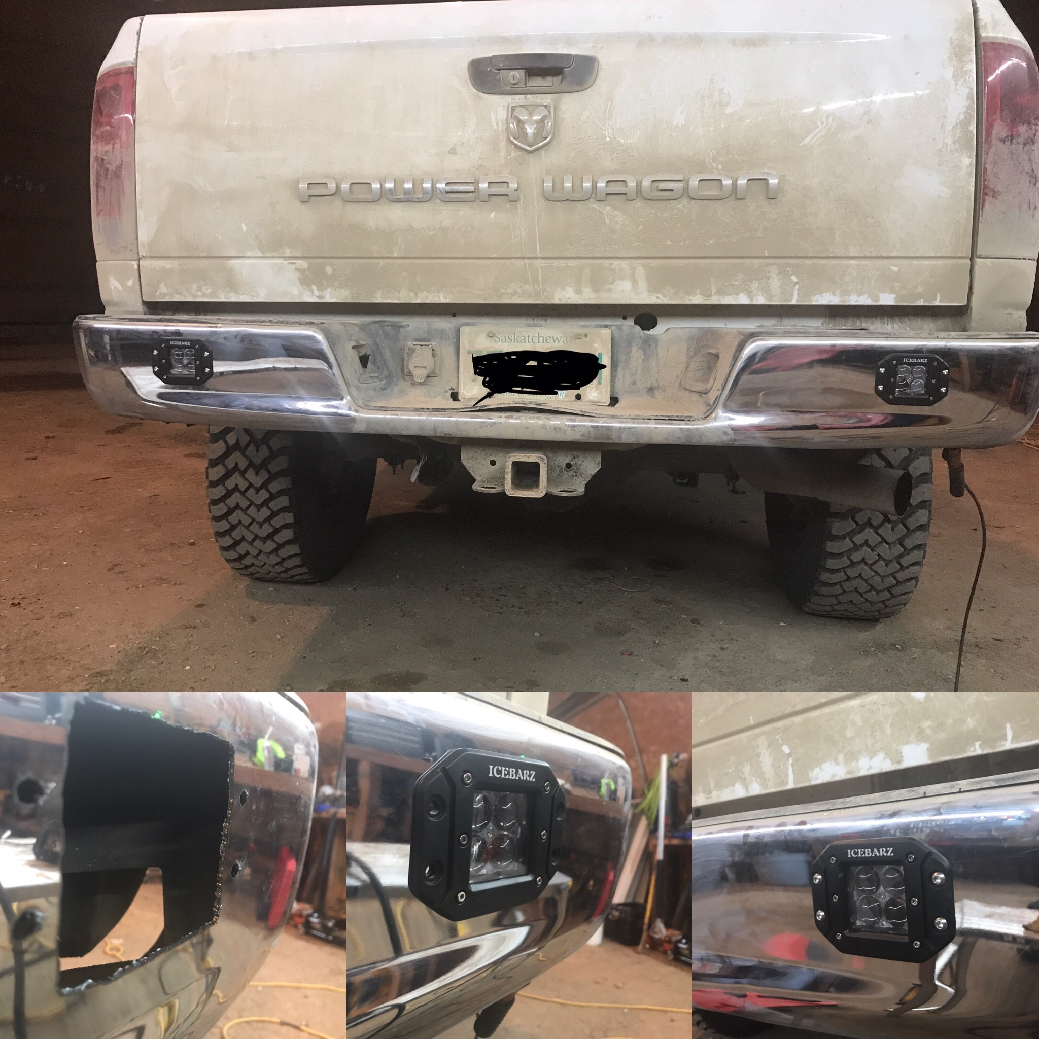

Small update. I picked up a used plasma cutter yesterday. BEST THING EVER!! And finally installed my aux back up lights! Instead of an hour grinding and drilling it was done in 5 min. 👍🏻👍🏻

Beam shot of the reverse lights

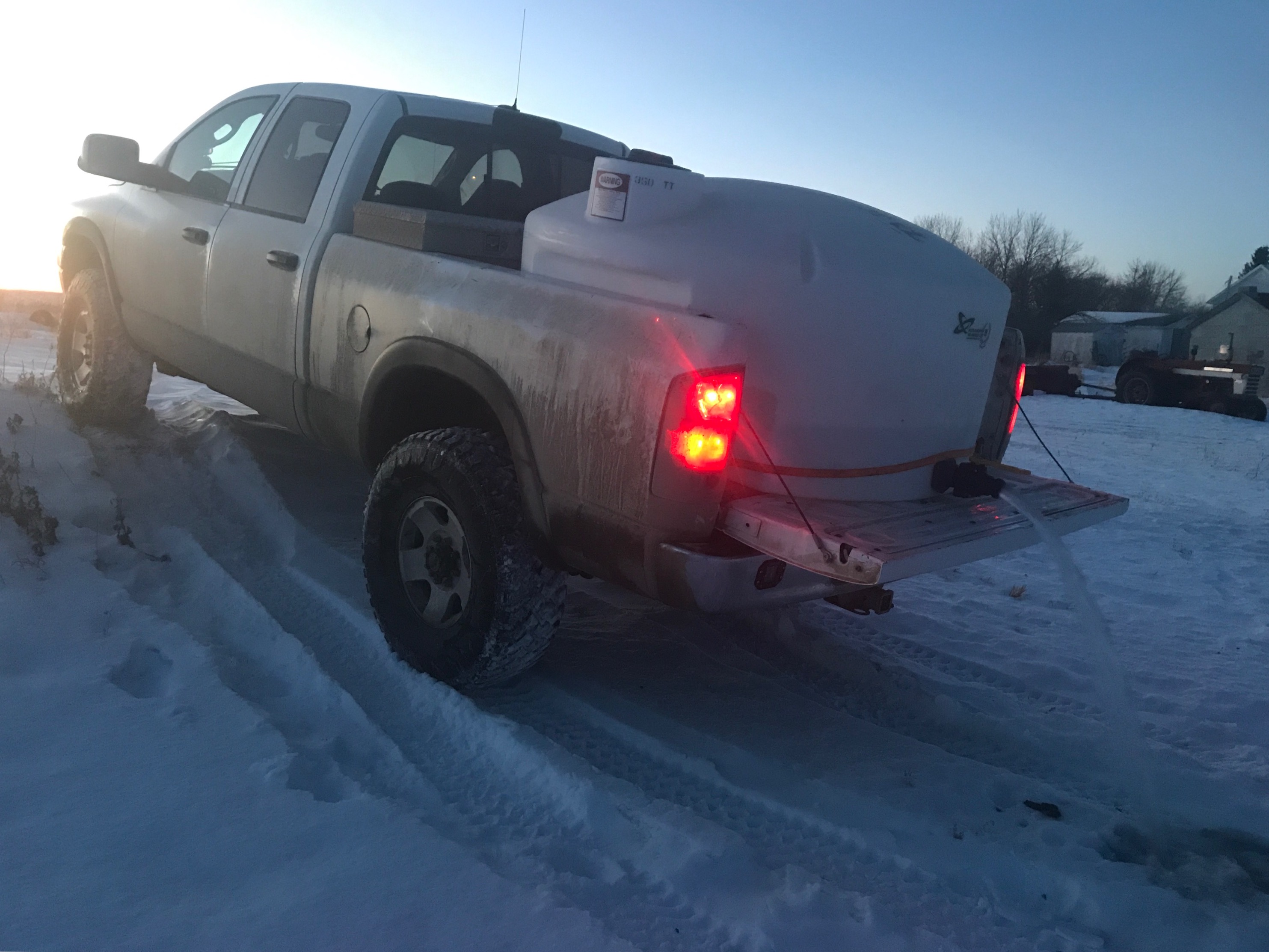

Also been having to haul water a lot lately. Had to drain bottom of tank so it doesn't freeze hard. So find a small hill and go lol

Post by olyelr » Sat Jan 20, 2018 7:22 am
WOW, bright! Do they come on when the truck goes in reverse, or wired separately on a switch, or both?
Post by nts007 » Sat Jan 20, 2018 8:19 pm
Wired them into the reverse circuit. Seems like work to have to remember to flip a switch lol
