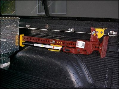

I’ve seen a few pics of those hi -lift and shovel mounts that go on the inside of the box. Has anyone used them? And which company were they? I hate listening to my shovels and axes sliding and banging around in the back of my truck.

Years ago I had my Hi-Lift mounted to the tool box, but it was always in the way when I loaded the truck. I think Hi-Lift sells a mount similar to the pic above, and some of the rack manufacturers have their own versions. I bought one that was nicely welded and galvanized, very heavy duty, but then decided to make my own for the box. That was before I moved the jack to the box rail. Places like OK Offroad should have jack and shovel mounts. I don't find a pic on this computer of my PW jack mount, but here is a shot of the mount I fabbed for the GMC after I saw something similar in AZ Game Warden trucks. It's simple, cheap, secure, and keeps the jack up and out of the way. This pic is a 48", but the 60" Extreme in the PW is on a similar mount, but more to the rear with the base plate bolted to a bracket mounted onto the taillight housing. Quick Fist mounts are handy for shovels.

I was thinking about mounting the jack. At first i was going to get the 48 and toss it in side ways with the max tracks and gas can between the bed divider and the tailgate with my hard tonneau holding it all down. The 60 won't fit there. I don't have the wheel wells in the bed because of the ram boxes. If i had wheel wells I'd mount just like that. I'm a little bit at a loss. I might just strap it down when its in the bed. I did see a solution where someone built a mounting system inside the ramboxes. I don't want to give up that much room.... so... tie downs in the bed? I don't know...
