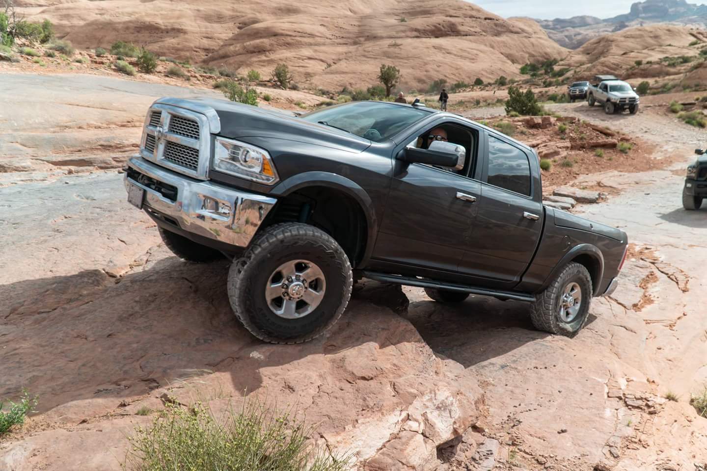

Just as a follow up. I took my truck through Moab with this install and my articulation was just fine with 0 PSI. I'm not even sure i ever hit the internal jounce or if I did it was muuuch softer and not jarring at all. I do have boogie bump stops in front.
									2016 Granite Crystal Metallic Power Wagon Laramie, graphics delete, debadged, Thuren front and rear coils, Thuren rear swaybar links, Thuren front and rear trackbars, Traxada rear 1 inch spacers, King 3.0 (Stage 4) front and 2.5 (Stage 3) rear shocks, Boogie front bump stops, Cooper STT Pro 37x13.50R17 on XD Machette 17x9 +18 wheels, Centramatics, 5.13 gears, DOR steering brace, Thuren truss, Thuren King Steering Damper, Synergy Steering Kit, Thuren PW front bumper, Thuren rear bumper, White Knuckle rock sliders, Dethloff skid plate, Dethloff rear sway bar spacers, Purple Cranium Half Spider front and rear diff guards, Airlift 5000 Ultimate airbags with Daystar cradles, Bakflip Revolver X2 tonneau, Factor55 Ultrahook with 100ft 7/16 A.R.E. Spidersilk synthetic winch line, Zroadz Grill with slim 20 inch light bar, DDM Tuning LEDs/HIDs, Rigid Side Shooter ditch lights,  KC rock lights, Rigid fog lights, Baja Designs rear lights,  Magnaflow 19200 modified with upgraded resonator and after axle dump, tinted front windows 35%.
