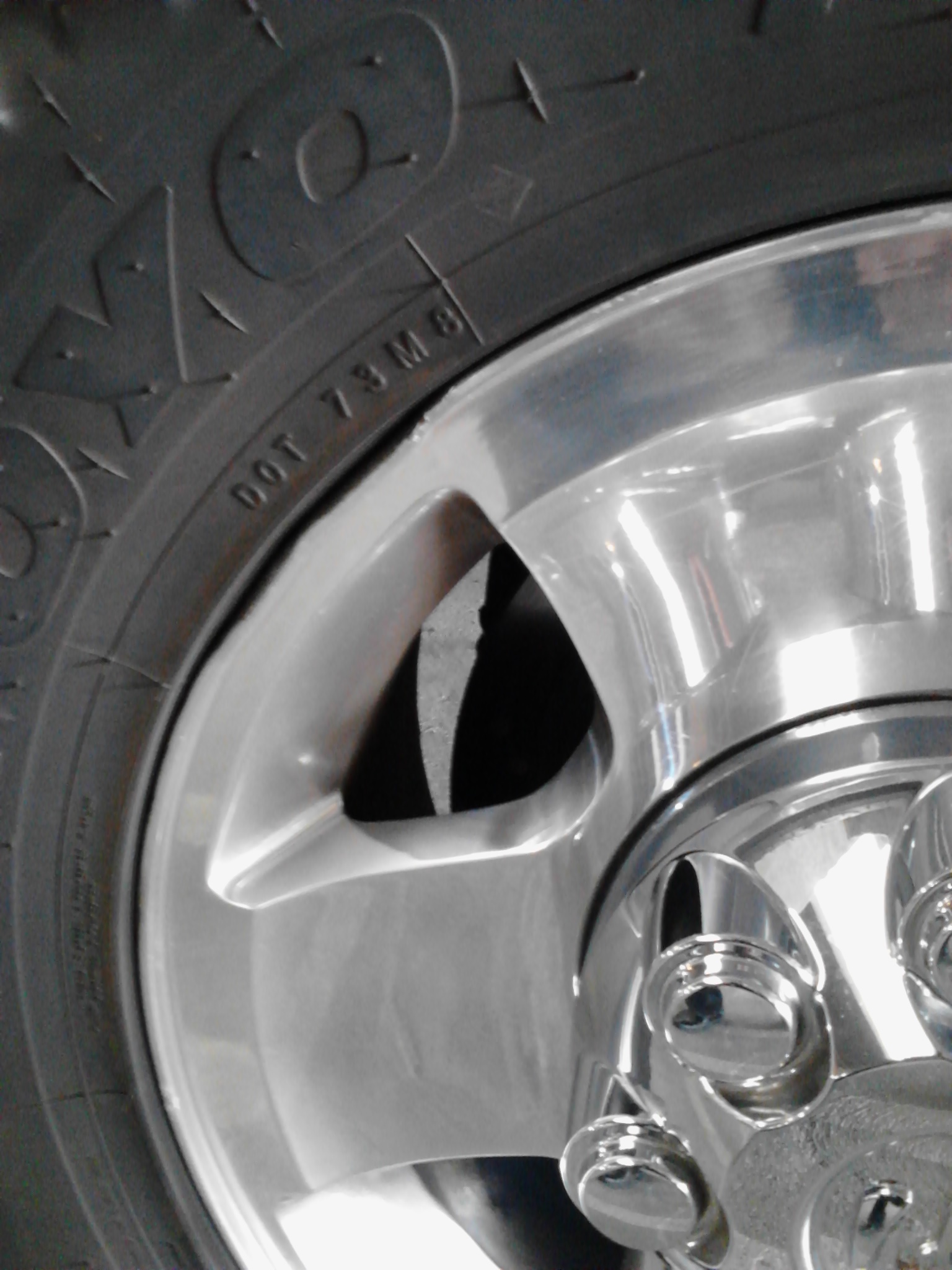

Here is a '16 forged PW wheel. I sold the wheels...for cash money...because the offset is too narrow for larger tires.

Reloaderguy wrote: A little trimming and they fit just fine.
KMC XD128 17x9 +18mm Offset. Toyo RT 37x12.5x17
Re: Wheels: OEM vs Aftermarket
That lip looks identical to the one on my cheapo wheels. Unless I'm missing more details of what makes the PW wheels specisl
