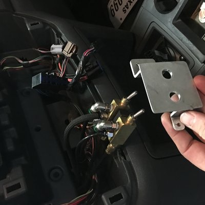

Got the rear cross member notched for clearance at full droop and limit strap tabs burned on. Fire extinguisher mounts made up for the front seats too. Bumpers are getting powder coated today and got the switch plate for the ARB air toggles tacked up.

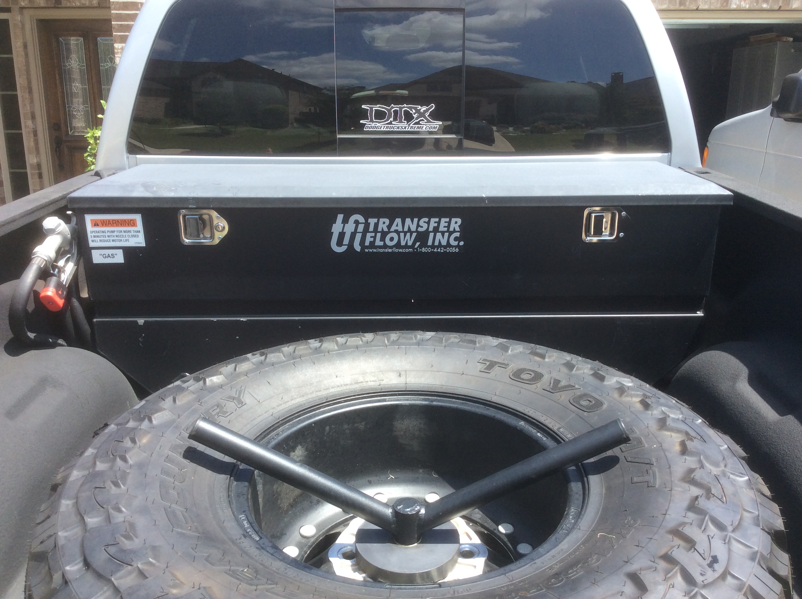

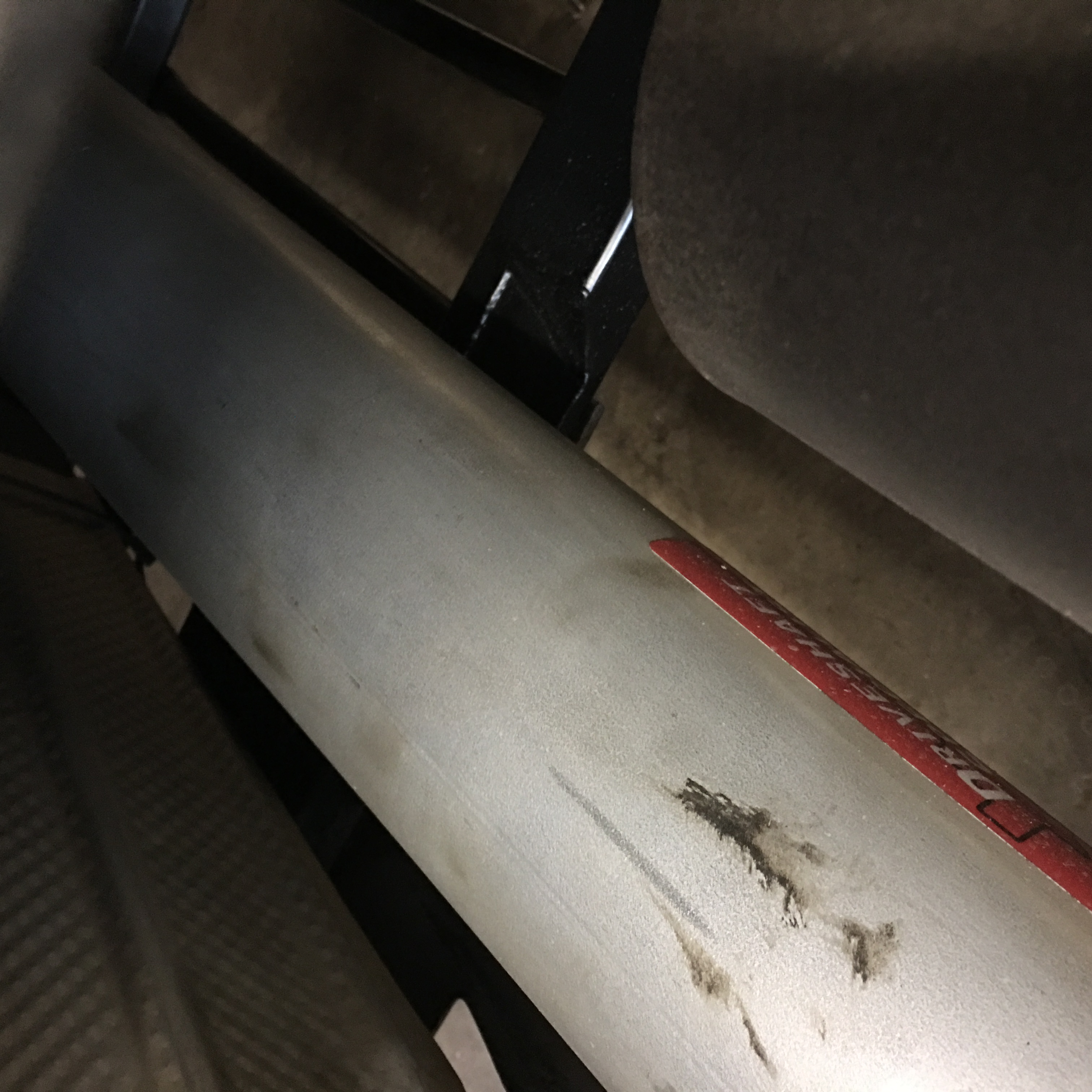

Got the gooseneck and front driveshaft hoop done this weekend, probably going to put the bed back on tomorrow.

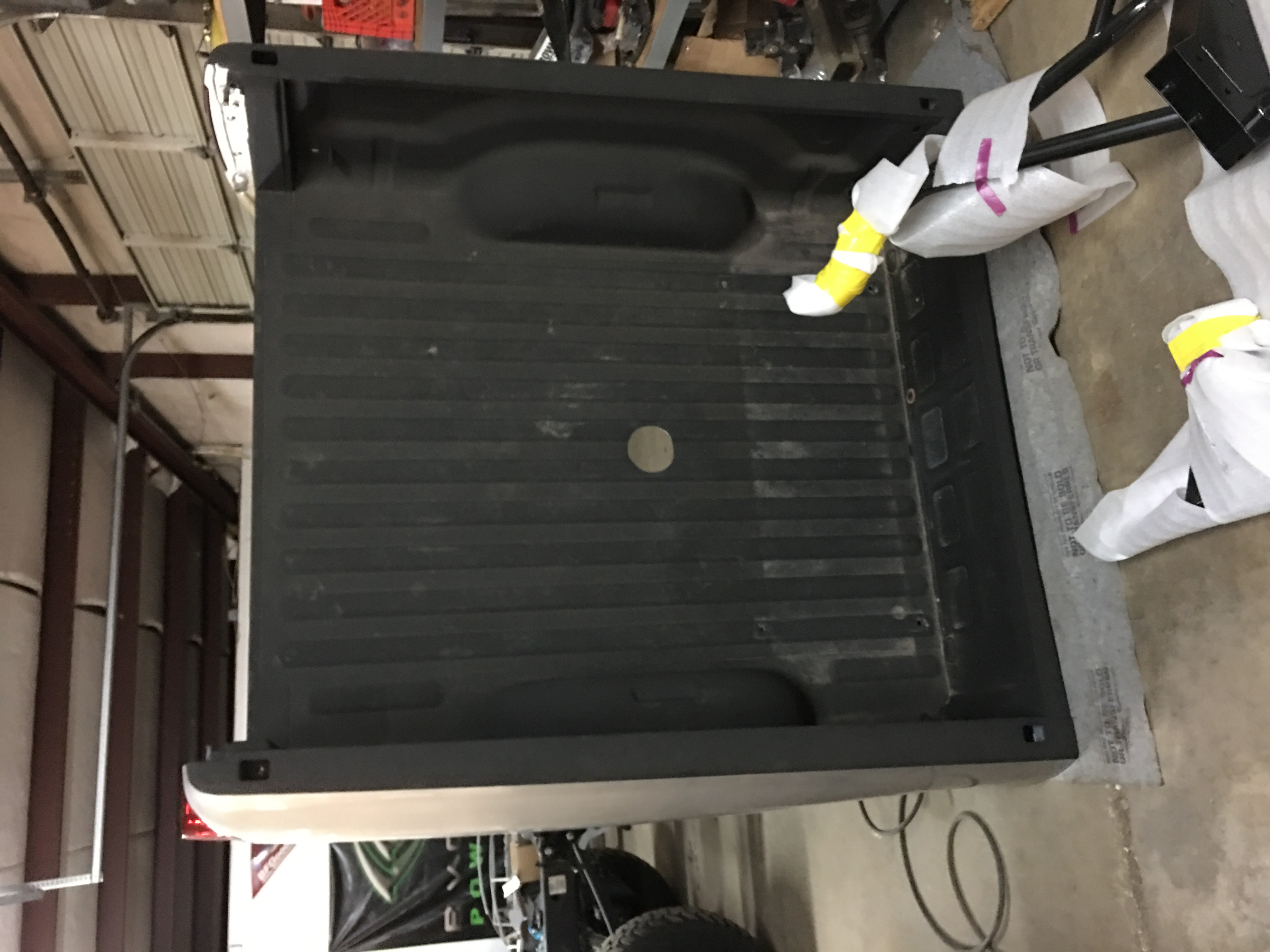

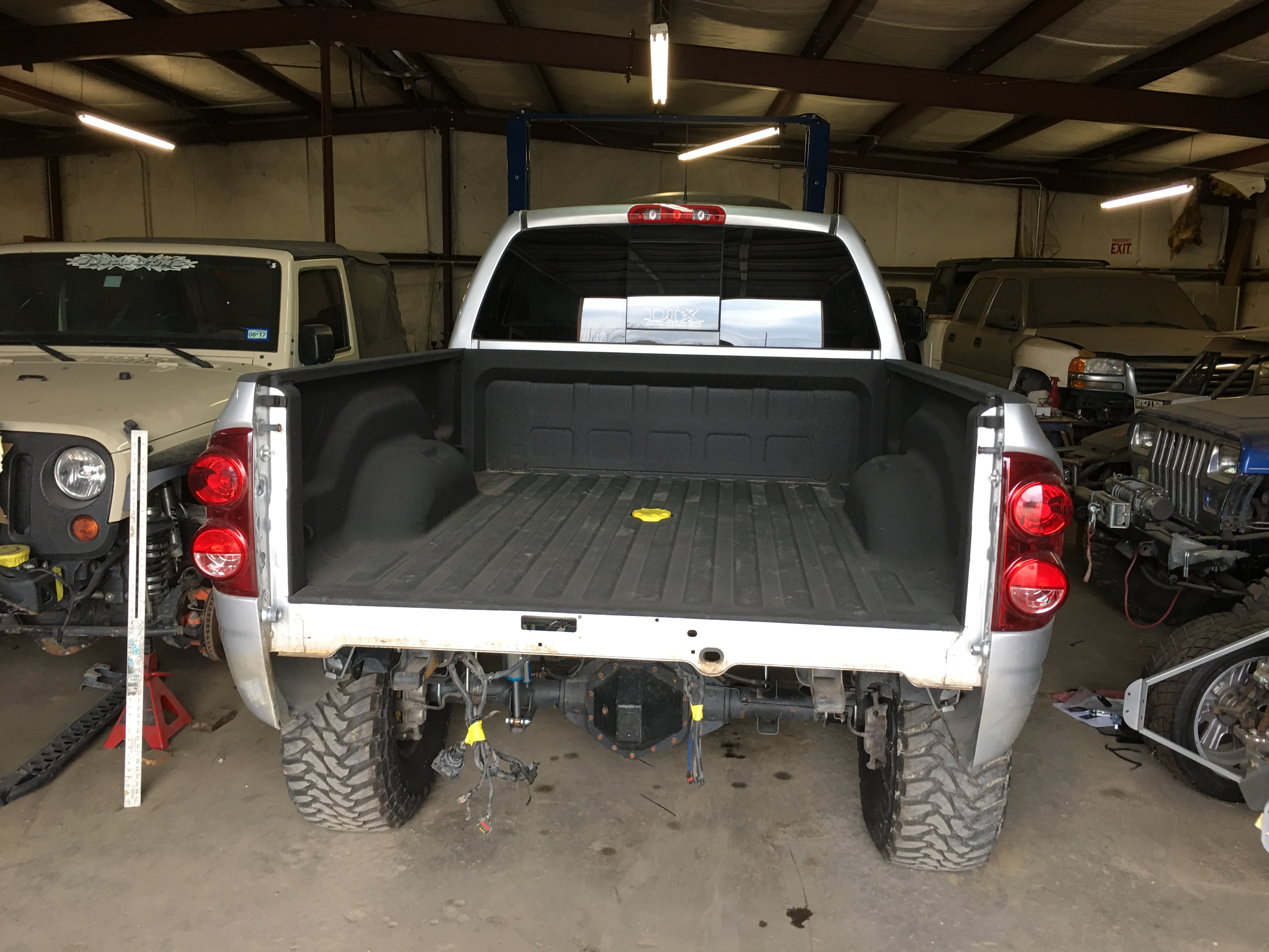

Getting the bed ready to put back on! Had to cut for the gooseneck and notch the bed cross members for clearance on the bypass shocks. Normally they're installed upside down but I wanted the shock body up out of the rocks.
Re: Boogie wagon take 2
Let me know how it fits with the by pass shocks!! That's one of the things holding me back from those shocks. The upsidedown piggy backs too. Don't like the idea of the body on the bottom. Especially on all the gravel roads. Looking forward to installed pics!!! Looking great!
Thank you sir! Beds on and everything appears to have plenty of clearance. I'll get some under bed shots once it's in place and bolted down. Still have to make some support brackets tied to the frame for the rear transferflow toolbox/tank mounts.

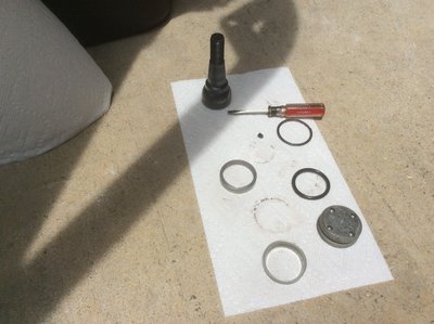

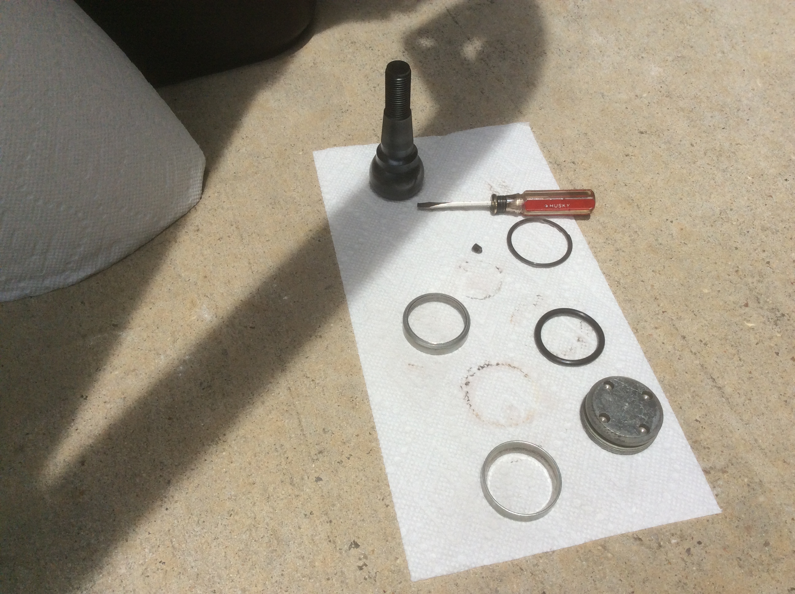

Been a while since an update as I've been busy with other things, but finally getting around to doing some maintenance on the wagon. Repacking the front hubs with NEO synthetic HP800 and changing out the grease in my EMF rod ends to use the same redline cv2 as the carli ball joints.
Disassembled each joint and cleaned out old grease, then cleaned and reinstalled everything with fresh redline cv2. Now I can use 1 grease gun for the whole truck. Takes about 5-10 minutes working at an easy pace per rod end. Very well made stuff. Go Canada eh!

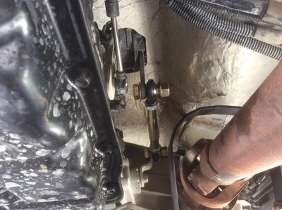

Just swapped trasfercase shifter linkage for custom coolguy unit lol

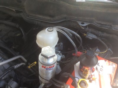

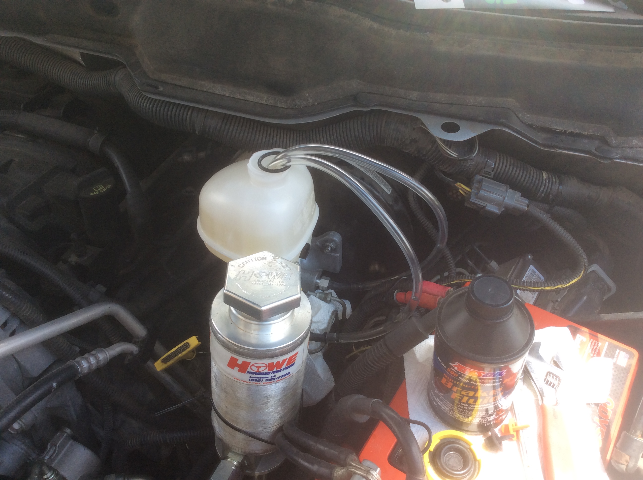

Changed out my master cylinder today, I was able to "bench bleed" it on the truck with a handy dandy kit I picked up on amazon. Took about 30 minutes to swap it and bleed everything. Pedal feels great now.

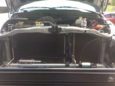

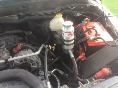

Also I don't think I ever posted pics of the swaybar module bracket or steering reservoir so here they are.

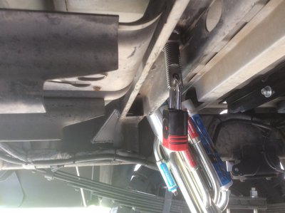

Got to do a little to the truck today, finally got around to making the strapt tire carrier lockable and swapped all the different locks on the truck for BOLT locks that are keyed to the trucks ignition key. Got rid of several keys and simplified.

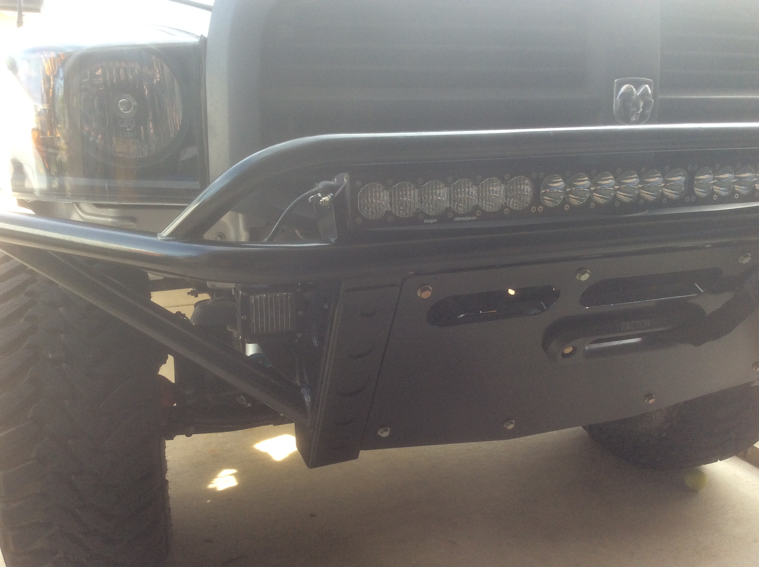

interesting switch from BD to Rigid, some might call you a blasphemer! Who made your front frame horns?
interesting switch from BD to Rigid, some might call you a blasphemer! Who made your front frame horns?Re: Boogie wagon take 2
DamageWagon wrote:Tim if I ever liked a third gen, yours would be my favoriteinteresting switch from BD to Rigid, some might call you a blasphemer! Who made your front frame horns?
Thanks man! It is blasphemy, but it's in the name of science lol. The bd lights are so damn bright I can't use them on the street. These d2's are street legal so I'm wanting to try them around other traffic and see if they won't blind oncoming drivers.
The frame horns are from pattonfab, they tuck in further than anything else I've seen. I had to trim a little of my winch cradle to get it even with his horns. Approach angle is vastly improved from stock.

Colibri wrote:Just swapped trasfercase shifter linkage for custom coolguy unit lol
Where did you purchase the "custom coolguy unit" ? Or did you make it yourself ?
