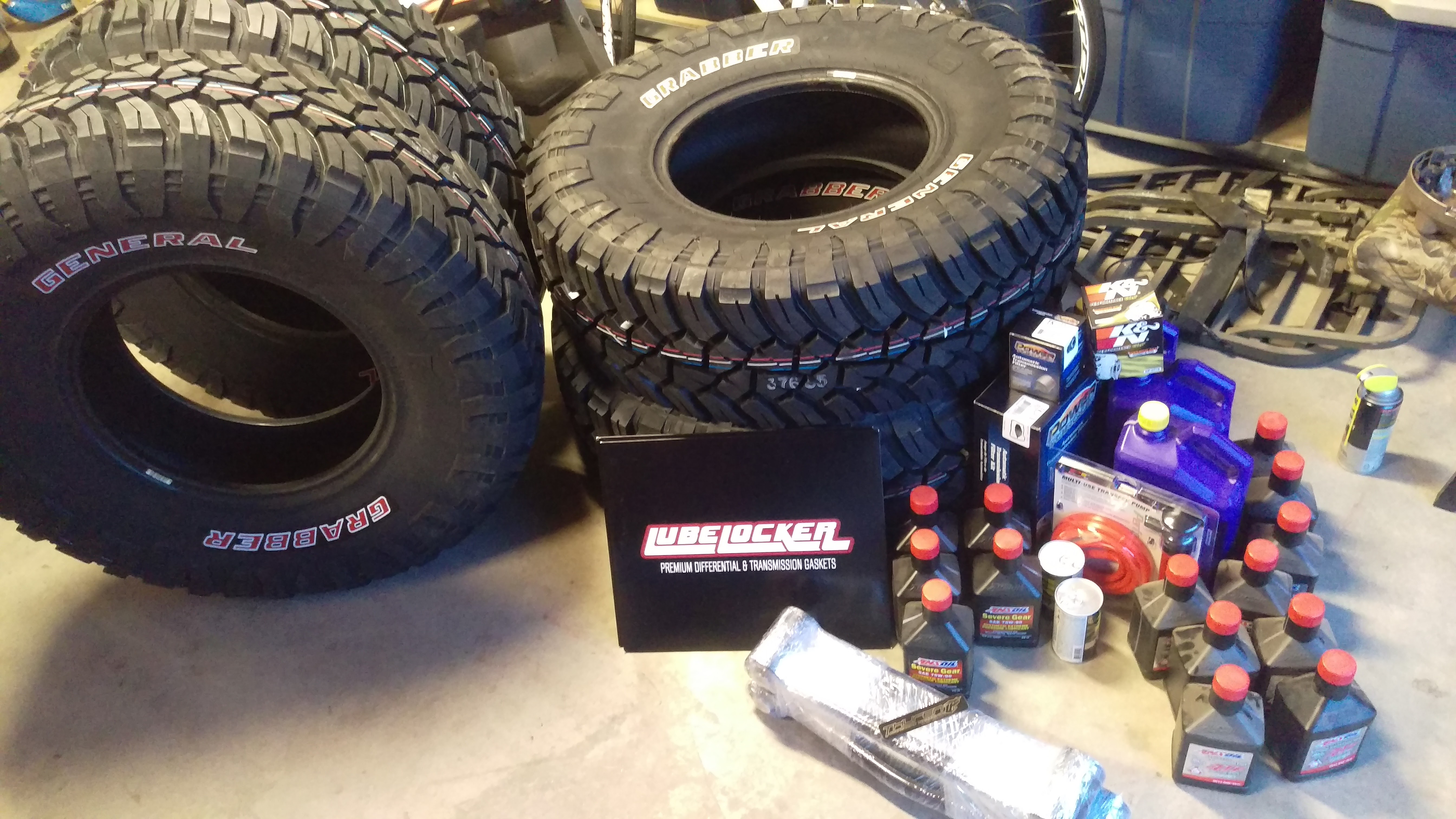

So last weekend was spent doing my wheel hubs, this weekend will be for upgrades.
General Grabber X3---37x12.5r17.
Thuren high clearance control arms.
and changing all the fluids aswell, oil, transmission, transfer case, and diffs.
I'll post before and after photos of the arms and tires once finished.

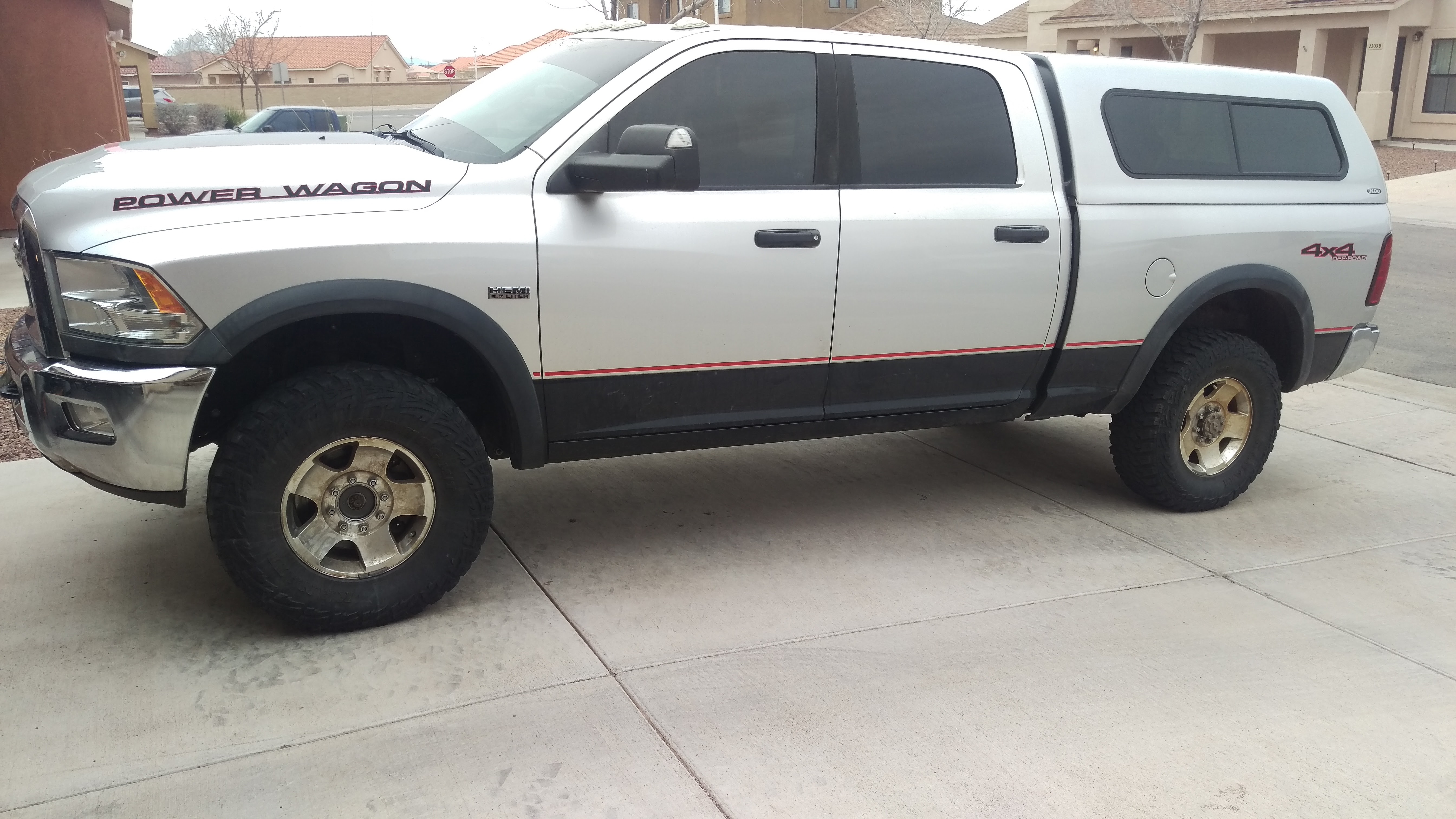

So I got the X3s on the truck finally. My wallet was raped in the process! Since the auto hobby shop's tire machines were down I had to have them mounted and balanced in town. Because I did not buy from any of the retailers in town, I got the privilege to pay the premium, full price for their services. The only place in town here that was willing to mount and balance 37's was discount Tire. All the other places said their machines could only do 33's and a few said 35's. I even asked if they could just unmount the old tires and mount the new ones and I would balance them later, and no takers on that. So $200 dollars later, my truck has new shoes on. I did pay for the lifetime balance, rotation, repair, which is extra if you didn't buy the tires from them. So saving a couple bucks on the tires cost me in the end. Again, only because the machines at the auto hobby shop were down.
Before:
After:
The only rubbing I have is a slight rub on the upper arm at full lock, and some on the swaybar at full lock. If you look at the photos, my front bumper is a little bent in/up on the ends. Sliding down slick mud into a dirt wall is a sure way to stuff your bumper a little! When I hit speed bumps at normal speed, the tires rub the plastic at the bottom of the bumper. Once I pull my bumper out some, I should have no problem.
Having the tires on only a few hours now, one thing I can say is they are a lot quieter than my old tires. I can actually hear cars pass me on the road vs before I just heard the hum of my tires. I can listen to the radio at a lower volume!! I'll provide some feedback once I get off-road and run them through their paces.

Post by Colibri » Mon Feb 06, 2017 10:43 pm
That looks fantastic man!
Re: New control arms and tires!!
Post by olyelr » Mon Feb 06, 2017 10:59 pm
Yea i never cared for the dang red letters on some of the generals, but have to admit they fit your truck well with all the other red doodads. Looks good!

So I finally got around to pulling my bumper out to help clear the tires. I used a tractor trailer cargo strap and hooked it to by buddies rear steal bumper. We tried to ratchet it but it was too hard to get it to where I wanted it. I ended up just putting it in 4 low, put the truck in reverse and slowly eased off the brake. I didn't want to apply any gas if I didn't have to, as I didn't want to bend the bumper too much. Turns out that letting the truck in 4 low reverse as much as it could while idling was just perfect.
Here is the truck now.
You can see the added space between the front bumper and the tires.
I'd post the before picture from earlier in the post, but my laptop died on me 2 weekends ago. Using my work computer at the moment.
Figured it out!
Also, the X3 perform amazingly, at least in the snow. I went up this last weekend with a jeep wrangler, ram 1500 eco diesel, and a Toyota 4runner. I watched how all of them were sliding in the snow as the PW just plowed through like a knife through butter. Granted I have a couple K on them weight wise and brand new tread. I had to pull each one out once and the other ram kept getting stuck in the deep snow(x3). The Jeep owner want a PW now! Having pulled 7 people out of the snow in since the beginning of the year, there are a few people here (NM) that appreciate the PW abilities!
Each time we stopped I did notice that the other vehicles tires were always full of snow in the tread. The X3 do a fantastic job of shedding the snow. Each stop my tires had almost no snow in the tread!
I'm going to be buying a portable air compressor soon, so after that Ill be able to comment on how the tires do under lower PSI. I ran the trail at 30 fronts and 22 rear.
After driving on the tires at 30 PSI front and 22 PSI rear, I have changed my pressures to 40 front and 35 rear. Much better ride on pavement.
