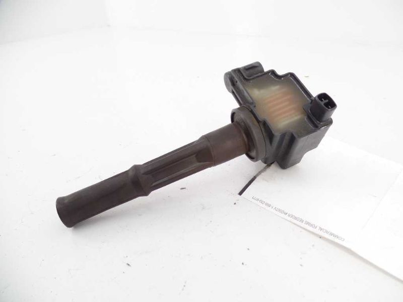

After doing some research, I discovered that the electrical connector for the transfer case position sensor is identical to the electrical connector used on many mid 90's Toyota cars as well as some mid 2000's Chrysler ignition coils and intake manifold runner solenoids. So I ventured out to my local pick-a-part wrecking yard and sure enough, I found one on a mid 90's Toyota Tercel. I removed the ignition coil and enough of the harness to serve my purpose.
Look Familiar?

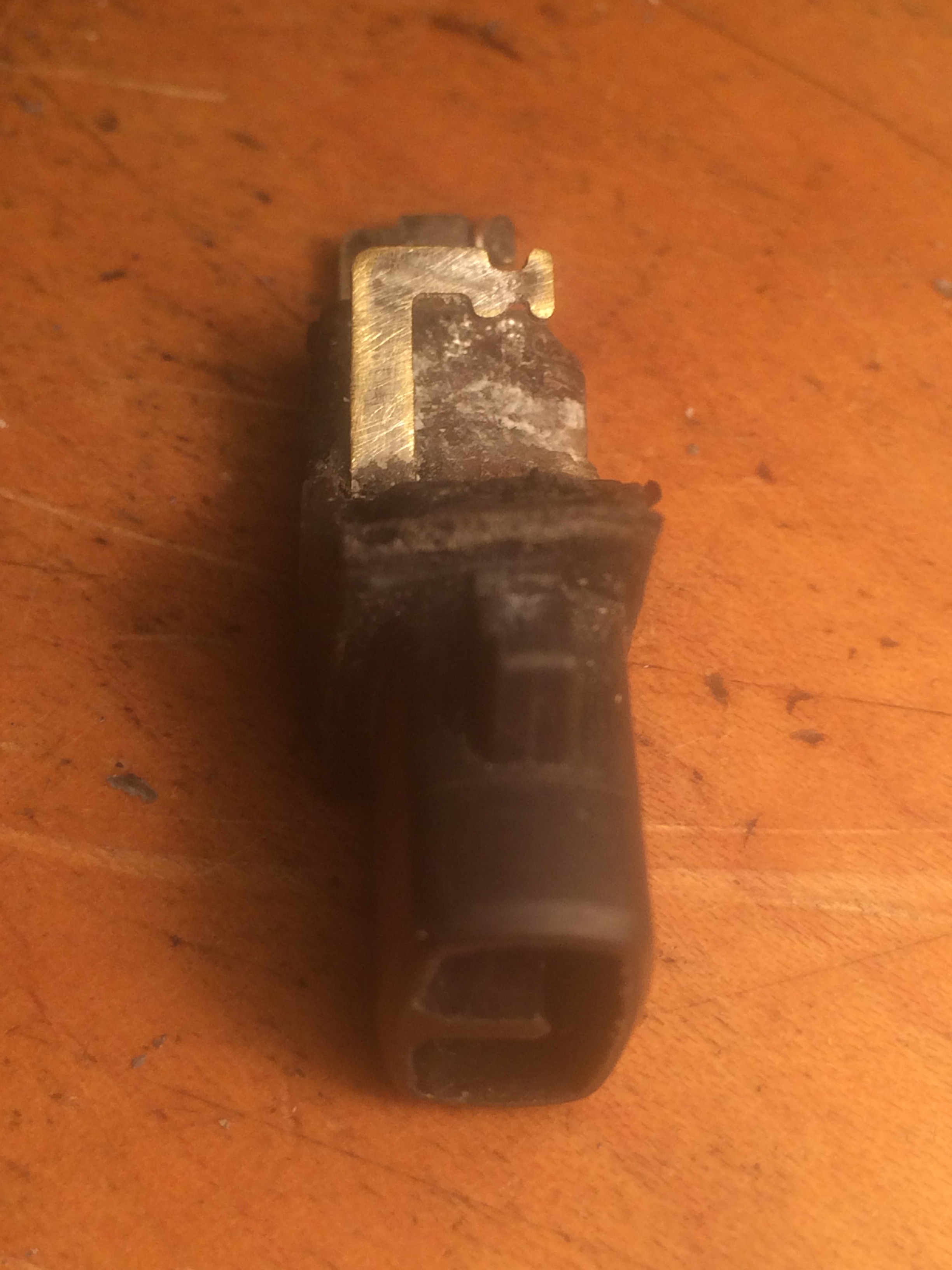

Then I mounted the coil in my vise and began to carefully cut out the connector
This is what the coil looked like after I cut out the connector.

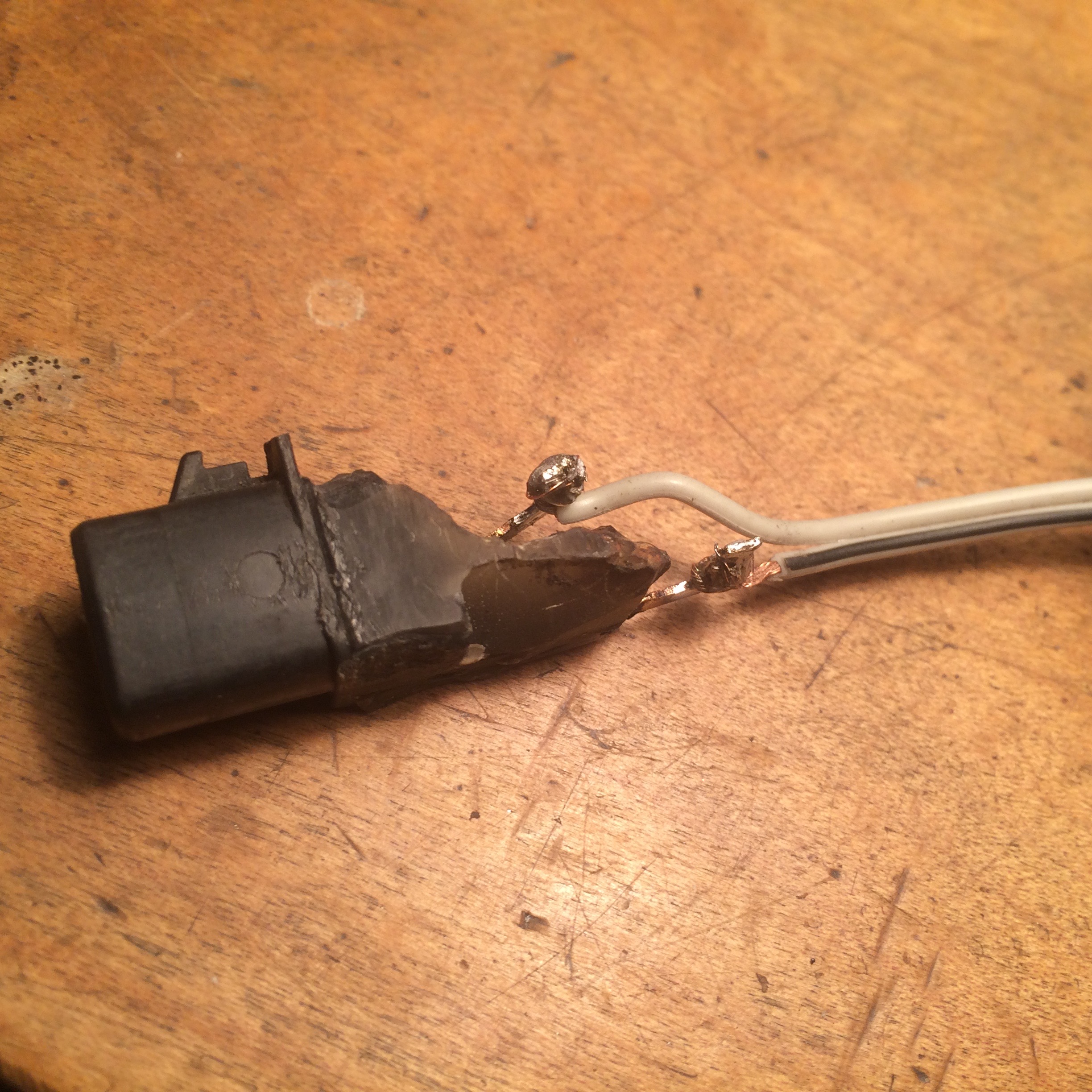

After removing epoxy and plastic by whittling and melting with a small butane torch it exposed the internal terminals.
I then attached my wires to the terminals with solder.
I took a rubber cap I had and punched a hole through for my wires.
I then filled the cap with two part epoxy and pulled the connector down inside to seal it. I figured, if it's good enough for a Denso coil, it's good enough for me.
I routed my wires up through the shifter in the floor and followed the rest of the instructions and wiring diagram found on the PowerWagonRegistry and was finished.
Everything works as it should and I'm very pleased with the results.
I know it's inferior to the new locker bypass systems that are being offered, but it serves my purpose perfectly for my 3rd. gen. application.
In the end I spent less than $20 :D .
