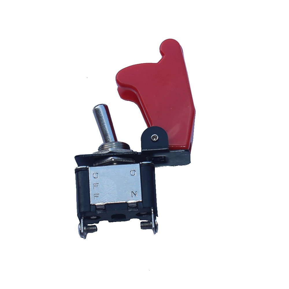

4th gen bypass uses the factory rotary dial.cruz wrote:How 'bout ...
