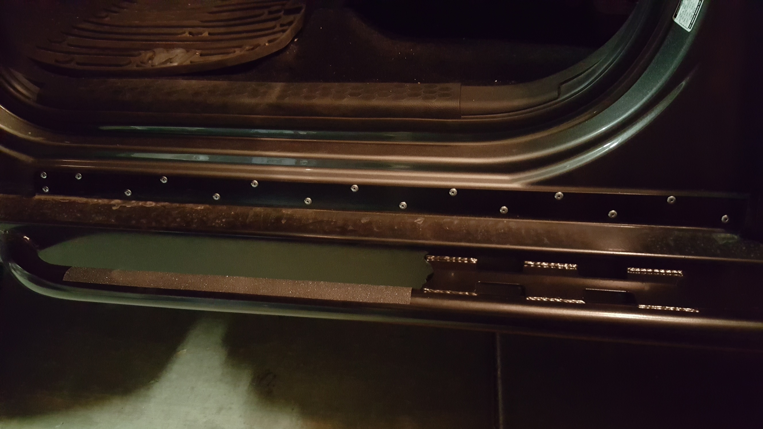

Low_Sky wrote:Of all the body-mount sliders I've seen, Randy Ellis looks to have the best one. I would be concerned about drilling that many holes in the rockers with a design that looks like it would trap water and road salt/grime against all those holes. I think they'd be fine in the Southwest, but I'd be worried about my rockers turning to cheese in Alaska or any other place that gets real winter weather. On a completely subjective note, I don't like his sex-appeal marketing strategy. His home page has a scrolling banner showcasing models with bad double entendres about "bolt-ons" and "headlights". What do boobs have to do with rock sliders?
Agreed, that design would cause rust in a hurry.

RED pricing is nowhere neer low enough to convince me to Swiss-cheese my rockers.

Here's a closeup of the rivets on the inside if anybody was interested. I get it not many people would want to punch holes in their trucks. I wanted to Line-X the rockers before the install but Randy advised against it due to the tolerances between the sliders and the doors. Before, my doors would just swing closed no problem. Now I have to give them a very slight nudge. All in all, I'm happy with them, and feel pretty confident they will hold up to the "hard offroading" best suited to frame mounted rock rails mentioned earlier :poke: :cheers: But in all honesty, it will be a while before I venture out on those types of trails. That's what my Jeeps are for :rockon:
